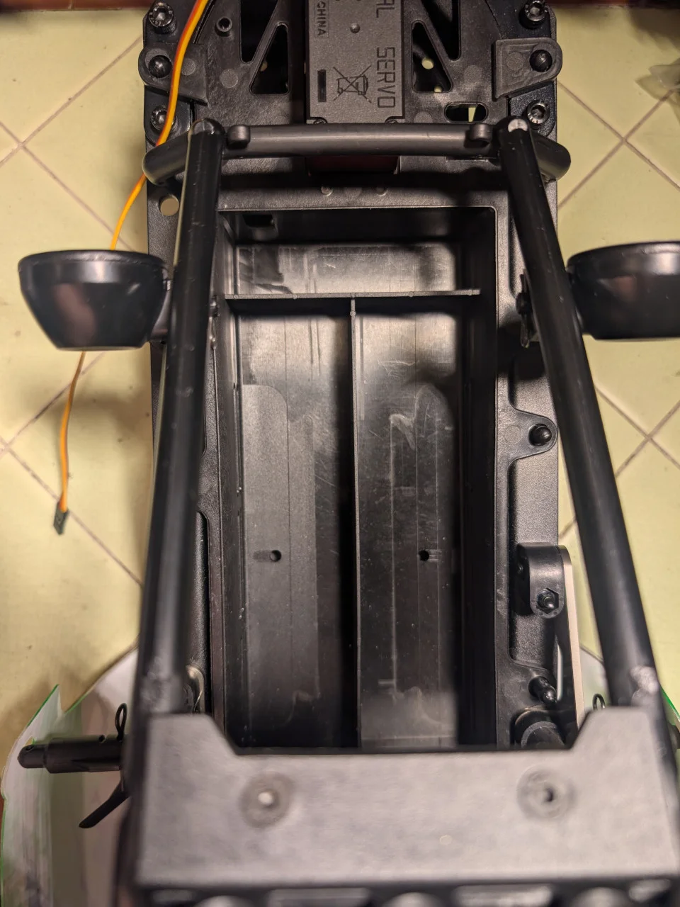

Heathen!From what I can tell the Rovan battery tray is slightly bigger than the HPI one but the cover is clunkier, it uses clevis pins instead of rotating levers to lock it down. In either case the radio compartment is awful, it's part of the battery tray and open at the top with just the battery cover over it. Water can very easily pool in it so I will be NOT using it and instead I will adapt a Traxxas waterproof reciever box instead. I will probably also mill away the useless center divider to free up an extra 1mm of space which is valuable given how tight battery fitment is. I have found that some 6S 5000mah batteries may fit such as Liperior 5000 6s. As well if the dimensions are correct a Liperior 6S 6000mah battery would fit in the tray though the cover would not fit and they would need to be secured with velcro straps (42x60x170mm).
