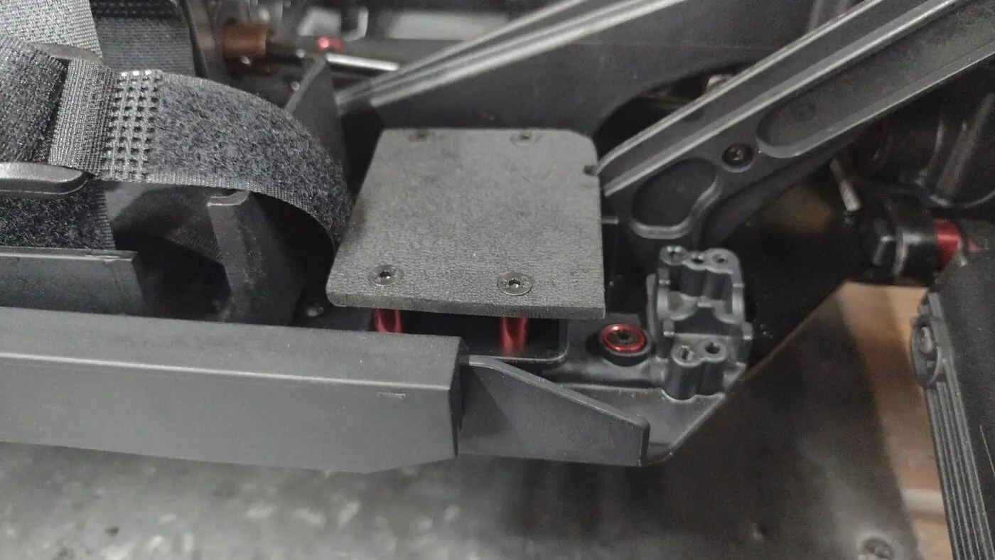

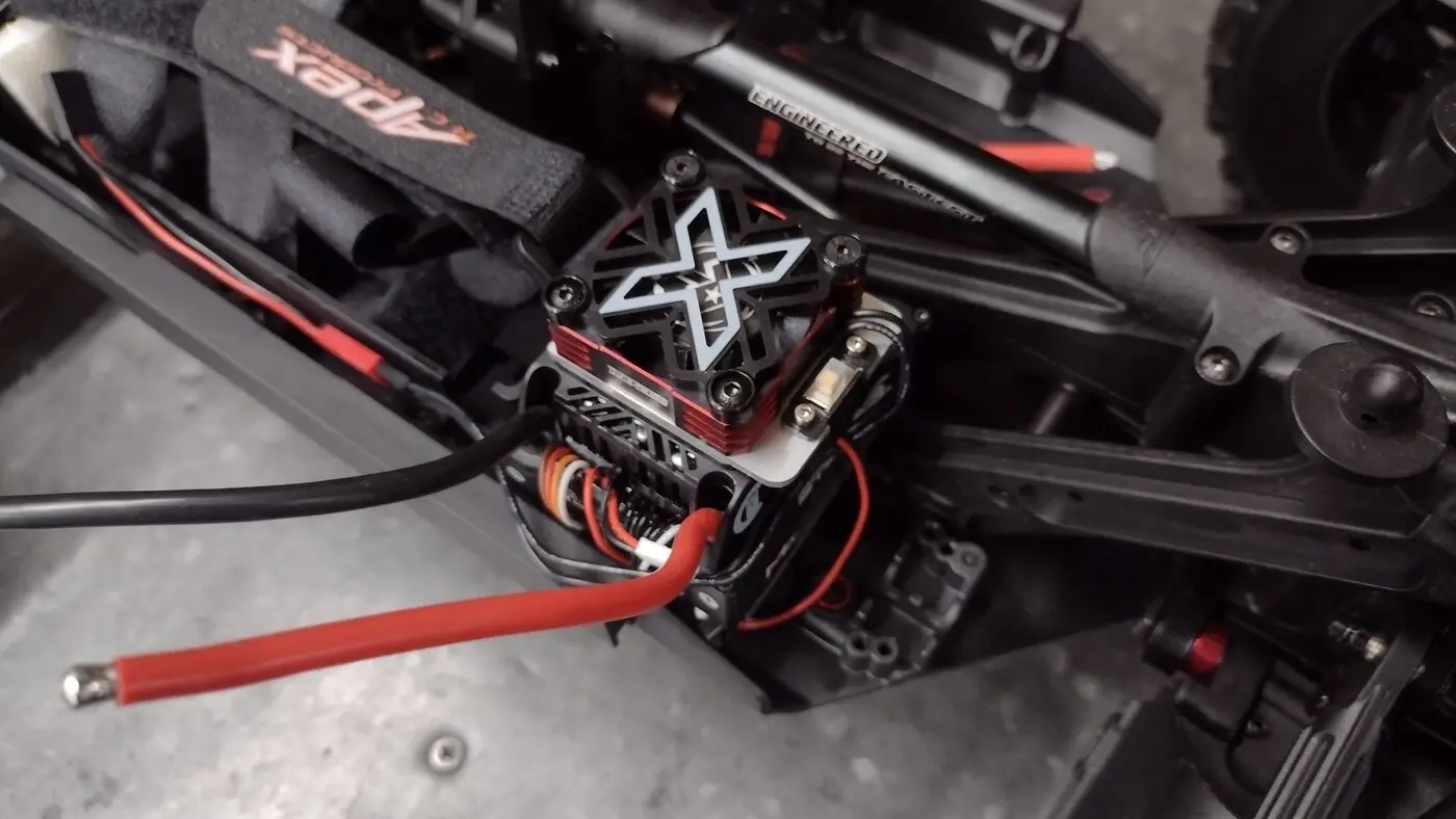

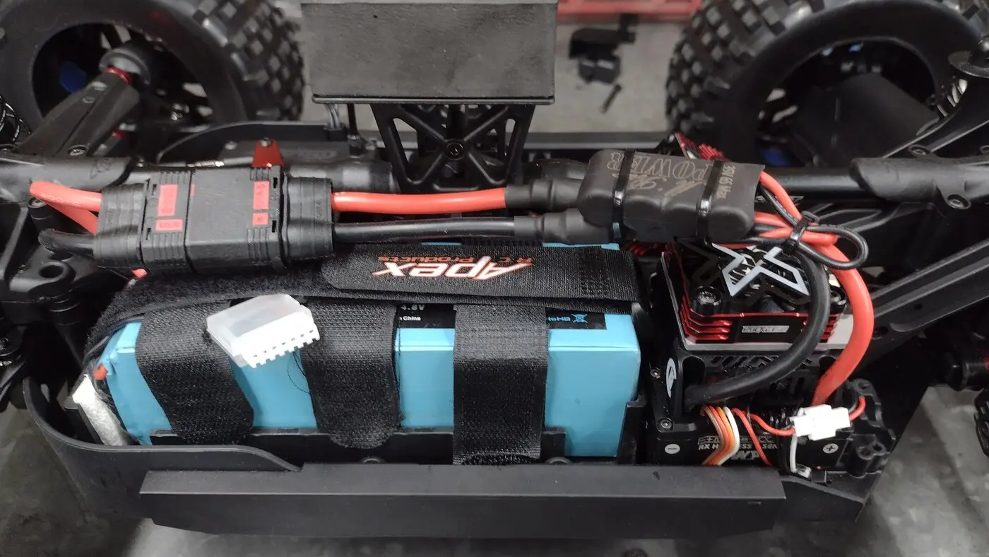

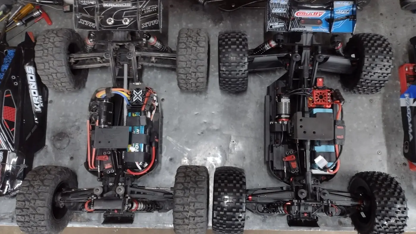

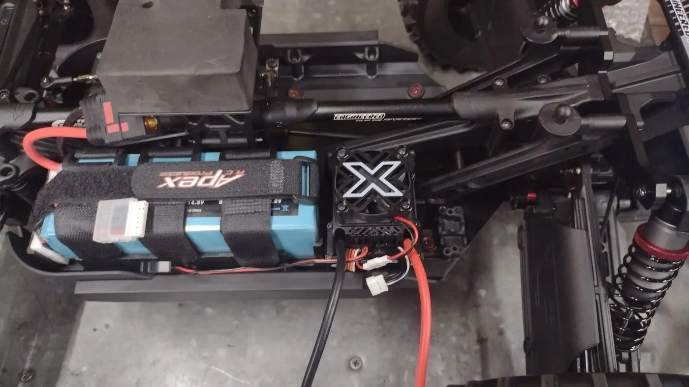

Got my kagama on Monday, finally had a day to sit down with it and look it over, all in all it's a very nice setup, I just tossed my spare corally system in it for now, haven't ran it yet. Things to note, compared to what we're used too they have moved the center diff back giving it more of an equal length driveshaft setup, very nice but it will not fit a 4092 motor without grinding a brace, same goes for the side with the esc, the torox is right up against the brace only leaving the gap between the esc and battery tray, my initial thoughts were to go max6 with a 4092 in 1780 and I still will but it's going to require some work not just drop in, also due to side guards the motor mount has limited adjustment, doubt a 15t pinion will fit without grinding there, it was truly built with corally's system in mind. That's all the farther I've really looked it over, below pic is a side by side with the kronos. I should note these comparisons are based off the kronos considering the kagama is the same class, compared to my asuga it's obvious the kagama is built off that platform as they are very similar
