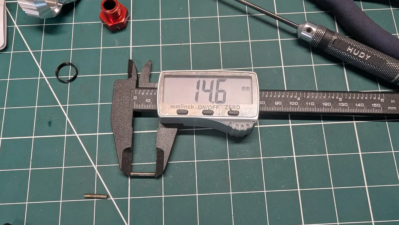

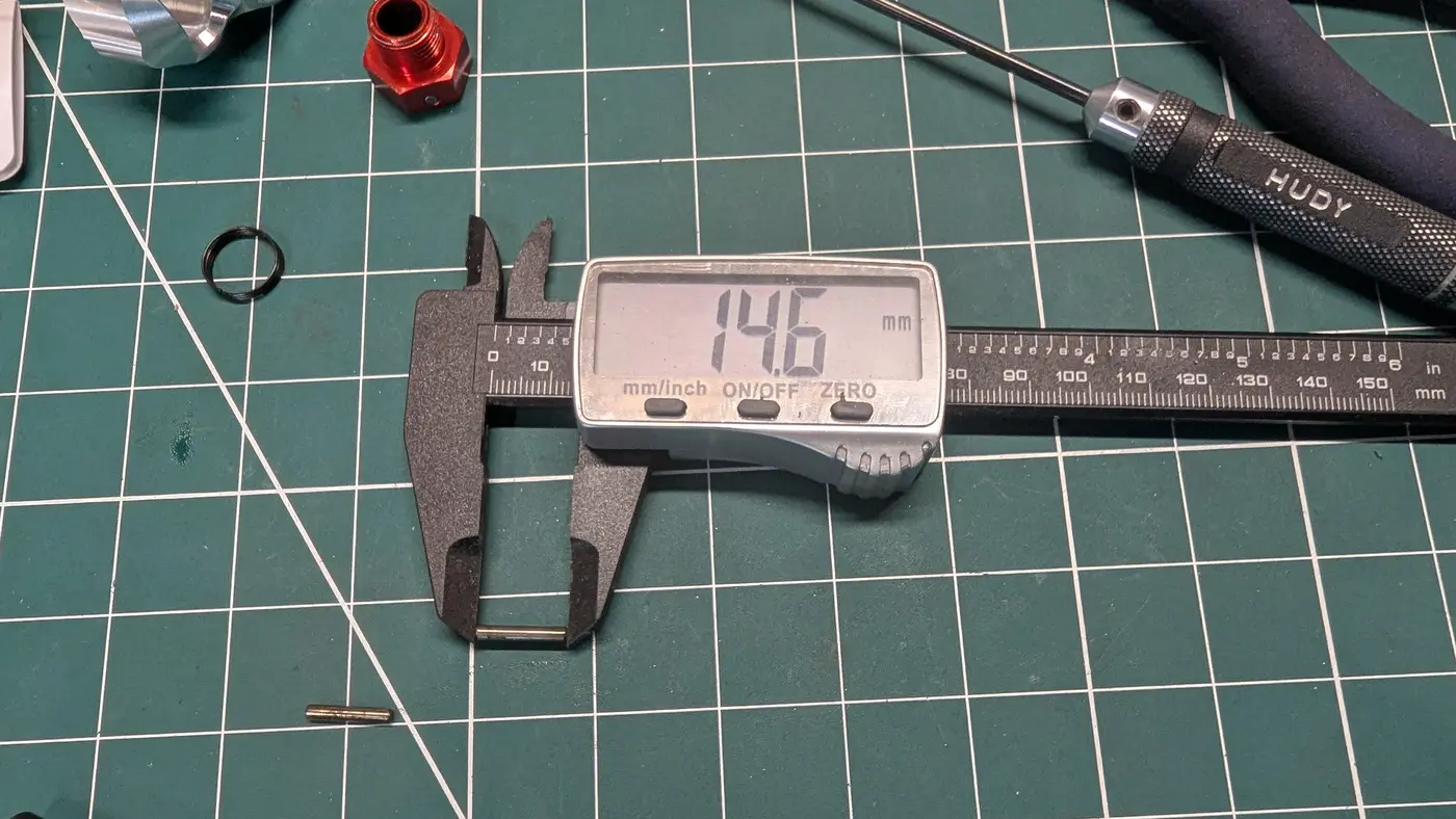

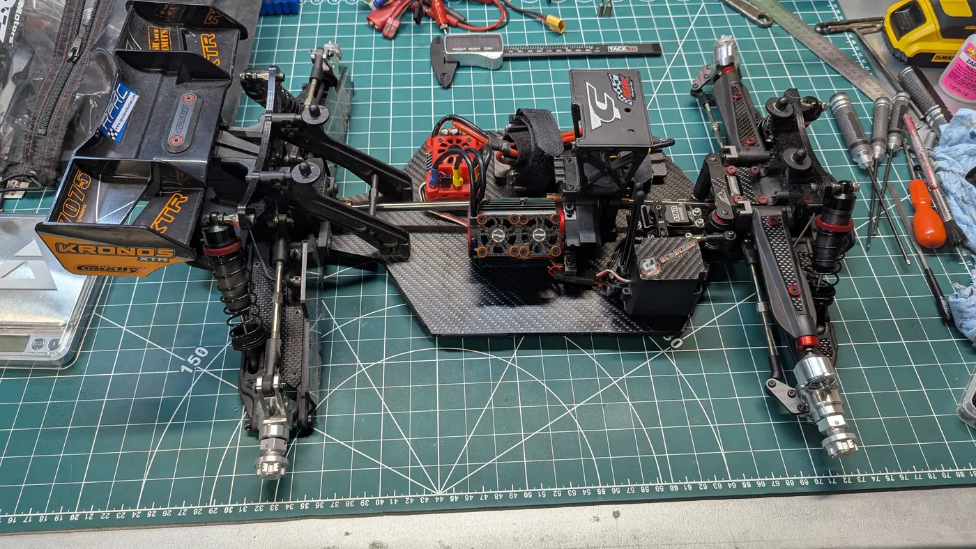

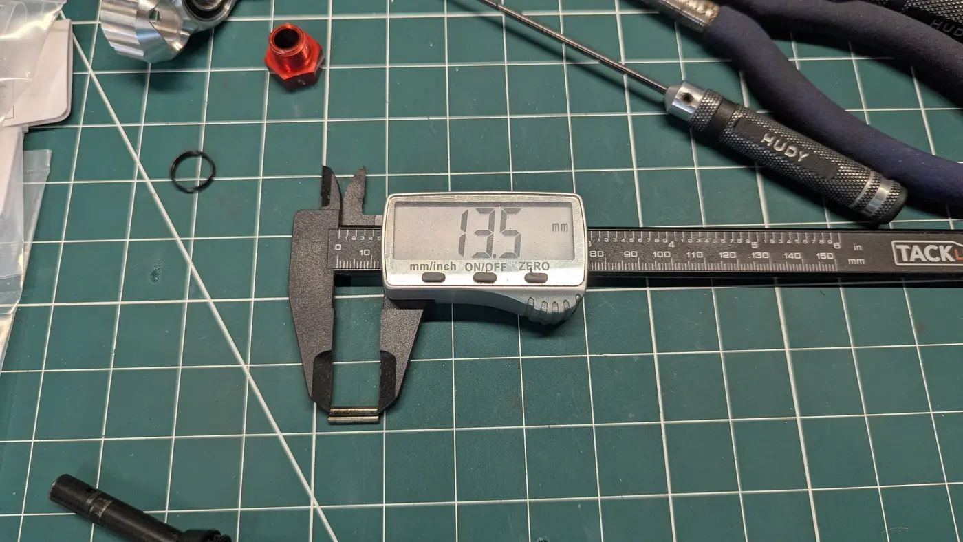

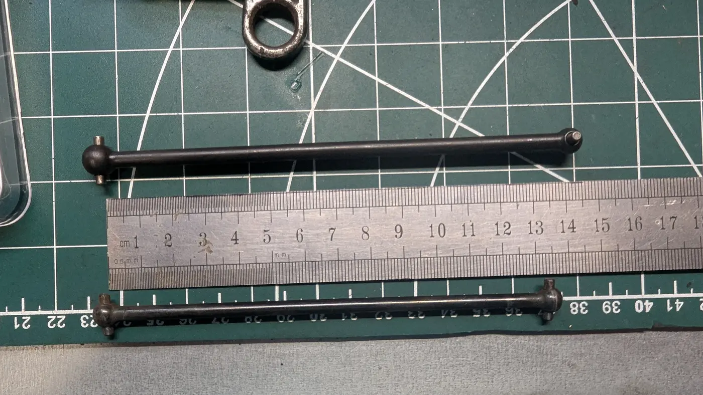

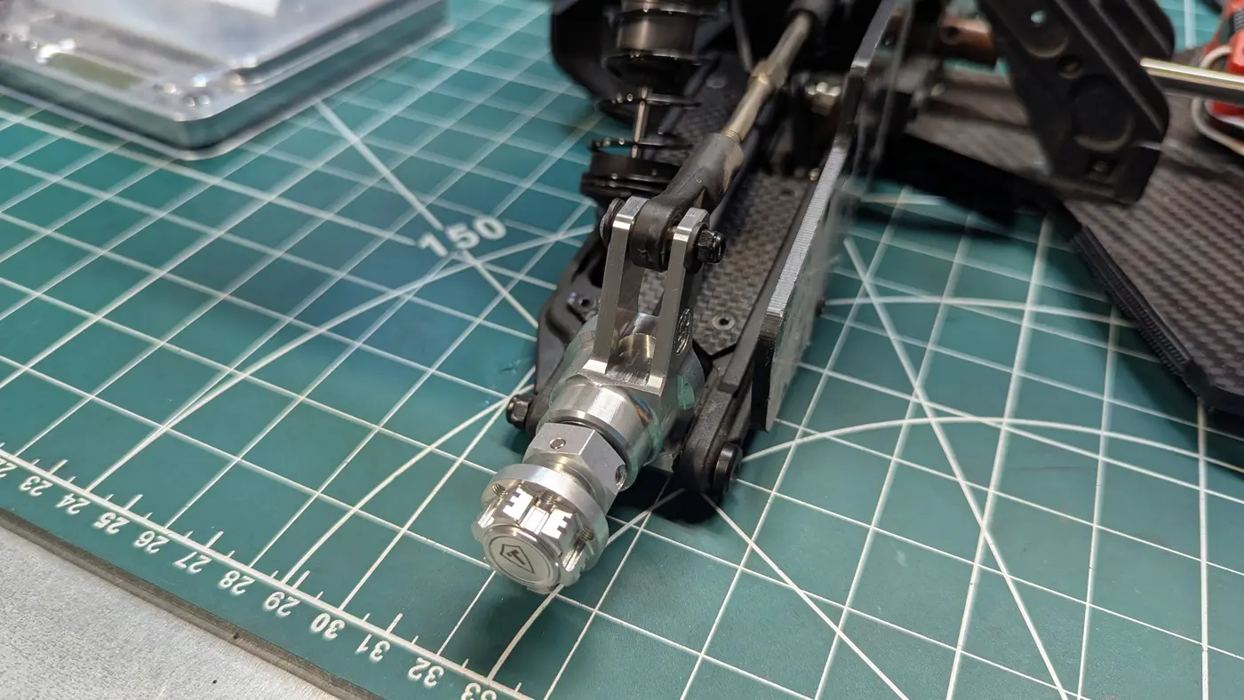

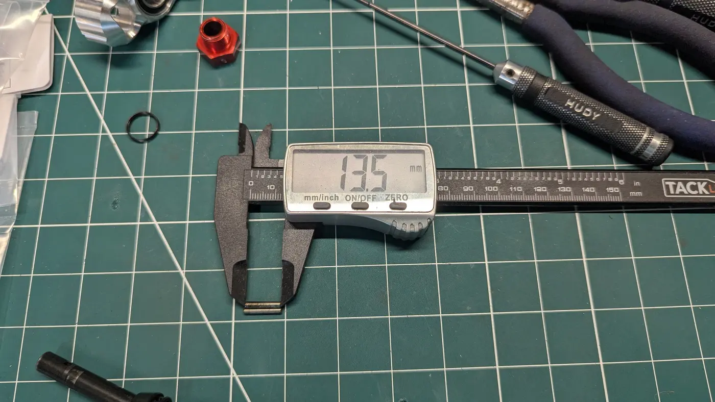

The pins that go through the Corally CVD are shorter that the Arrma pins. This matters, because the pins need to be held in place by the bearing in the hub.
So, once the springs/clips are removed from the Corally driveshafts, the Corally pins can be set aside for a rainy day. The Corally dogbone part of the CVD can then be mated to the Arrma Axle with the Arrma pin from the Arrma CVD - and it's ready to be transplanted into the mutant Corally.

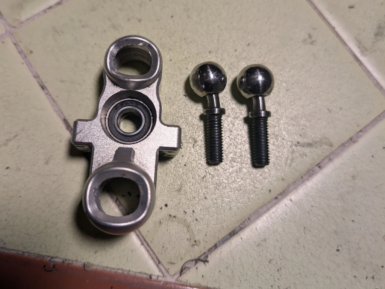

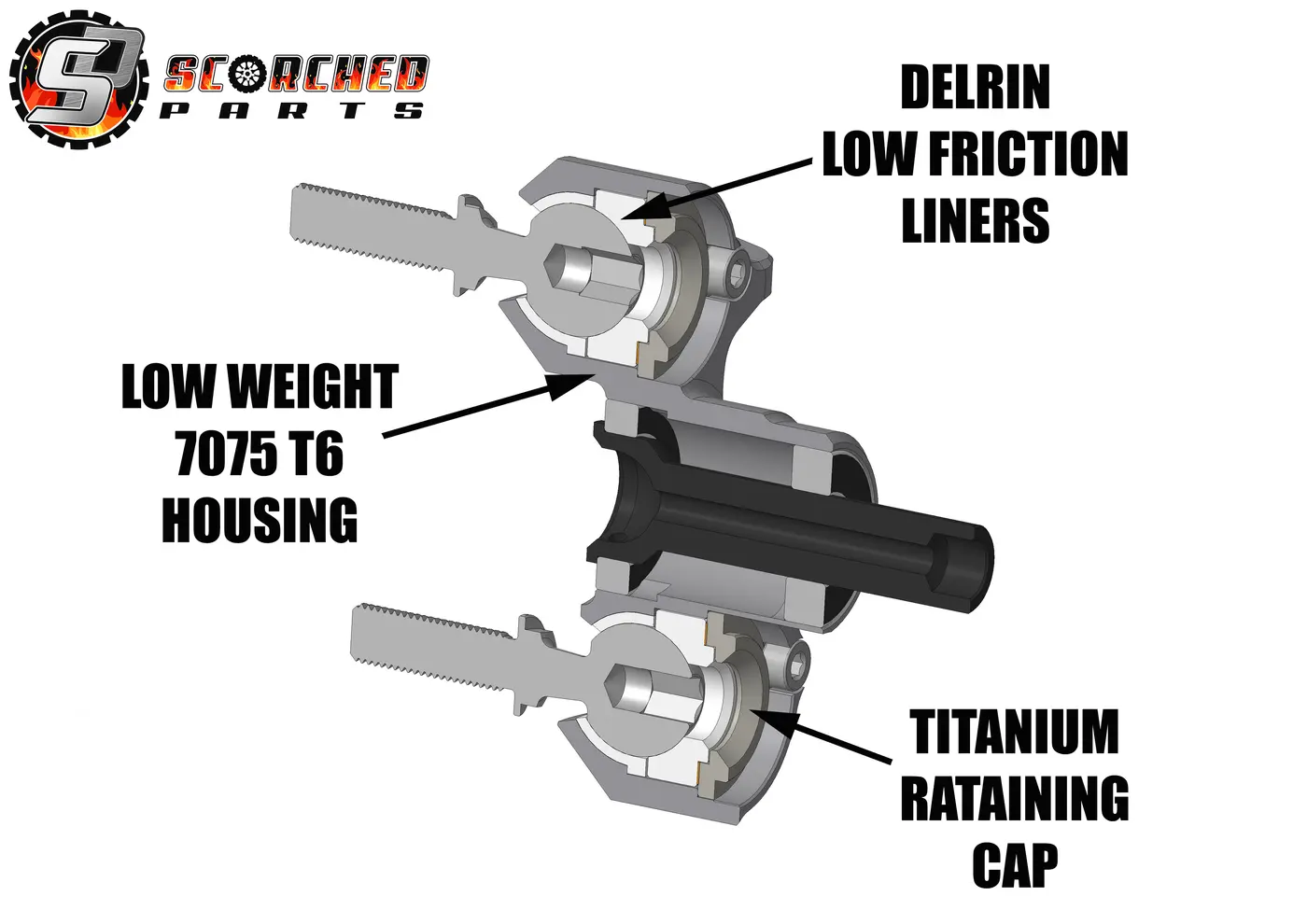

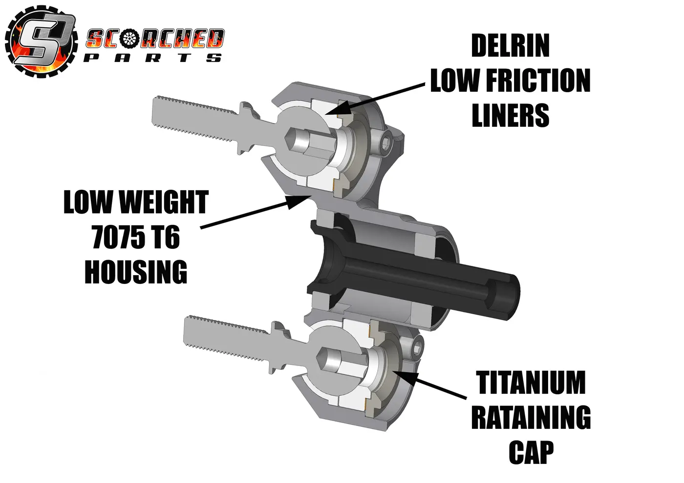

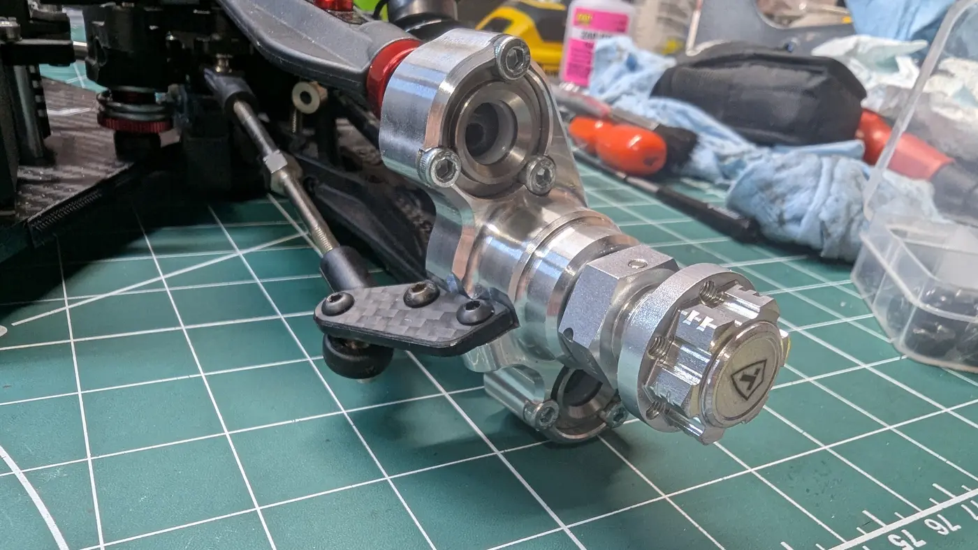

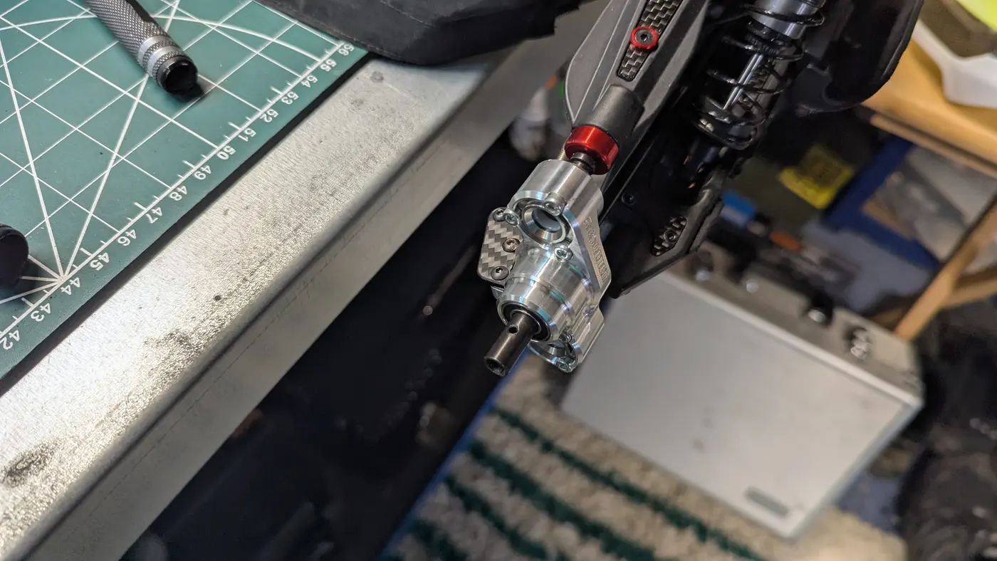

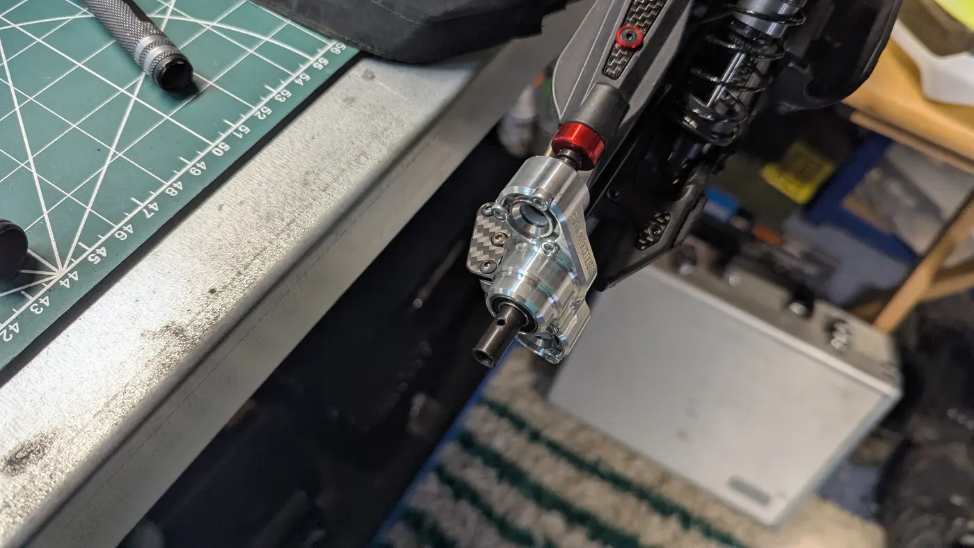

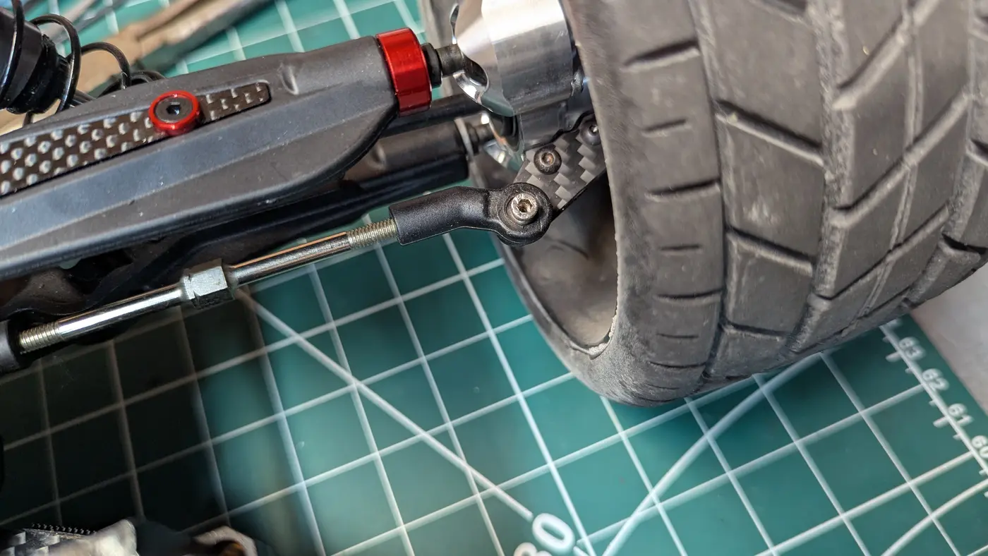

The assembly of the Scorched Parts front hub is a masterclass in quality componentry. It provides 2-part delrin 'lining shells' that encase each pivot ball from both sides. They are held in place by a titanium retaining cap, that are retained by 3 x M3 screws.

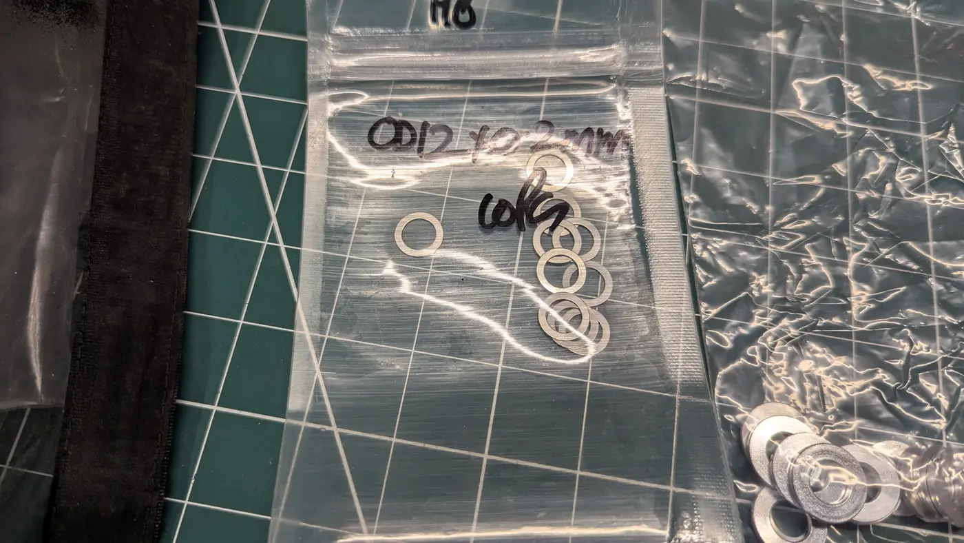

Scorched provide 0.2mm shims to take up any slop that develops. Even though my Corally pivot balls are 0.1 - 0.2mm smaller than Arrma Pivot balls, there is no slop in the new hubs whatsoever - just silky smooth movement. Should play develop over time, shims can be added.
3 advantages:
- No need to remove an alloy plug in nylon thread to adjust pivot balls
- No need to adjust alloy plug in nylon thread to remove slop
- Instant access to pivot balls for geometry changes
Arrma CVDs want to disassemble themselves constantly unless they are happily nestled in the bearing where they live. The moment they are removed, the pins want to eject themselves somewhere you can't find them. Especially when you are in the process of fitting the hub. It's at this point you realise that Corally's spring clips are a bloody good idea!
Watch this space......
