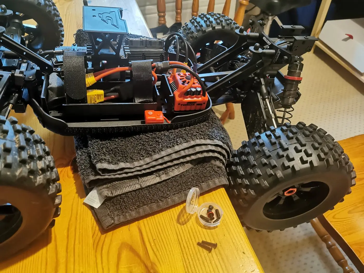

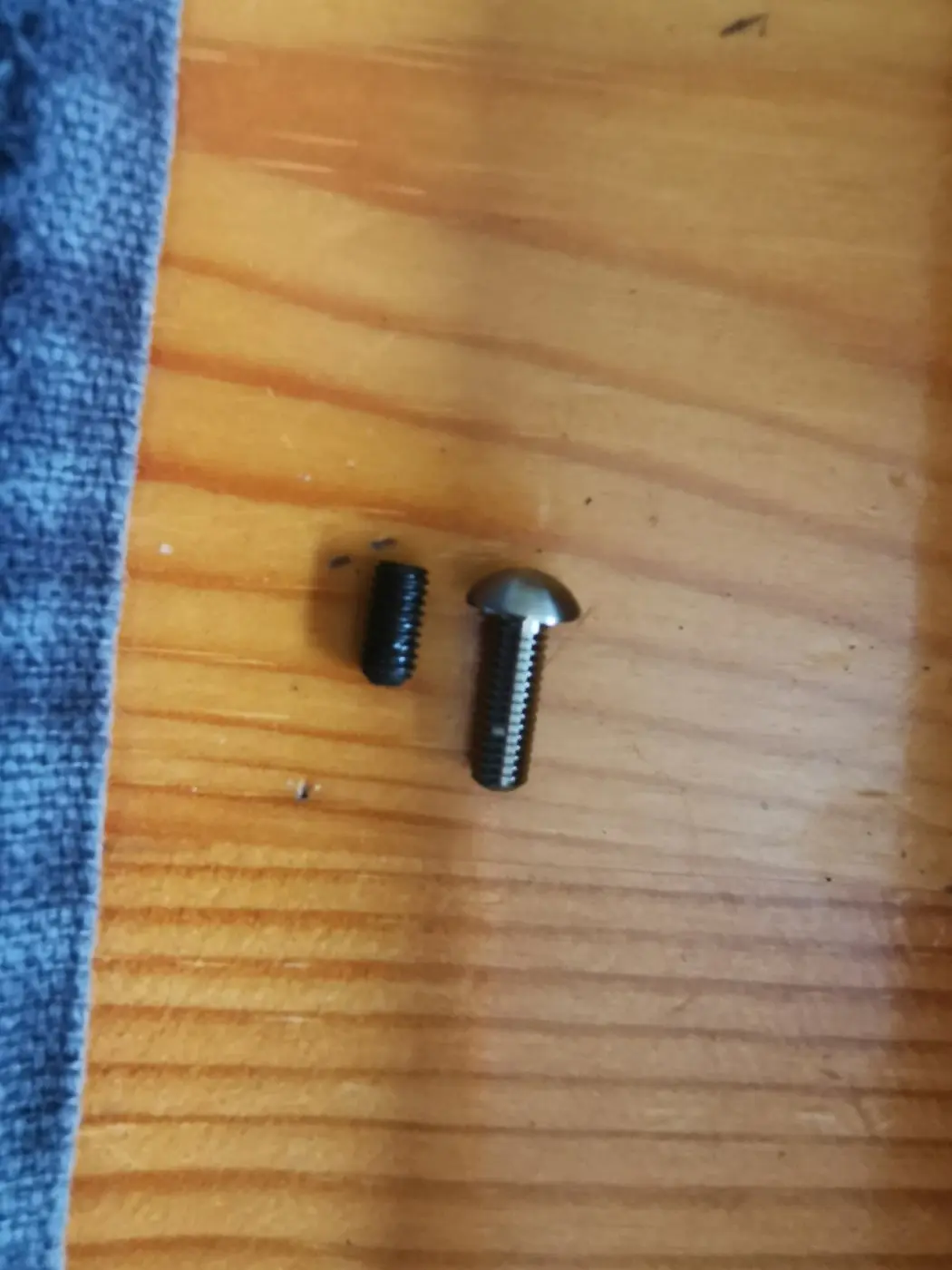

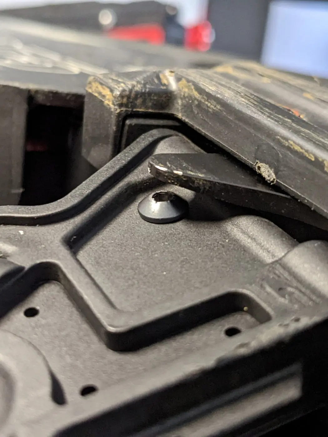

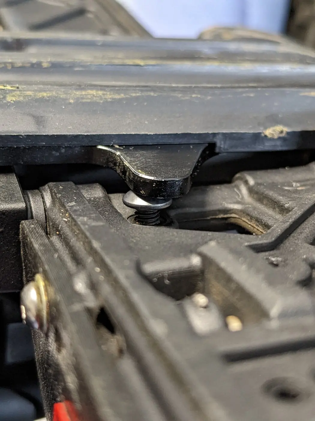

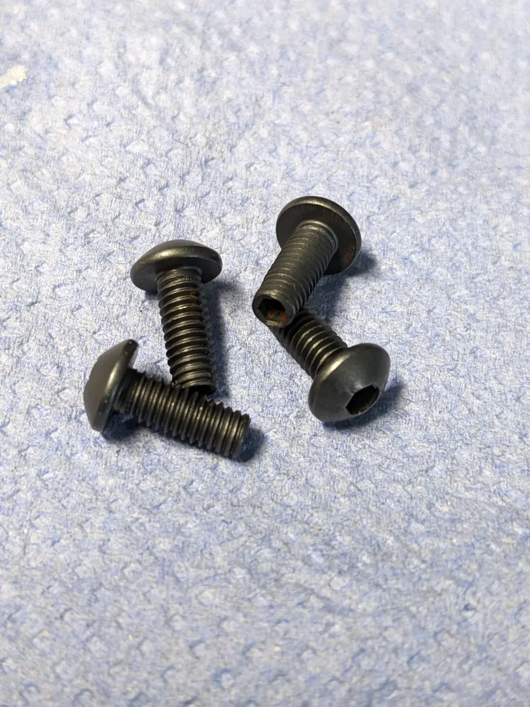

Did finally the same! Hope it worksInstalled the Tekno screws and I'm pretty sure this will solve the problem! It might still mark the chassis etc but it will not puncture through it like the grub screws where doing. All droop screws should be like this!

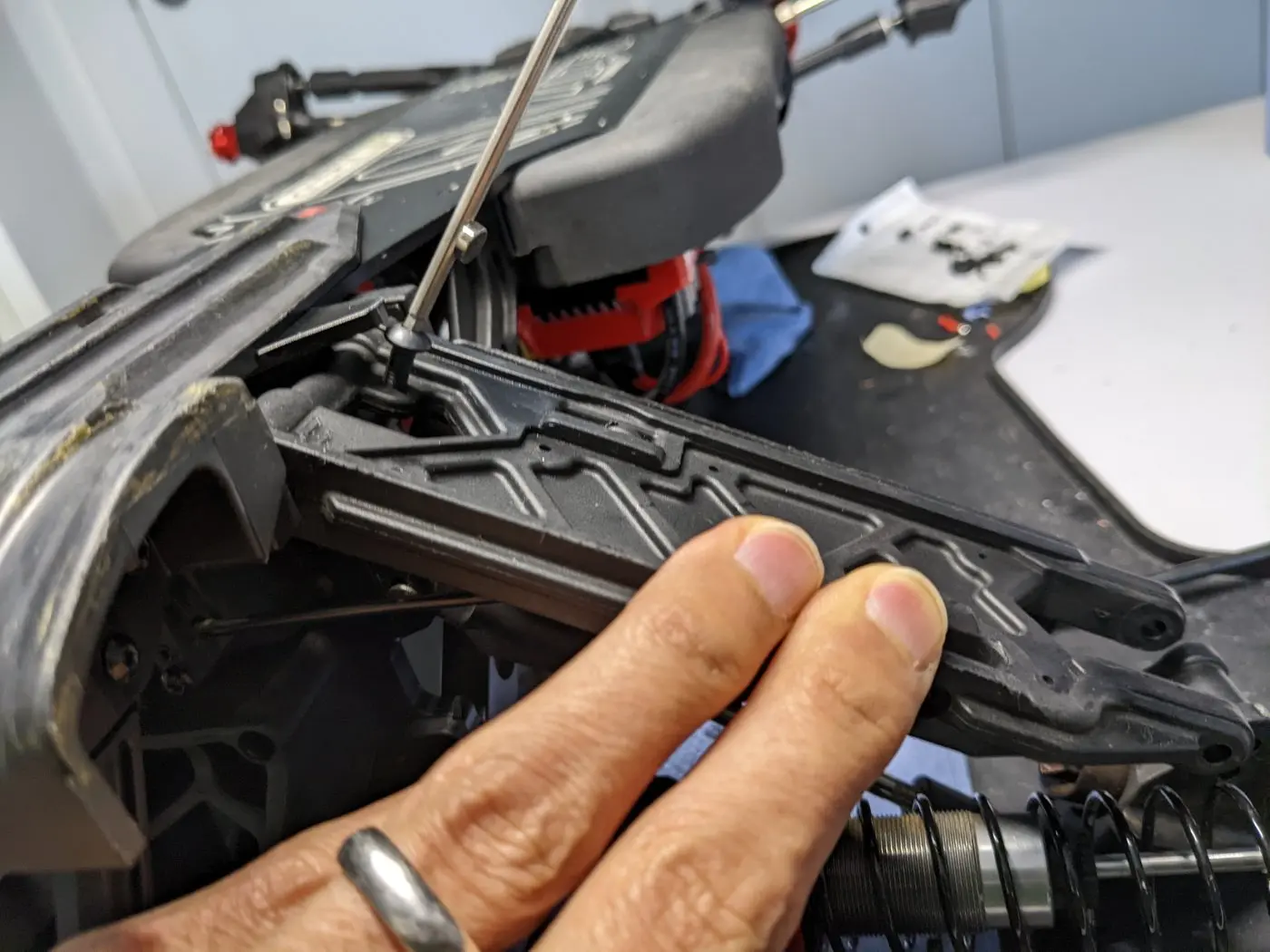

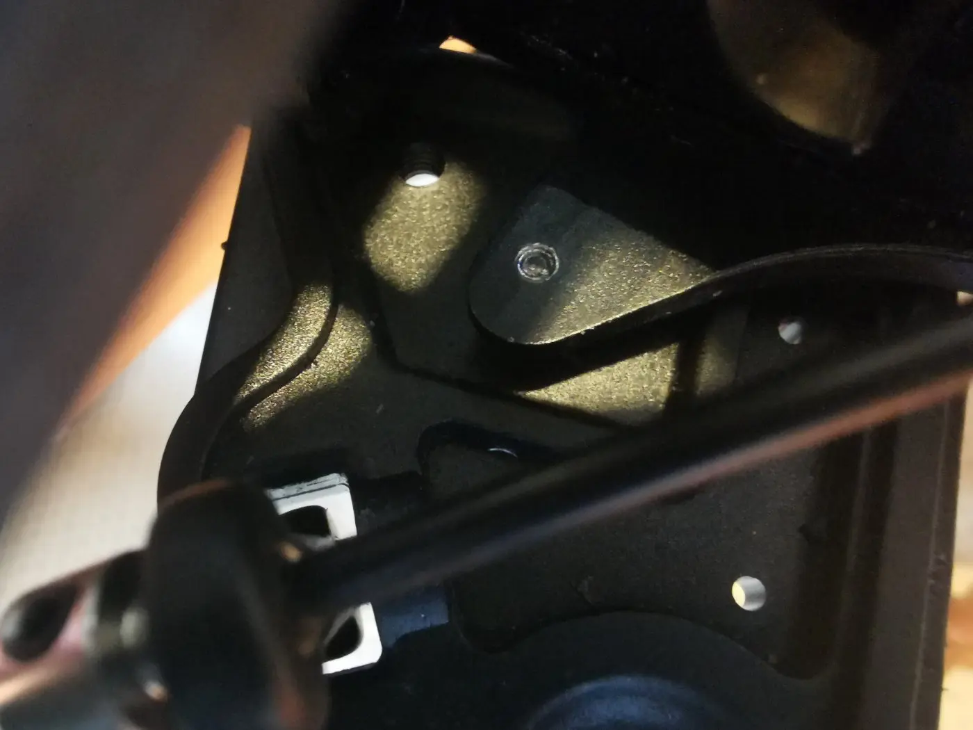

Forgot to mention, the screws need to be installed from the bottom obviously, as opposed to the grub screws which are installed from the top. The simplest way to do this it by removing the shocks at the lower end from the arm, then on the back remove the rear hub and this allows you to remove the dog bones and then you can flex the lower arm upwards to have enough room to put the screw in without having to remove the arms completely or having to separate the front/rear gearbox assembly from the chassis. The front arms is a similar process, but it's easier to remove the upper arms instead of the steering blocks.
