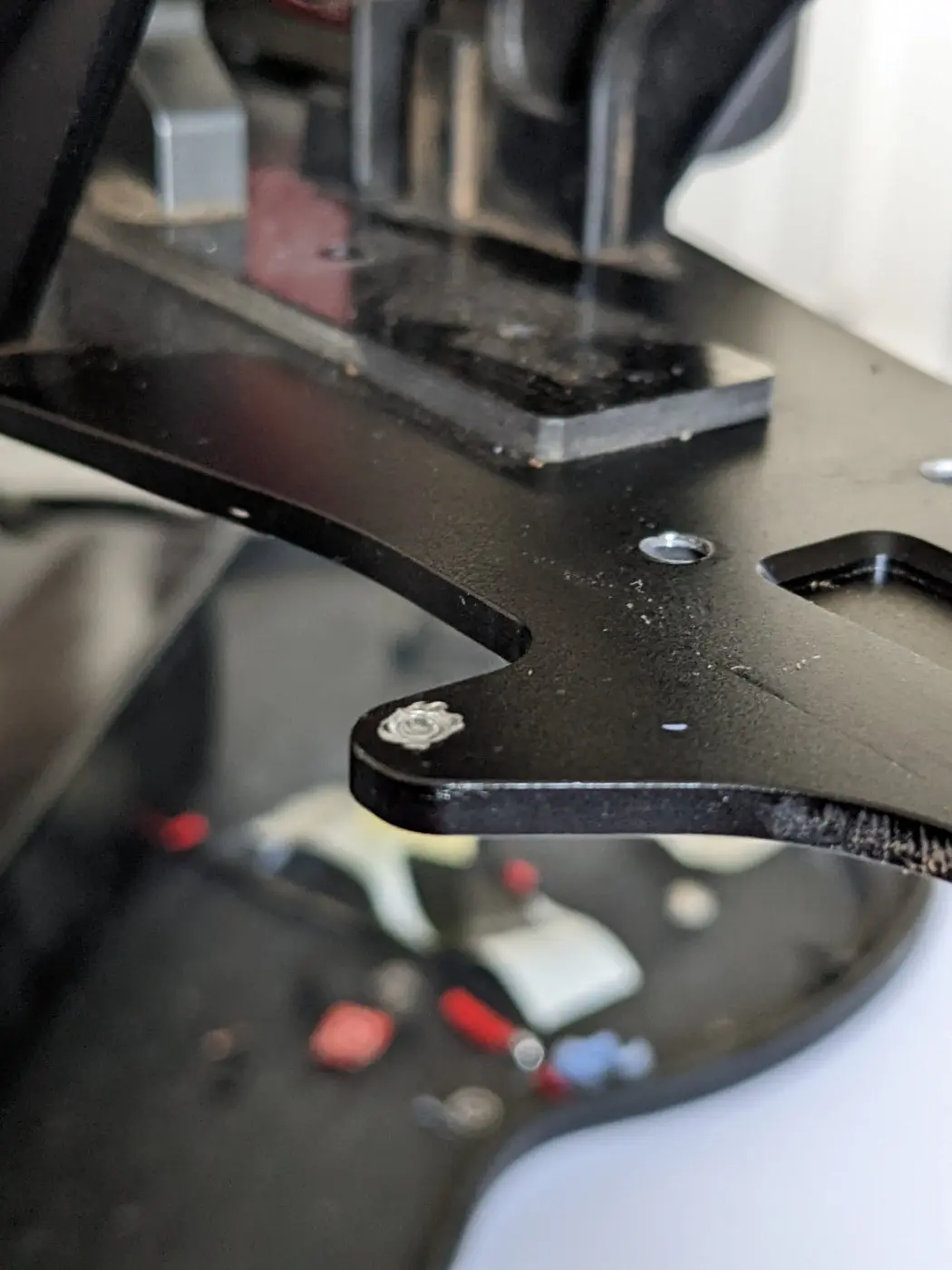

The Avid droop screws I got hold of are 12mm. These can be used front and rear, but the stock sizes are 8mm front and 12mm rear.
At the front with the droop screws all the way in, I set my droop to 124mm each side. (from top of shock to bottom of shock). Out of the box, droop was different from side to side (by 3mm at the front and 2mm at the rear). What can tend to happen is - droop increases as the divot gets bigger.

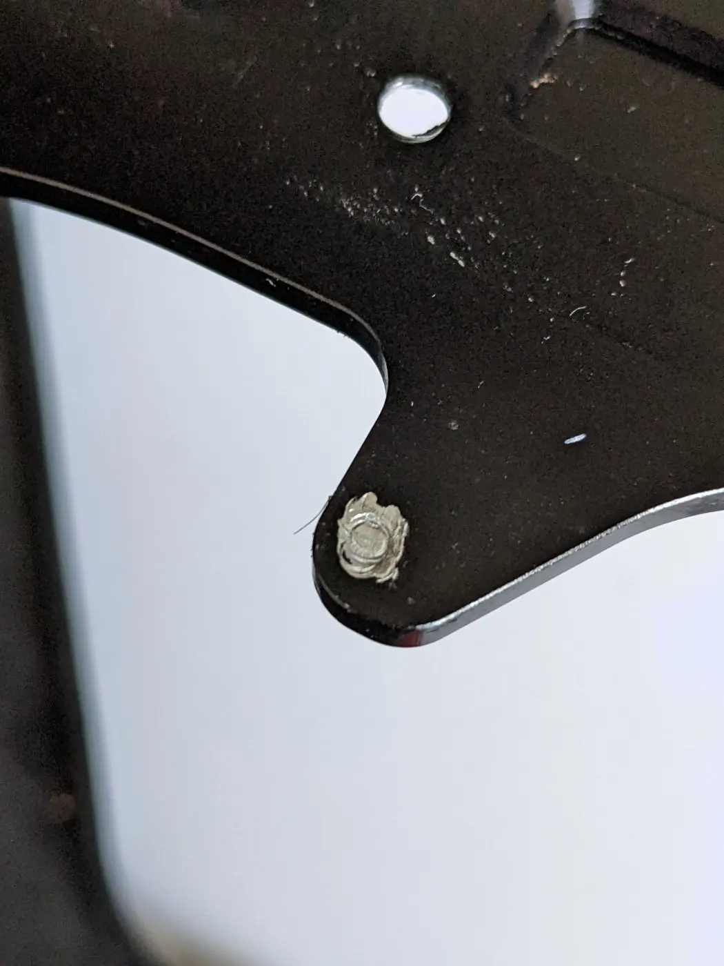

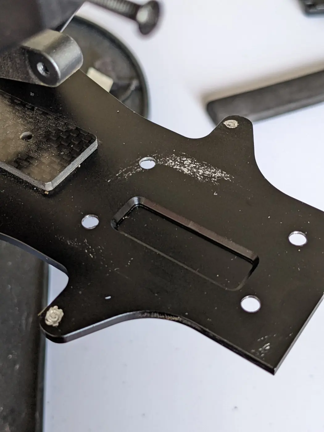

Steel grub screws left their mark. At least they were neat little round ones!
The XTR required the arms to be removed for these Avid titanium droop screws - these did not have hex sockets on the button head side. I don't mind too much, because once fitted, droop adjustment is always made from the top.
The rears were installed and adjusted for 134mm each side. This is where 12mm suddenly seems like a good idea. You need a fair bit more reduction of down travel on the rear shocks on these to attain 134mm.
