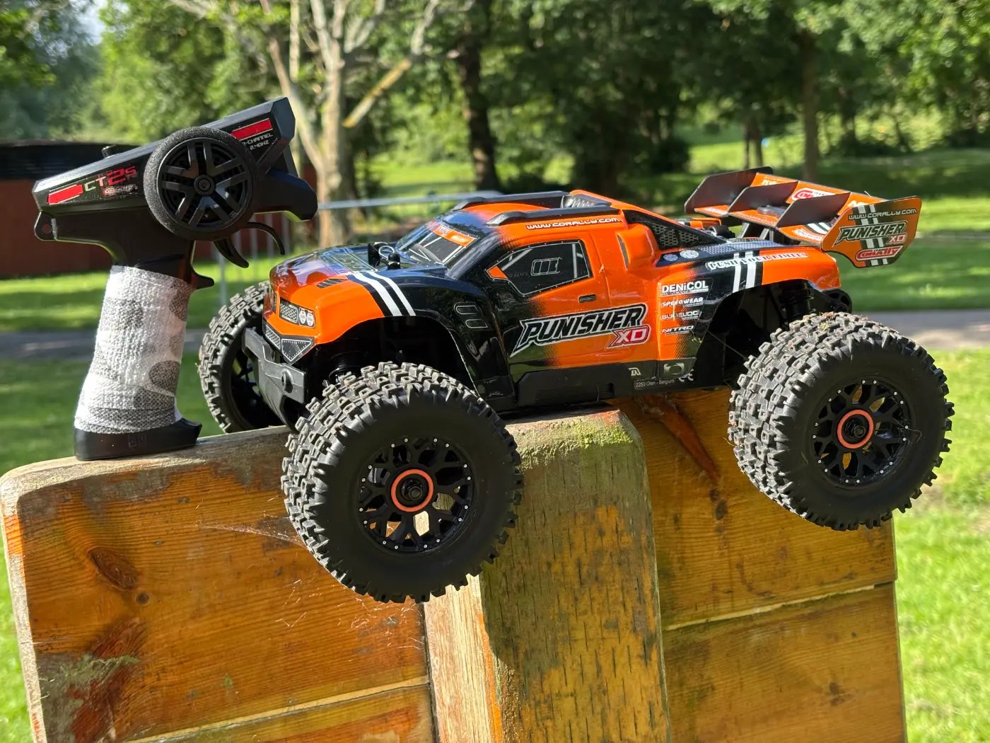

So, I couldn't resist buying this for the price it costs (it cost £135), it's just embarrassing how cheap it is compared to Arrma's offerings..
I present you the Punisher XD..!! (they also do the Furago XD - looks like a Kraton)
Yes, yes it's brushed, but trust me it's still super fun..

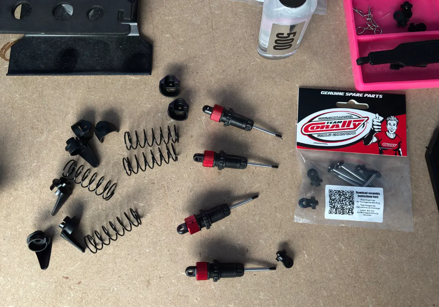

The current release batch had some faults that were found out after YouTubers got hold of it earlier in the year, so to my knowledge Corally held it back and added the parts needed to fix it in the box, the next batch will come with all the parts fitted from the factory.
The parts in question are shock shafts/rodends, battery tie down and the servo.
Servo was originally all plastic gears now it's all metal, the shock shafts are now thicker at the rodend, end of the shaft and the battery tie down has a redesigned clip system.. Thanks Corally for the updates
Comes with a full size shorty battery and a decent 2s/3s usb-c charger that is way bigger than anything I've ever seen in a mini..!!
Replacement parts in the box, complete with QR code fitting instructions..

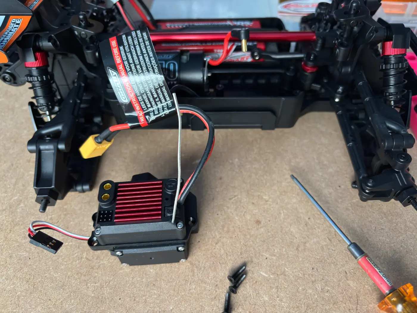

Three minutes later and the servo is on its way out the car
quite strange, it has a 3 channel 2 in 1 esc/receiver 60A..
Servo out..... New servo comes pre-fitted with servo horn mounted/centered and ready to go..!!
Shocks are all the same length and size, full plastic with threaded body's and two piece shock caps, they take 500cst oil form the factory..
Hard to see from my pictures but it's like the original shafts have either M2 or M2.5 thread (I didn't measure them) and the new ones look to be M3 thread size.

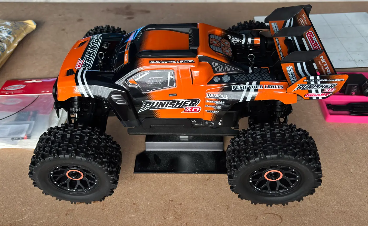

All back together, highlighted the wheels just for fun..

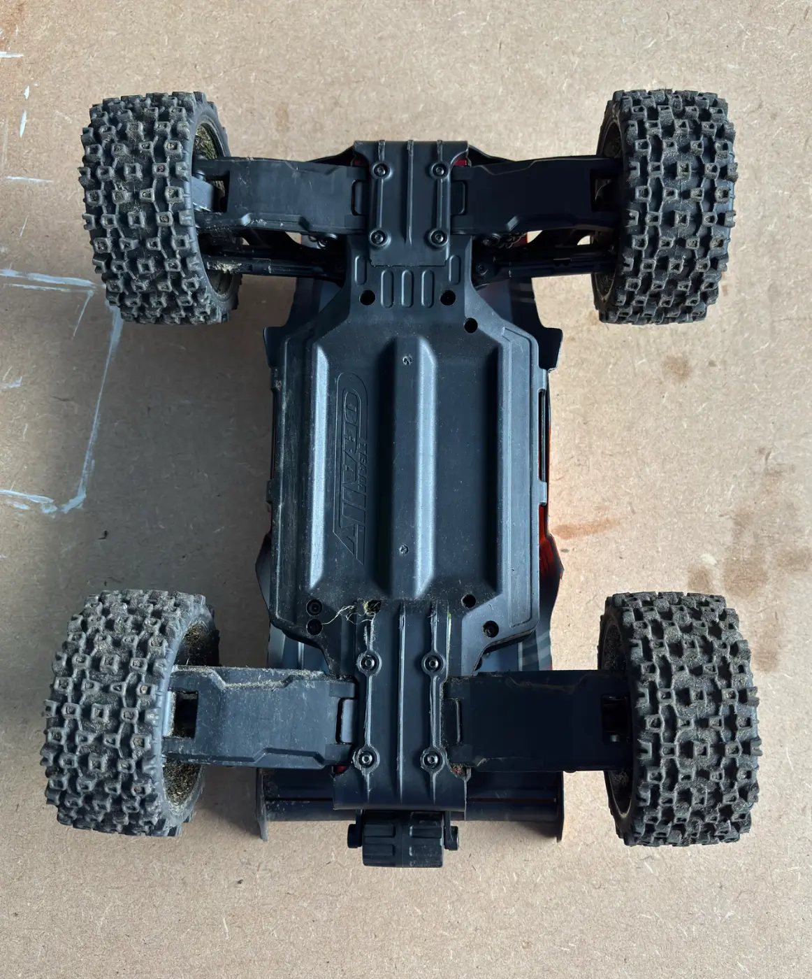

Pre first bash..

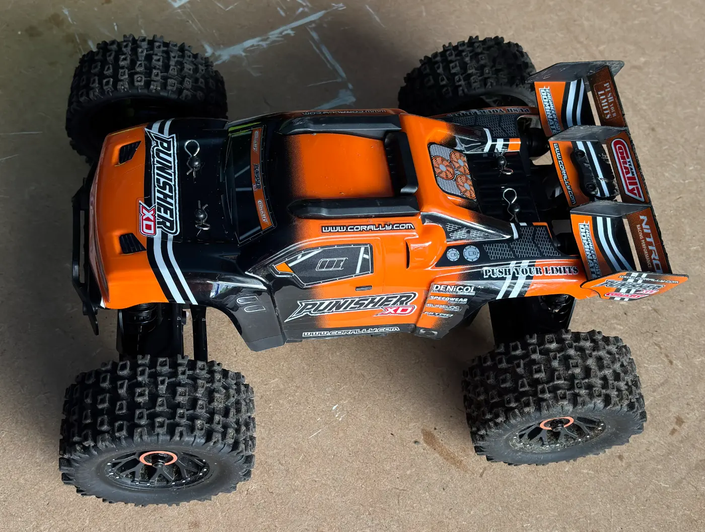

Post bash, the car's in one piece, there's a crack in the rear wing, supposedly the wing is flexible which it is, but one tumble and it broke..
other than that it's a great little mini basher..
All in all I think it's great for what it costs, it's stop gap fun inbetween running bigger cars, and I can confirm it fits in your average sized backpack..!!
