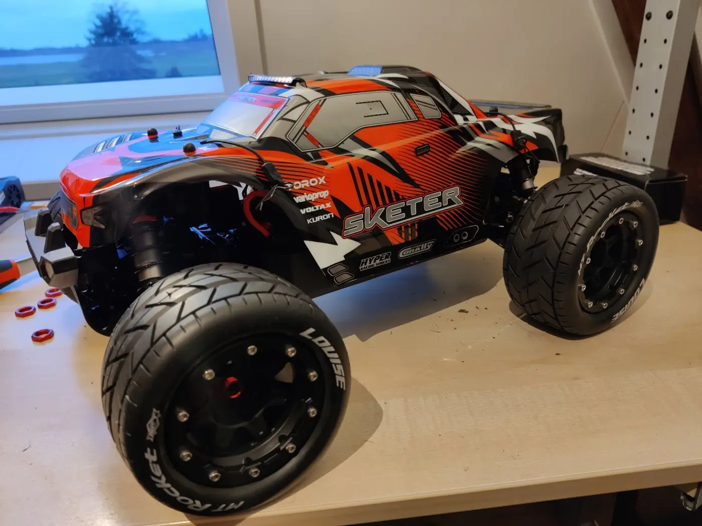

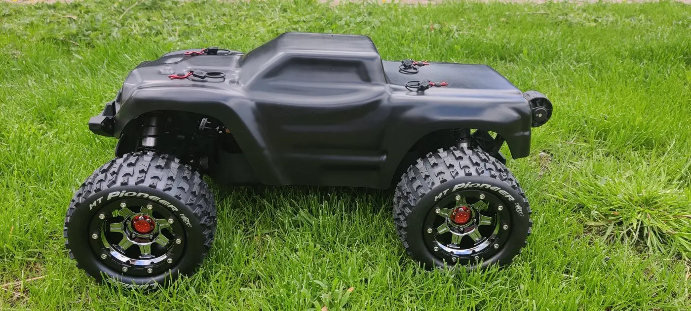

Got these louise belted onesSorry for the hijacking, but what if you want to use on-road wheels?
Any suggestions?
I don't wanna try my Sweep Racing road crushers that i think they are too big.
Yes. And the price is not bad either.
Do you use those for off-road??
Yes, but i just saw that shipping went sky-high at 35€ :/Yes. And the price is not bad either.
That is 2 much indeed. Kronos needs bigger tires anyways.Yes, but i just saw that shipping went sky-high at 35€ :/
