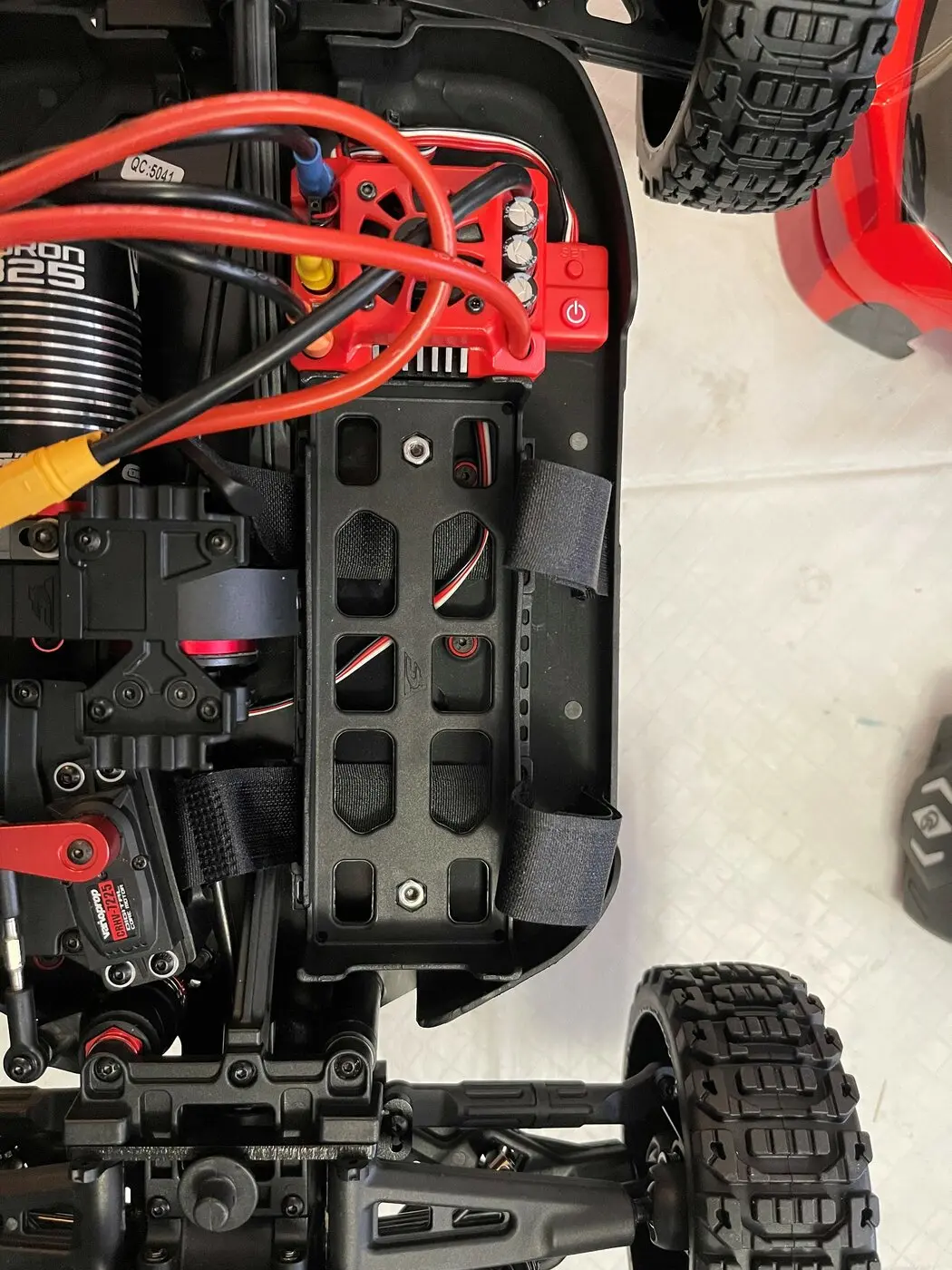

Thanks. Does the V2 battery tray move the ESC towards the rear? If not, the V2 battery tray will not help because my battery tray is already as far forward as it can go.
The HRB 4000mAh 60c batteries I ordered arrived late yesterday. They are a perfect fit for my Radix 6: it's like they were designed for this battery tray. Unless these batteries turn out to be poor performers, I'll stick with the stock battery tray for now.

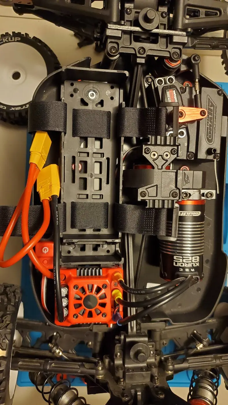

Just swapped out my Radix battery tray for a Dementor battery tray, fits perfectly. Just needed to add a few screws to attach the ESC tray to the battery tray (2 pieces vs 1 in Radix). You might want to put some double sided tape under the ESC tray to secure it a bit better. The ESC is attached with screws BTW.

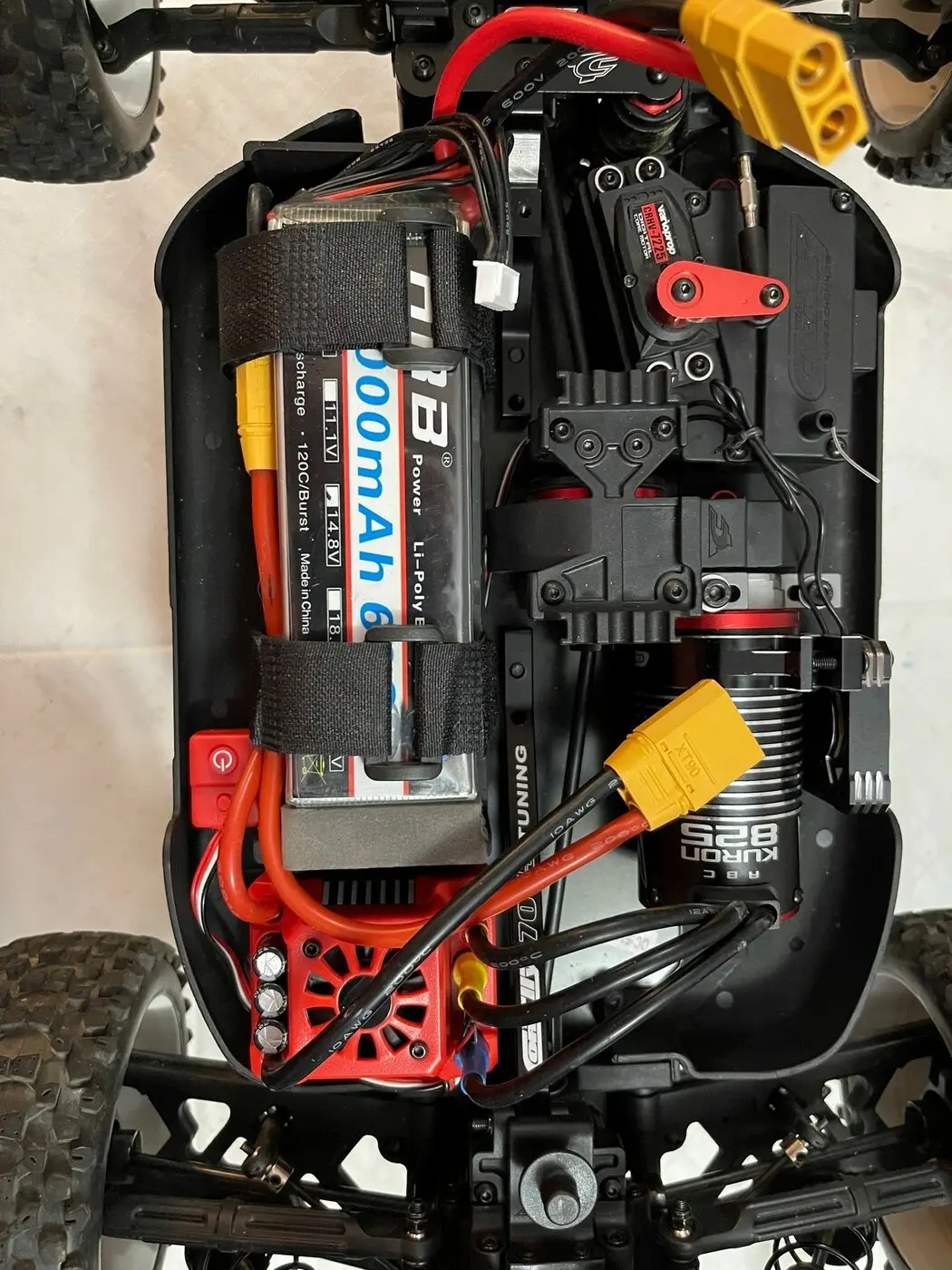

I put the V2 large battery tray into my Radix6 a few days ago. It was a tight fit, but it worked. I did have to put a piece of high-density foam behind my HRB 4000mah 6s battery to prevent the battery from shifting in the larger tray.

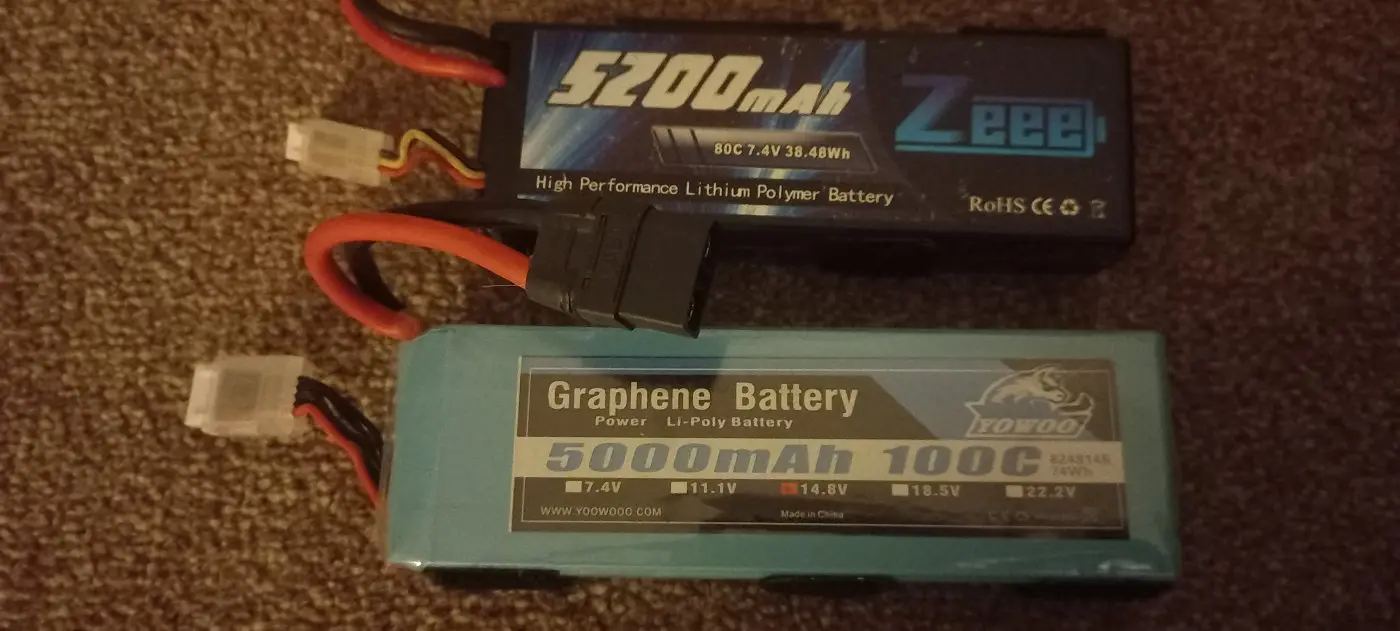

Zeeee 5200mAh 80c (twin 2s) are great value, and I've also got Yooowooo 5000mAh 4s 100c Graphene which is also holding up well and staying balanced. I tend to buy them when they're on offer/have vouchers, so it's normally less than 40 quid.
I get whichever are the best capacity/C rating/price, and switch connectors to XT90. Yes soldering 10awg isn't fun, but certainly easier onto XT90 than a Deans.
