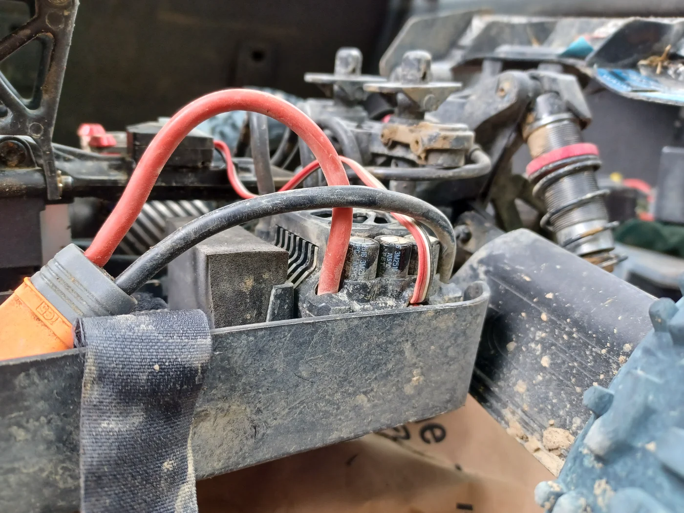

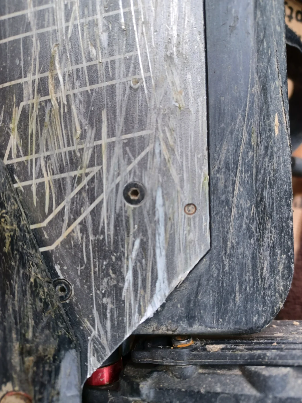

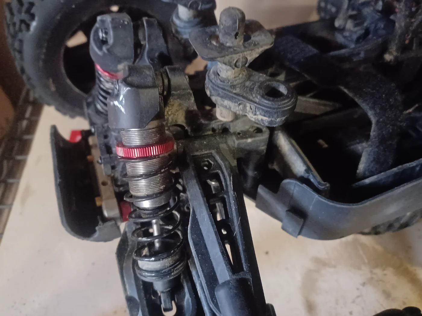

That's not just a new screw in my chassis, it's a new screw hole. My ESC plate flaps up and down no more. I also installed three 3x6x4mm spacers in-between my ESC plate and the battery box to raise it above the feet of the rear tripod brace. The third spacer is CA glued to the bottom of the ESC plate chassis mount (the one my new screw mounts to). The ESC plate sits 1mm higher than the foot of the tripod brace. Everything fits perfect.

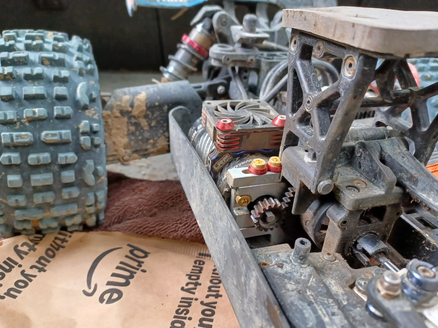

While I was at it I also installed a new ADU Kagama 6s motor mount. It fit perfectly with no modification to the truck.
The fan on the motor made a really big difference. Last drive I overheated the motor with a 14t pinion. This drive I ran a 16t and the motor only got mildly warm.

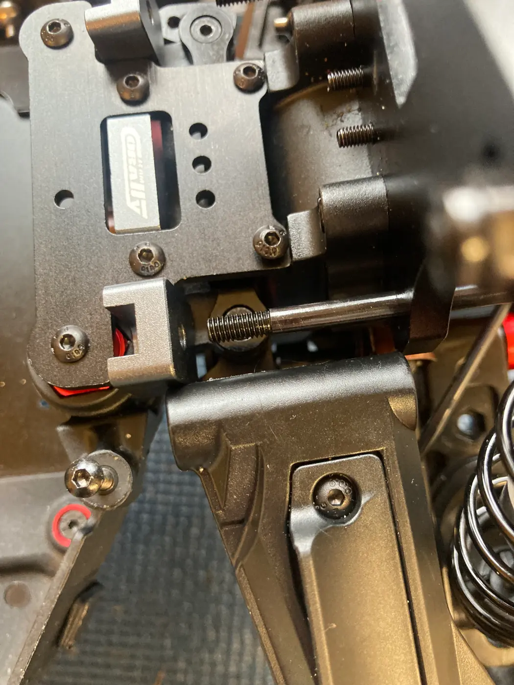

I've got ADU hinge pin retainers and Corally Asuga adjustible steering links on order. I'll post about them when they're installed and tested.
And yes, I know my truck needs a bath.
