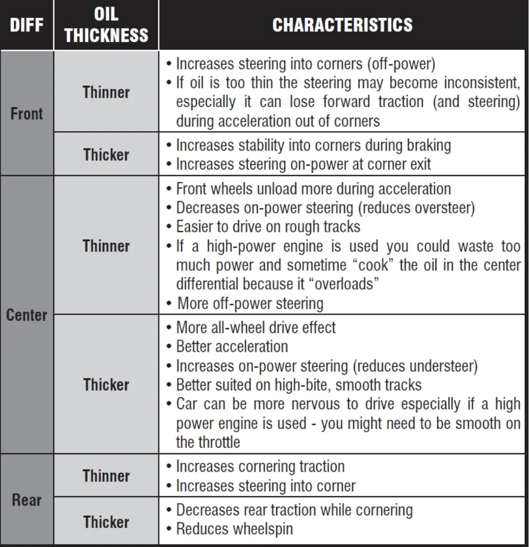

So, I put a Max 6 ESC/Motor combo in my Asuga. I took it out for a quick shakedown run on Sunday, nothing major, just ripping it back and forth on a grass field to check out first impressions. It is a BEAST. Lots of low-end power. It can wheelie with a 19T pinion. Also, the front tires balloon like crazy.
I'm going to thicken up the diff oil, at least the center for sure. Should I go 200K, or jump right to 500K? Currently, I have stock weights in the front and rear diffs. Should I thicken those up as well, leave as-is, or see how it handles after thickening the center diff oil?
Any advice is much appreciated. Thank you!
