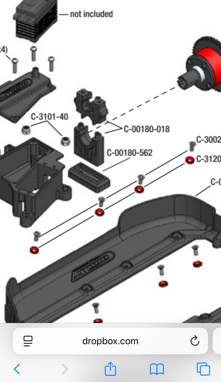

That’s for the 52t spur where Syncro 46t so the the diff will fit but the diff mount to low then on one side. They all use same diff mount but the vehicles with 52t sour have a spacer underneath that’s the part you would have needed to make it work. C-00180-562

I used the c-00180-176 bulk head and the 177 motor mount in the end. With the stock diff mount.
46t spur. 15t pinion.
