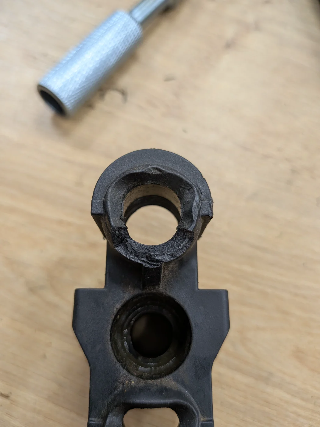

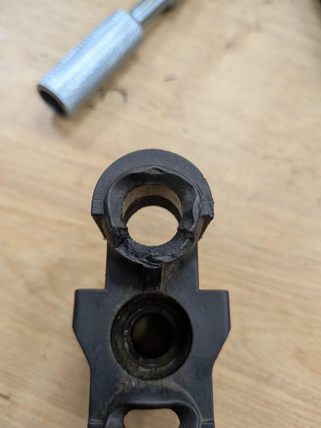

I actually got one to break at the weekend! First one ever, it was some very silly behaviour that made this happen.
