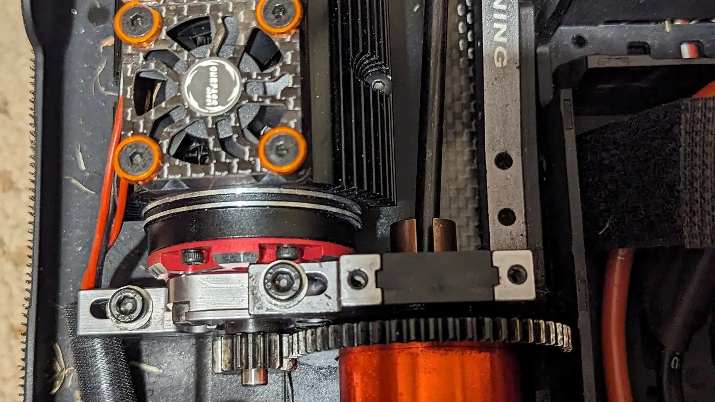

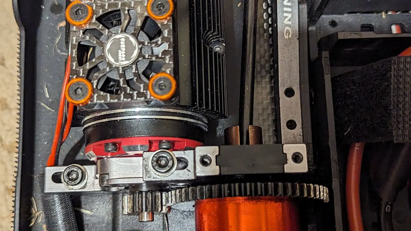

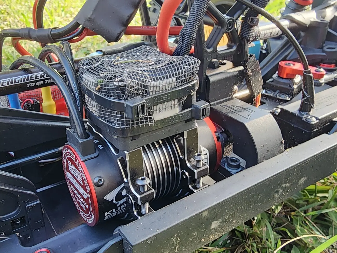

13t is just gonna waste your time. You're gonna switch it ASAP. 15t a good starting point. You don't have a tone of pinion options unless you change the spur gear. (In that case, leave the 13t pinion and change the spur from 52t to 46t.)

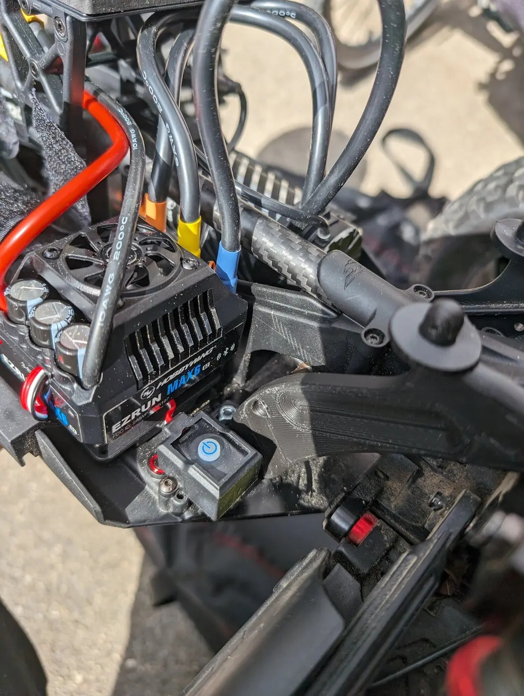

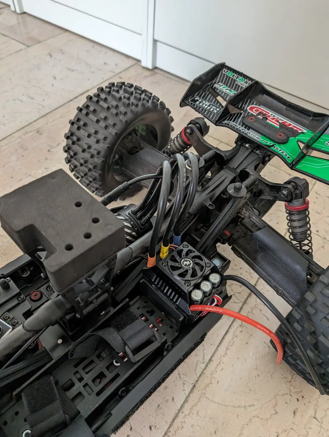

Currently my Shogun is running a 46T spur and a 15T pinion on a HS 1850KV 4274 motor. I run it on 4S, and the temps are very agreeable for all the electronics.
The only problem is that even with the smaller spur and bigger pinion, it still has quite a bit of torque. It can do a 10ft triple from nearly a standstill. Great for when you need to make up time, but an annoyance when you're trying to navigate the infield. 🤦‍♂️
