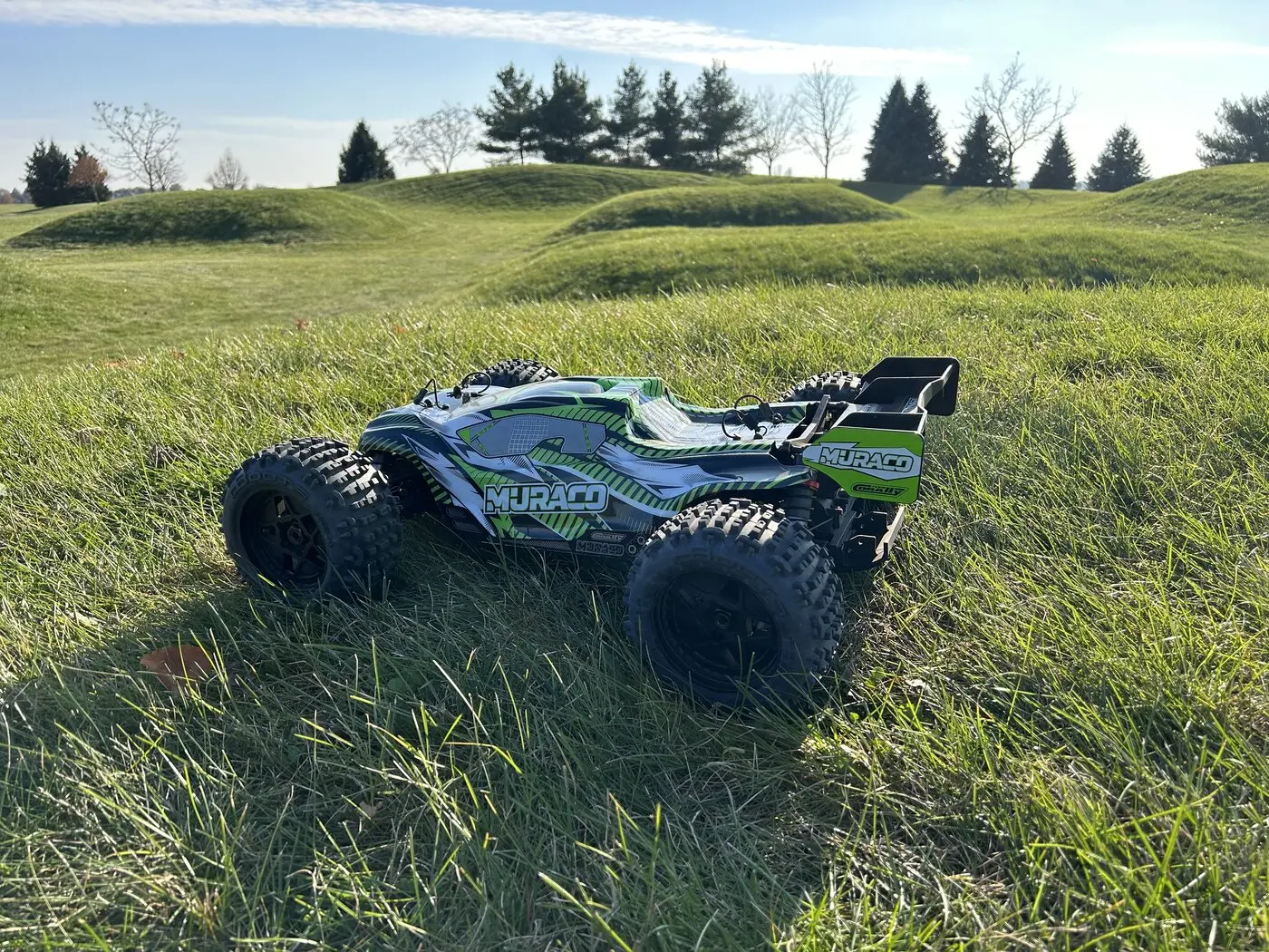

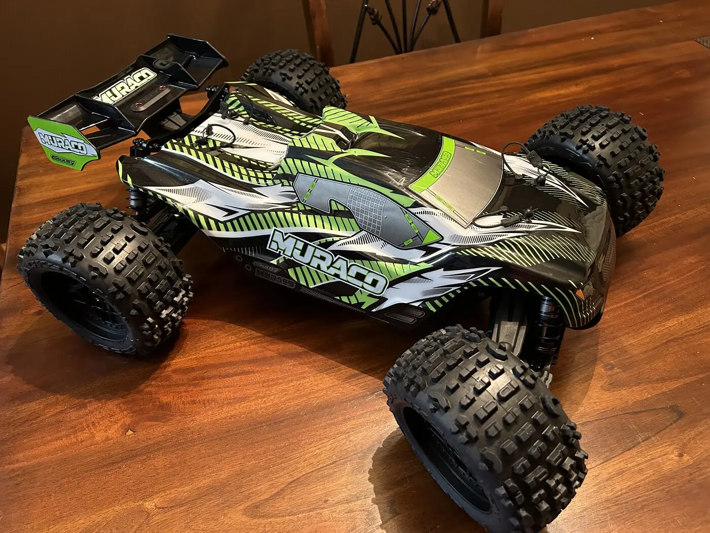

Haven’t gotten home from work before dark all week to run the truck but I’ve managed to get a few things done. +8mm hubs and Backflip 4s tires/wheels. 60w oil in front shocks. Diffs topped off…thanks factory workers for not filling them lol. Kronos front/rear skids. Third battery strap installed and battery tray/esc bolted back in over a thin layer of foam padding which will keep the esc from wobbling up and down and it also firmed up the tray so it doesn’t wiggle around anymore. Tower 2 tower brace will be ordered soon, but I’m not a “send it to the moon” kinda driver anyway so let’s take it out this weekend and have some fun!
Almost forgot! Got rid of that stock radio and installed a Spektrum receiver and got it set up in my dx5 radio
