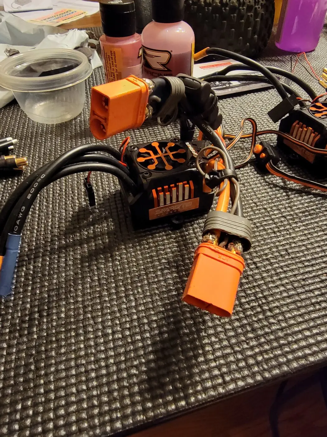

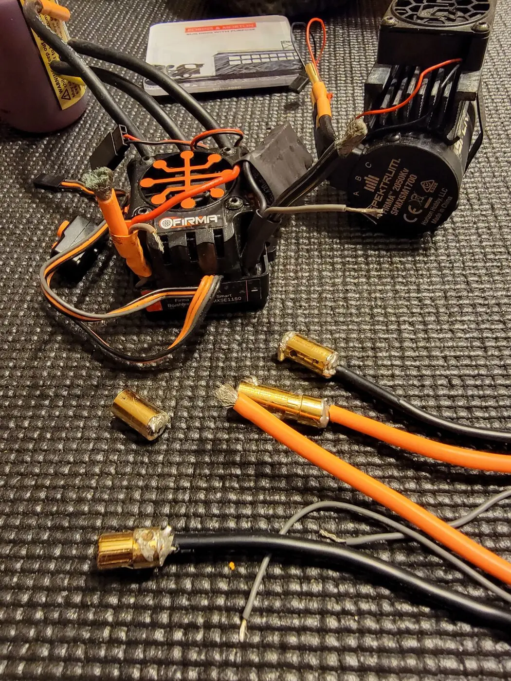

Bought this mess and need to fix it. The seller said they'd solder it after not disclosing that the wires were cut in their ad, so here I am now.
Not trying to start a thread about poor workmanship or integrity. I just need to move on and fix this mess.
These are the leads for the battery connections, I'm just gonna make it a single connection and wanted to know if this is a clean solution.
I bought 10ga silicone wire, a pair of IC5 connectors, and was thinking of using 6.5mm bullet connectors near the ESC. I don't like double connections, but really don't know if using a butt connector would be appropriate so I'm using these. I have a second ESC combo that I need to do this on as well, and figured I could just use the one harness between both cars.
Any advise would be greatly appreciated.
If it were me I would put 6.5 or 8mm bullets on the esc and the use extension cables again with 6.5 or 8mm bullets to get the length you require.!!

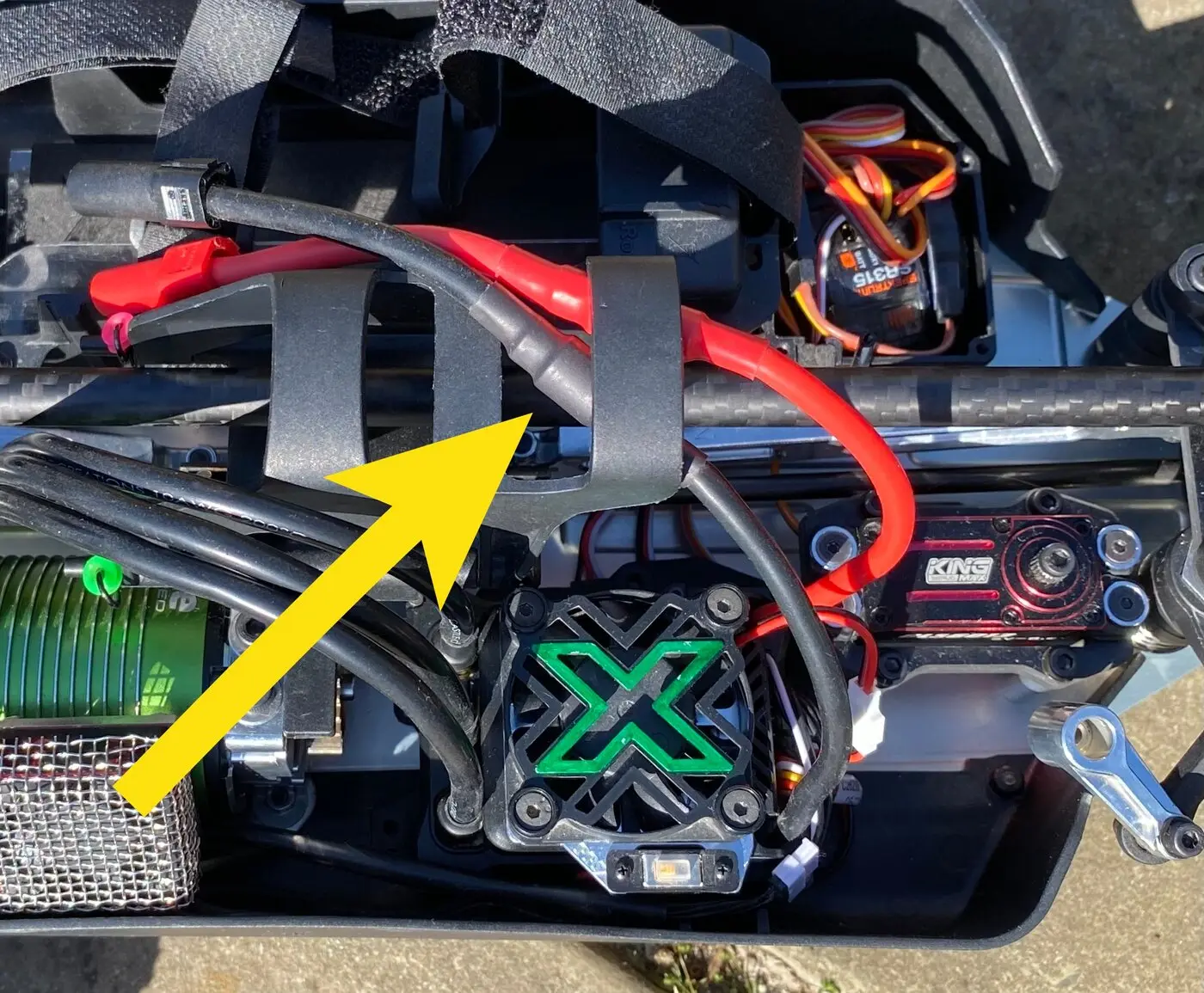

Example... here's my MMX8 that has battery wires that are far too short from the factory, so I added 8mm bullets and extension cables with the plugs I needed, plugged them together then heat shrunk the whole thing, that way it can't ever come undone on its own.👍🏼
Ahhh, fatigue was not my friend last night. Looks like I have all the parts needed, just need to shrink wrap them as permanent. I was thinking of making these removable across two systems but the last thing I need is a broken connection floating around.

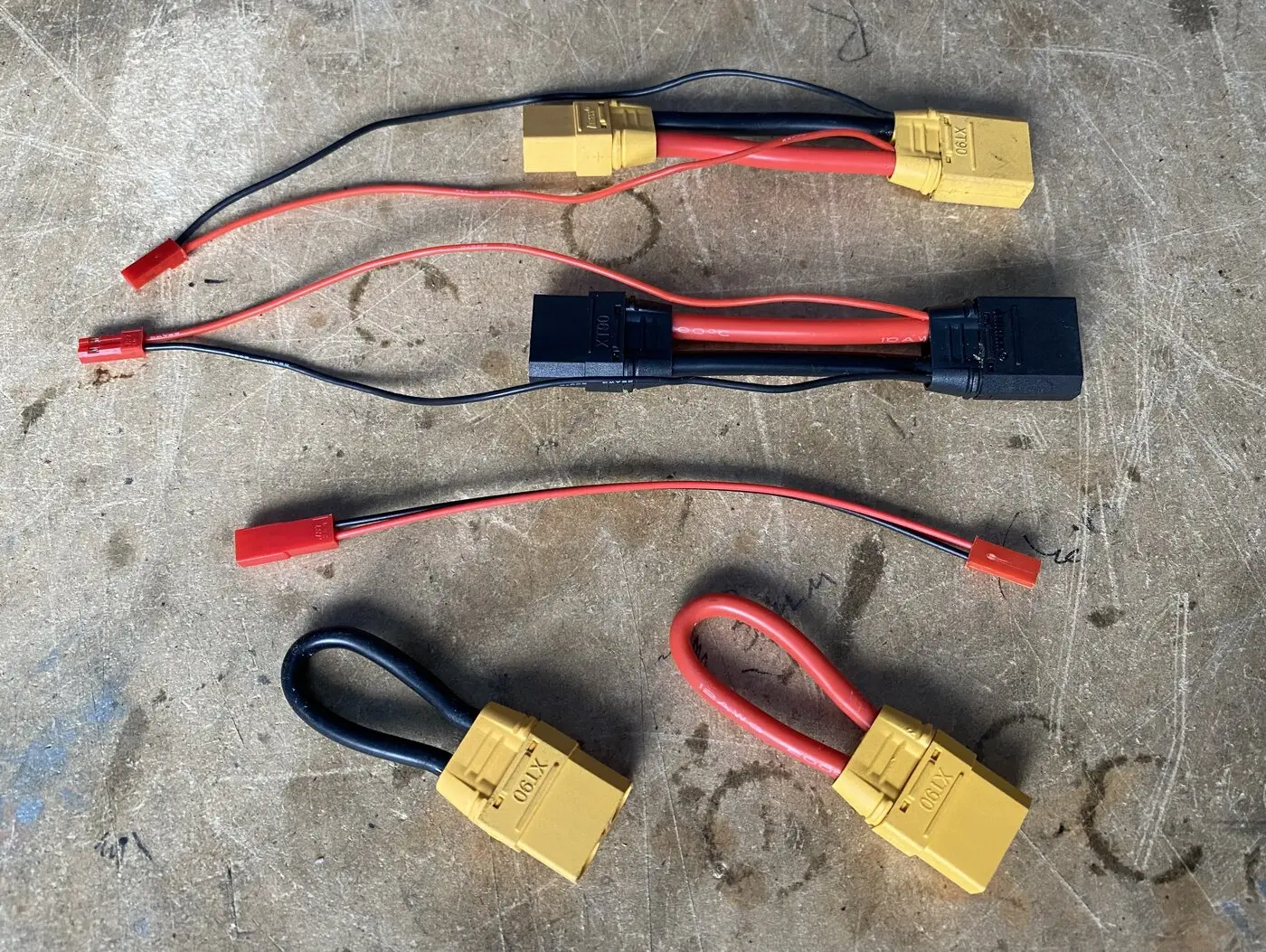

10awg adaptors I made for a friend :cool:
