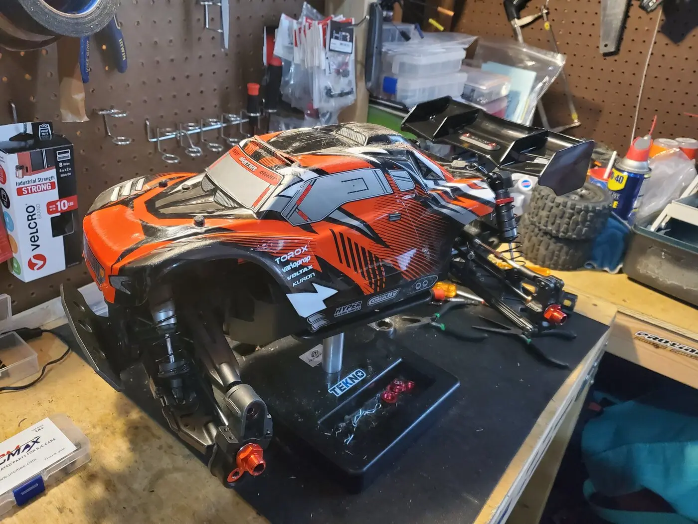

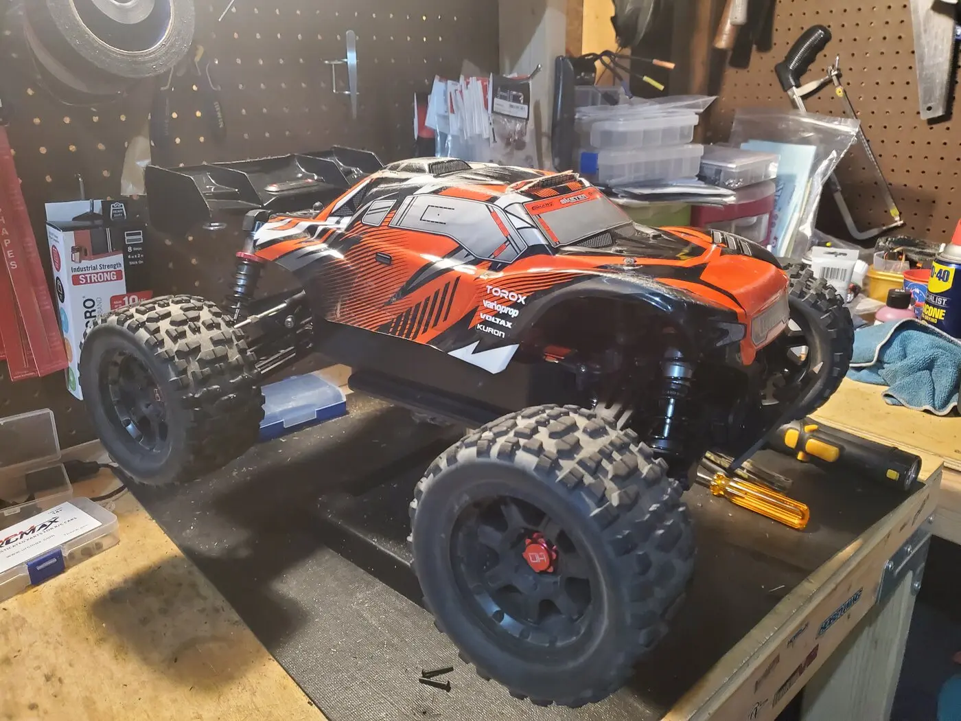

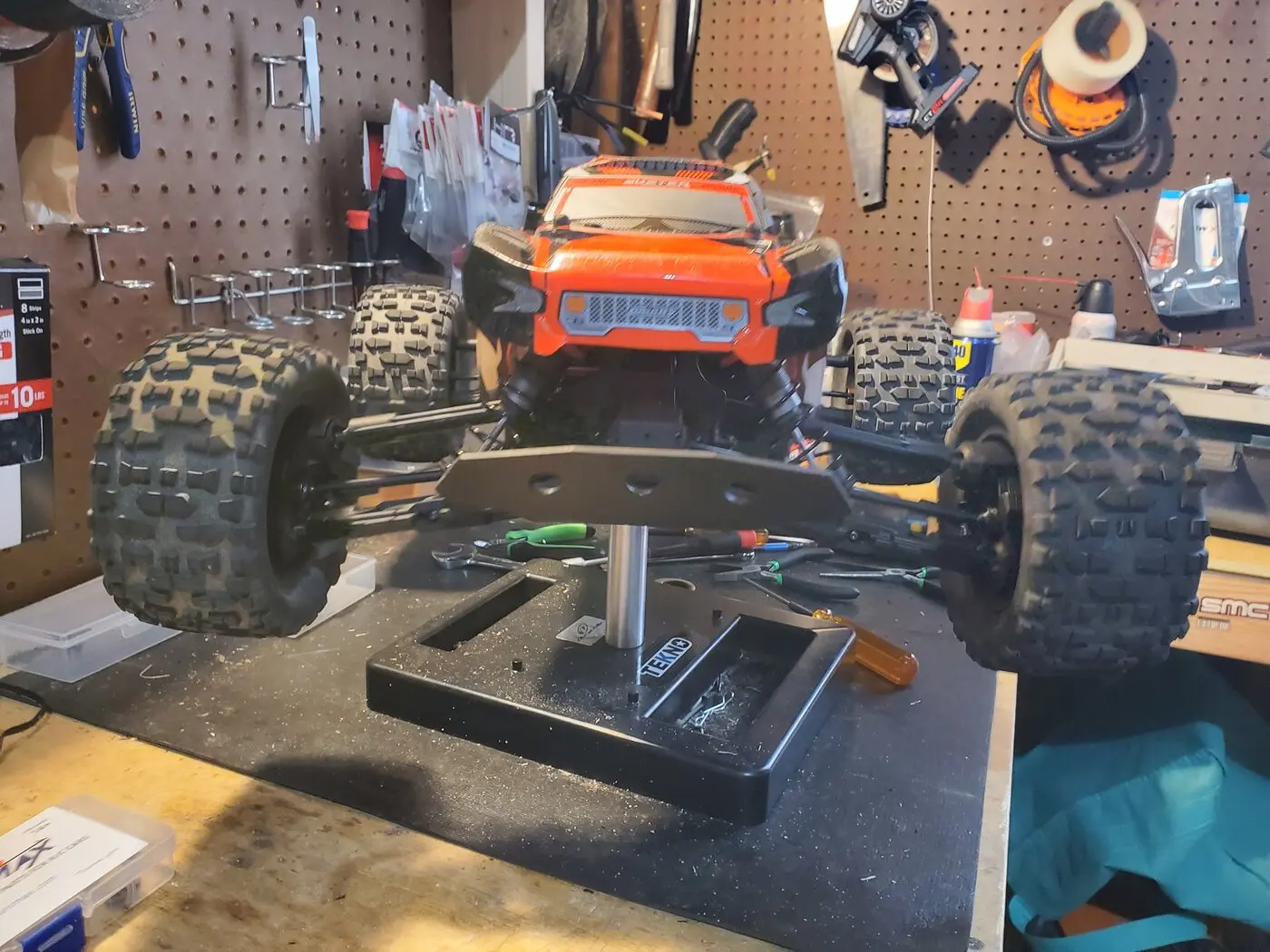

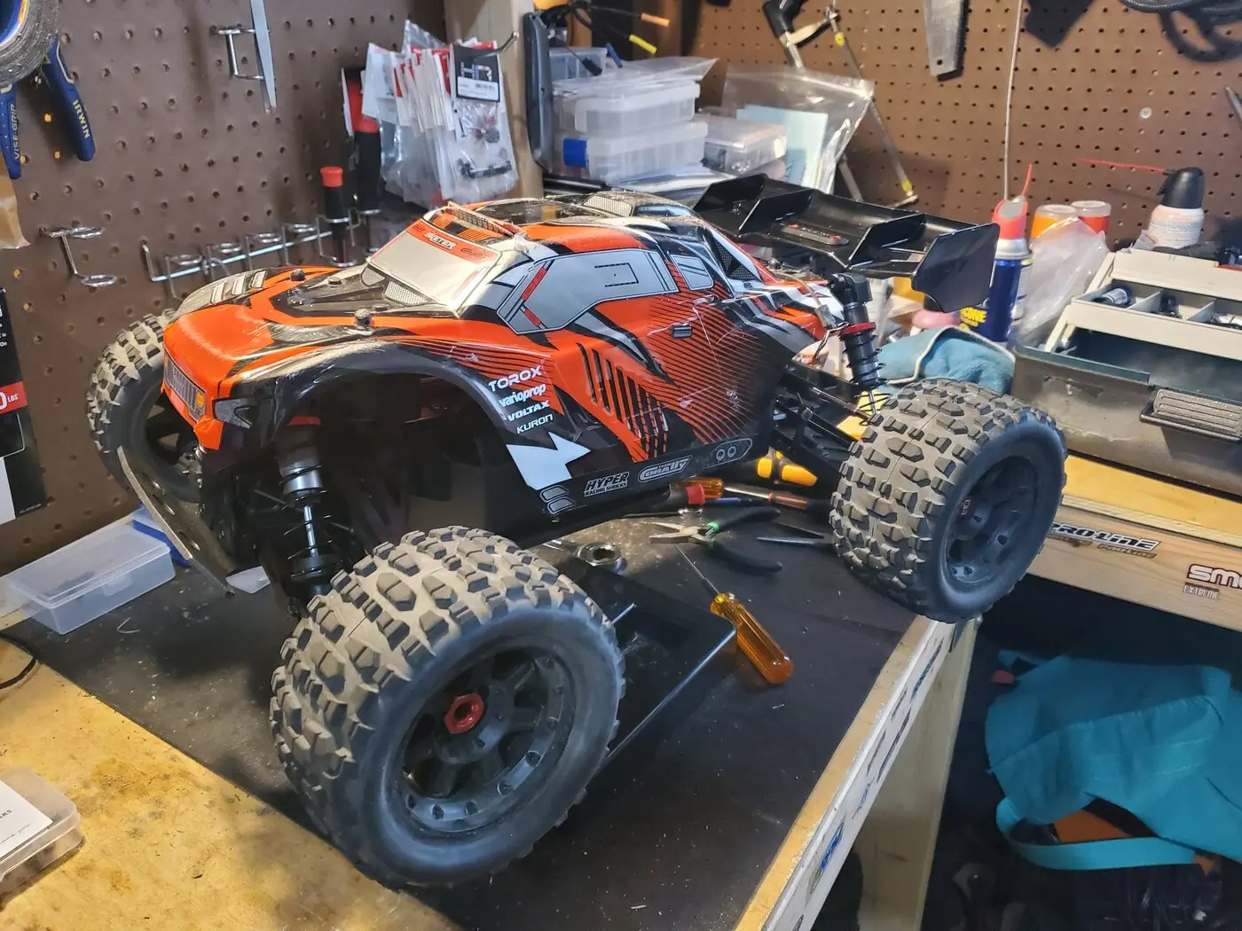

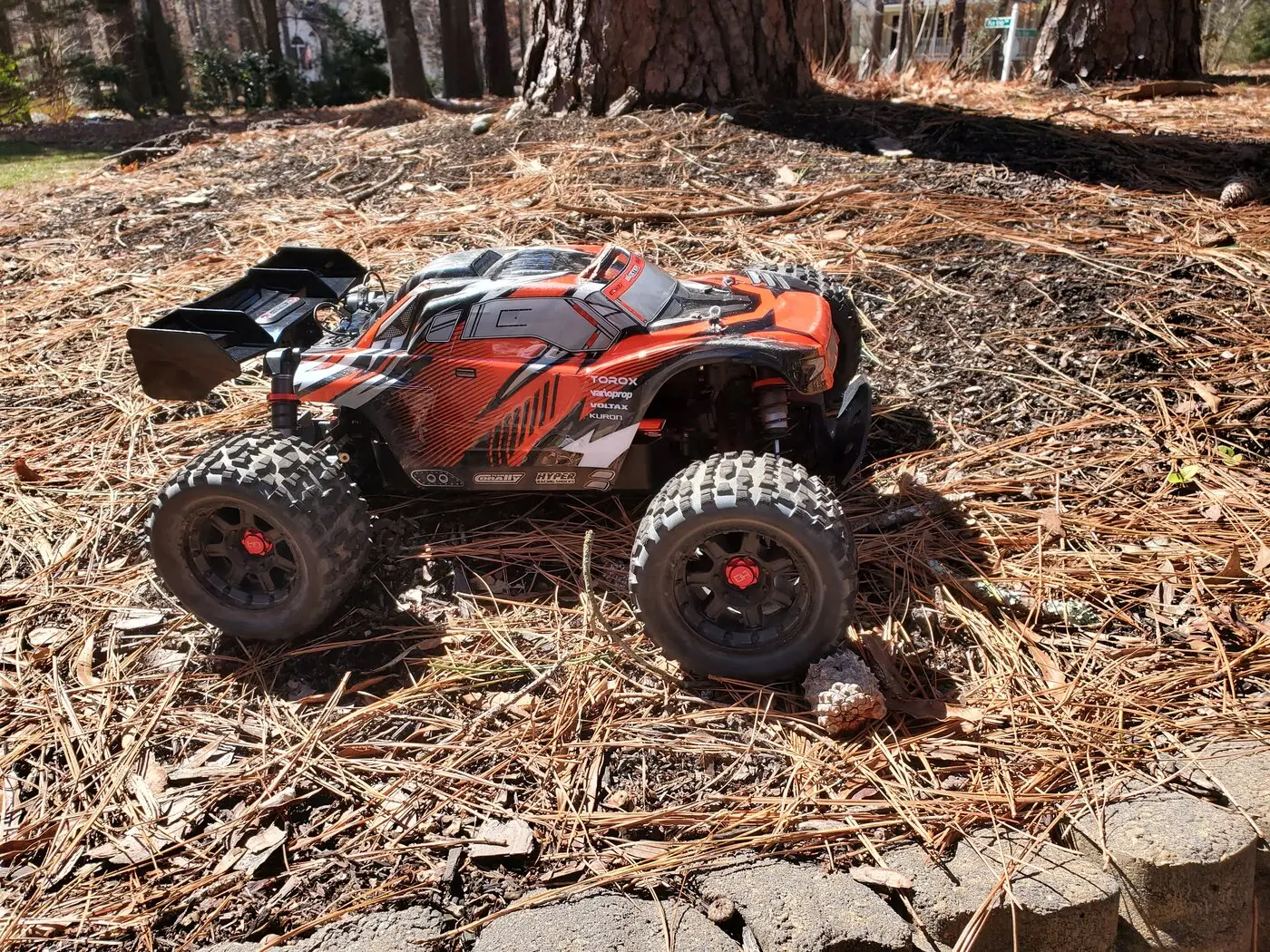

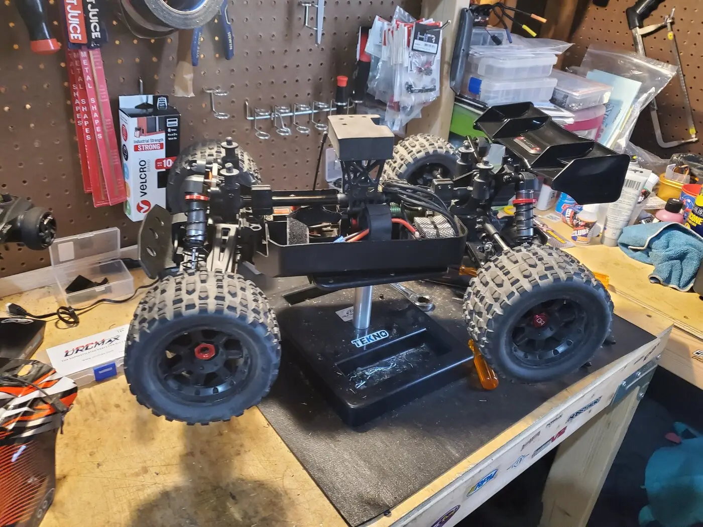

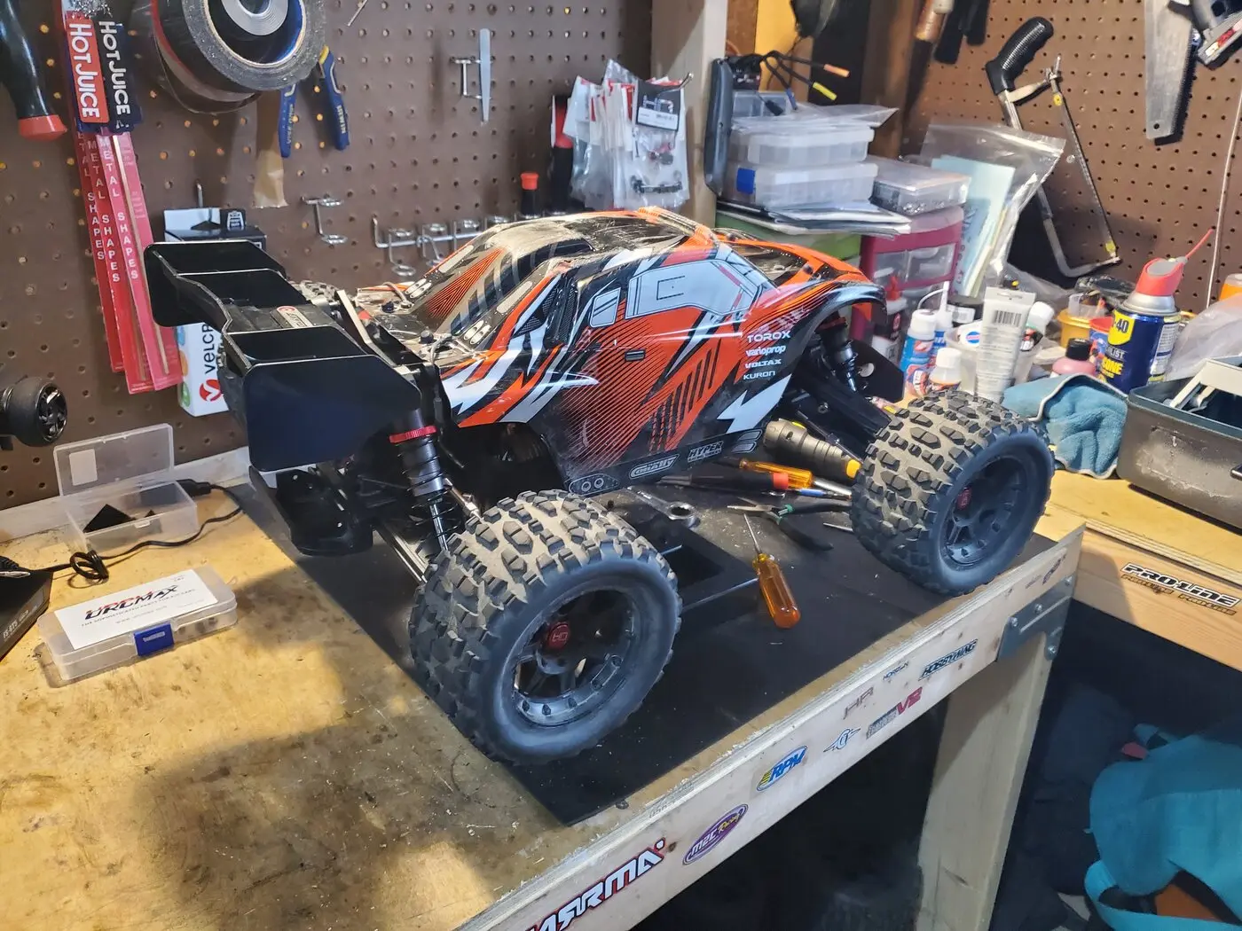

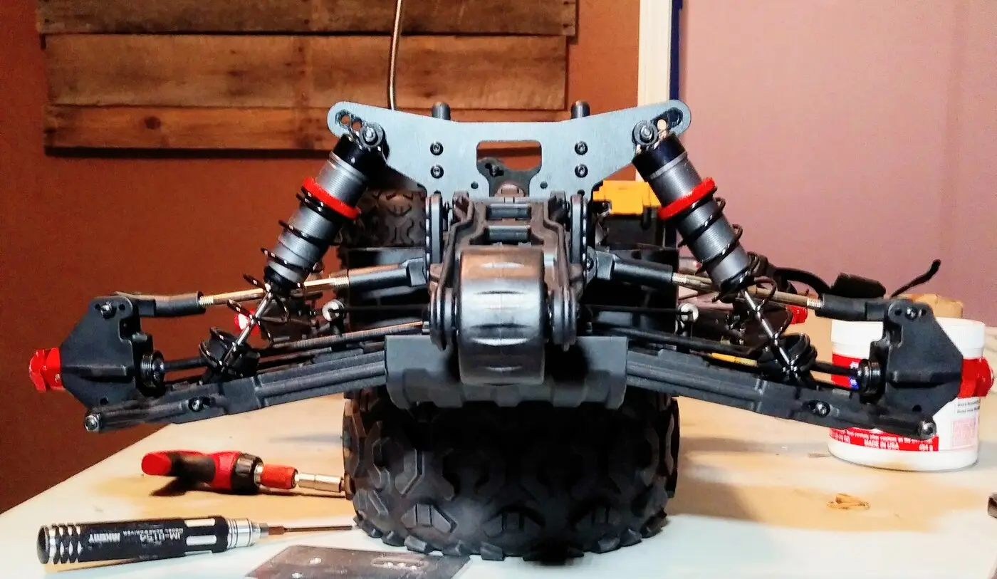

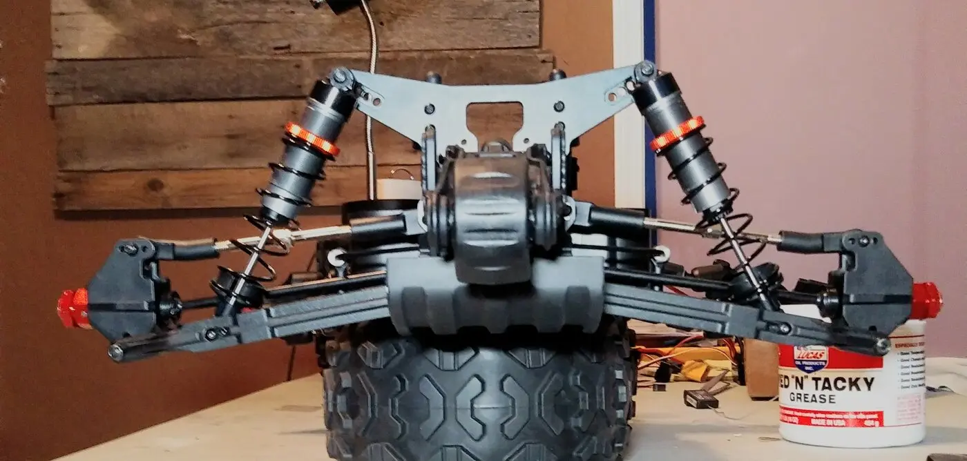

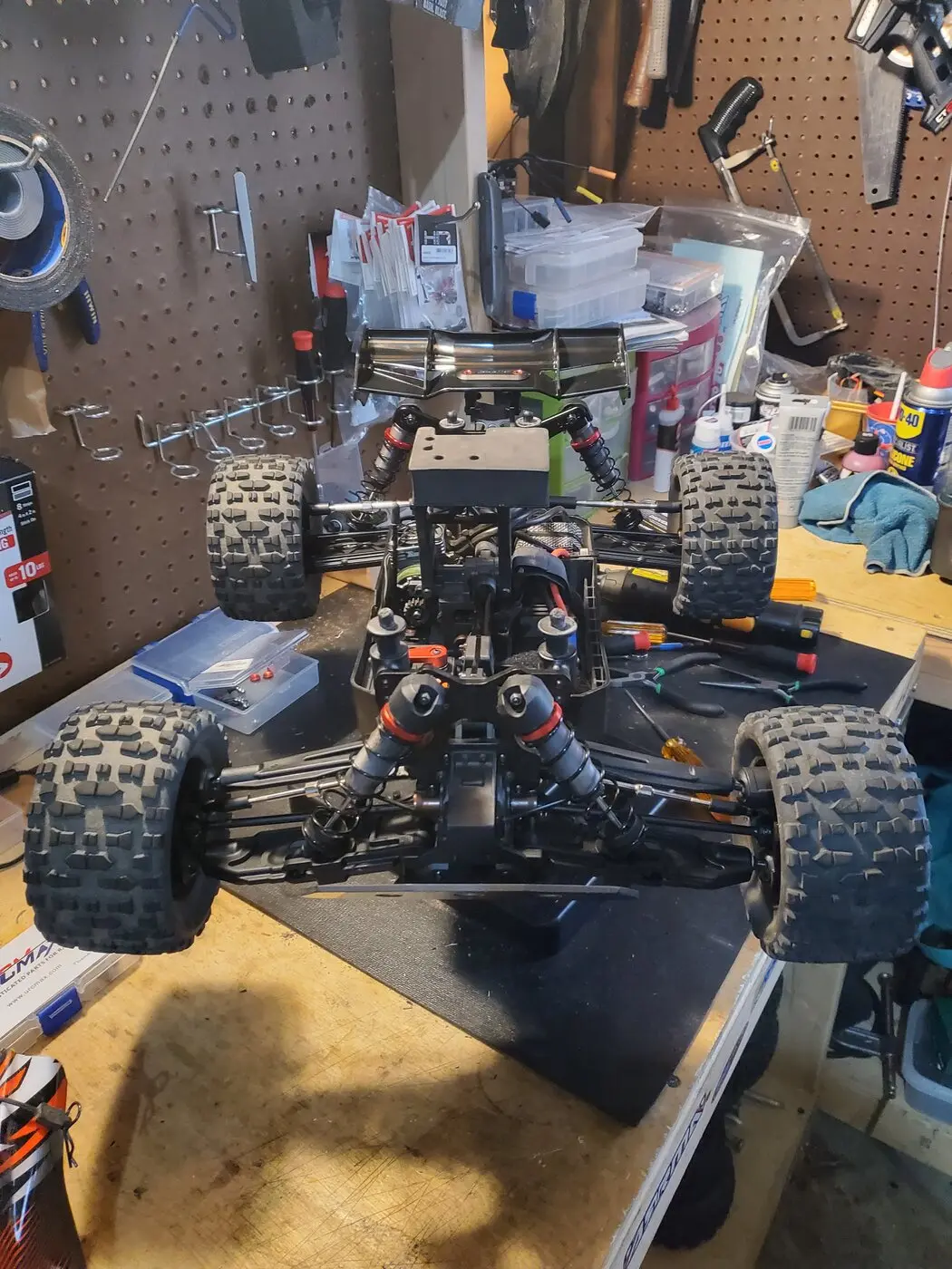

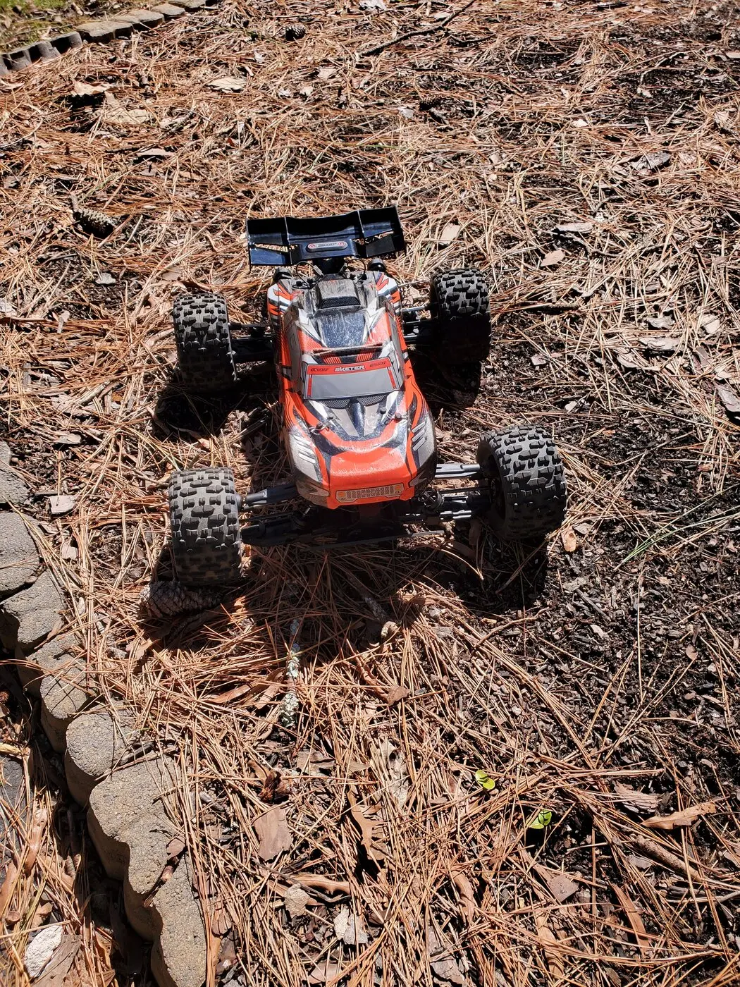

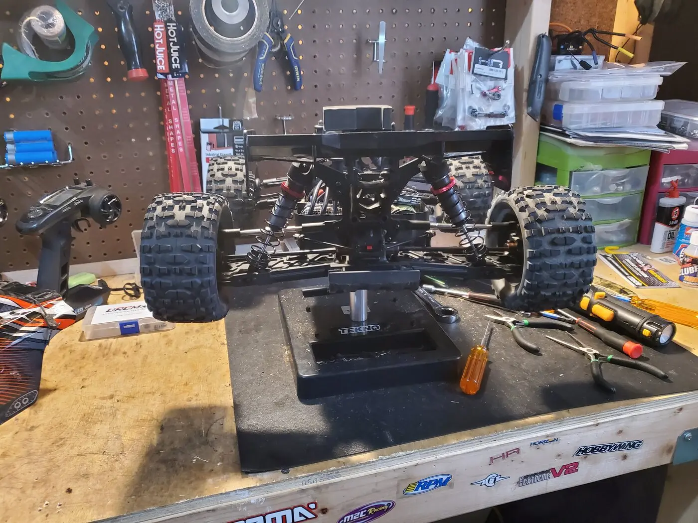

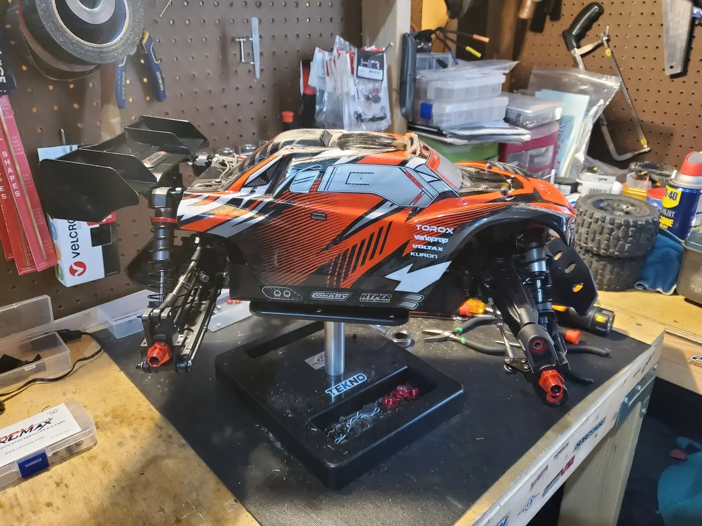

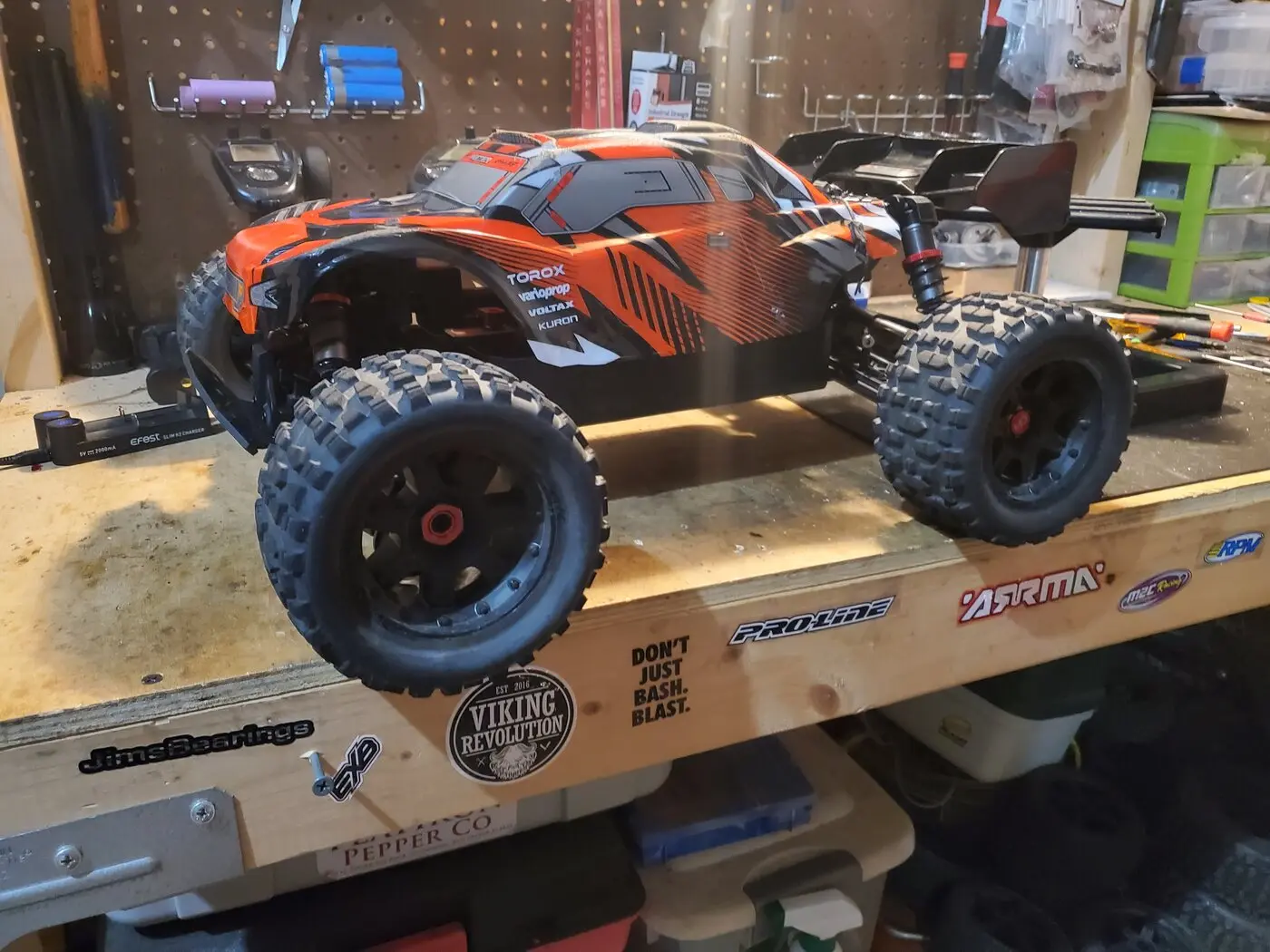

Ok, finished up with the wide build. Thing is a beast...tried my best to roll it, full speed on street and turning....just leans and turns, or slides. Really quick with the motor setup I have and back with the stock tires.
Added wing

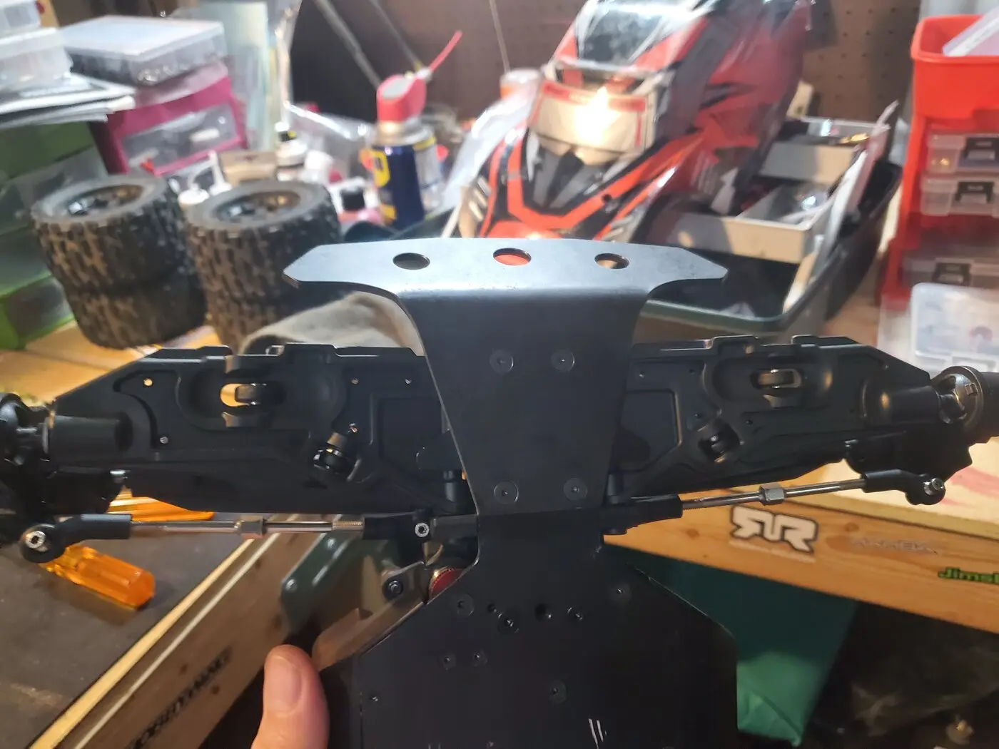

Tbone bumper

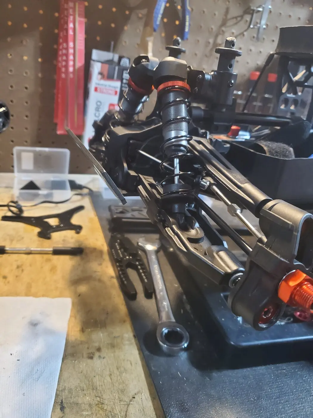

Kronos XTR spring steel tie rods

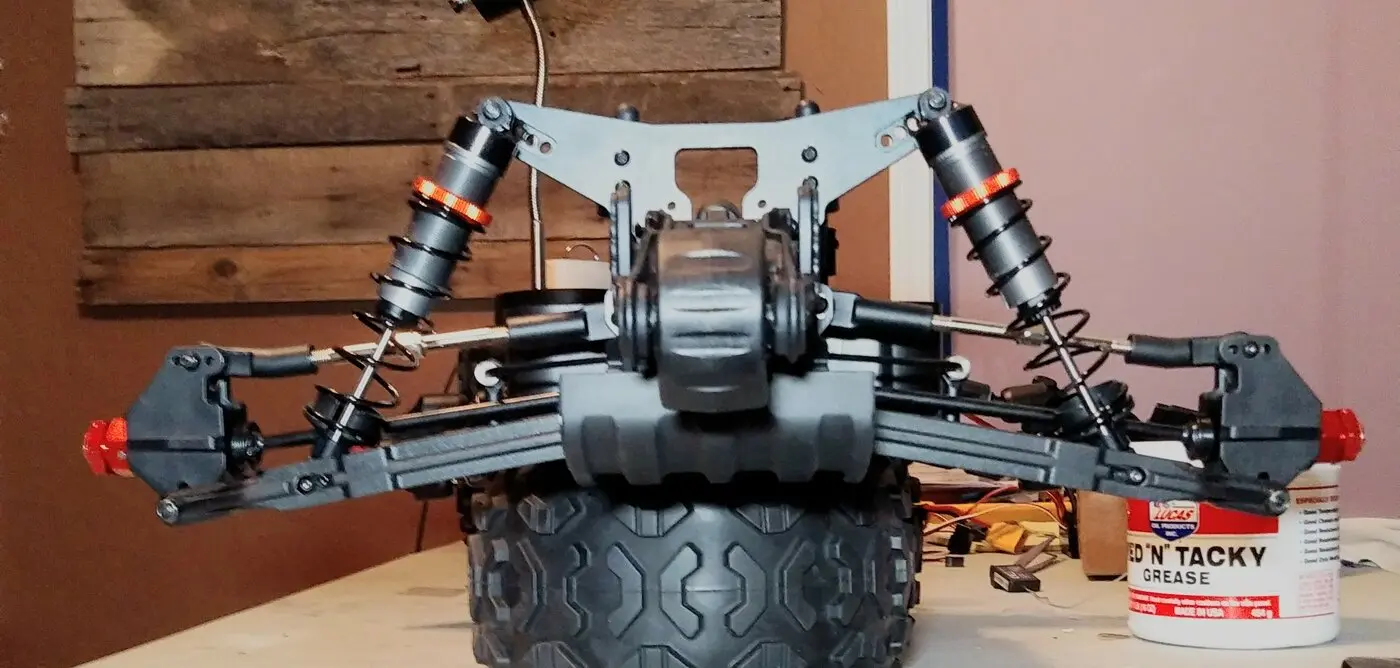

Dementor arms

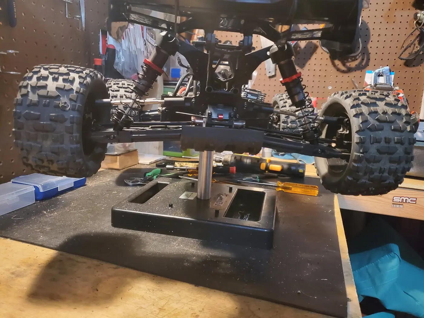

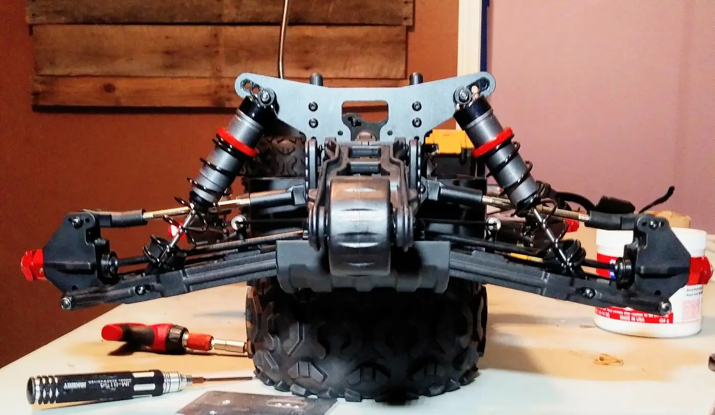

Dementor rear shock tower

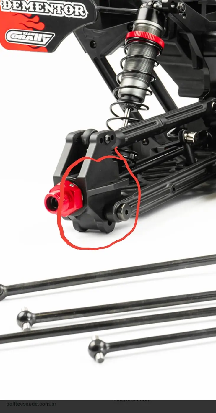

Stock Sketer front and rear hubs and short axles
Kronos XTR shock springs in rear.
Modified the Sketer body for now. Will have to use a truggy style body with how the wing is so close to the tower and shocks. Still looking into what body I am going to get.
The rear sway bar mounts to the arms perpendicular, not at an angle like the stock sketer. Used Arrma 6s sway bar link since it is split and the ends can rotate. Stock sketer link won't work, Arrma one was exact same size other than the ends can rotate. Works perfect.
Really happy with the results so far!
