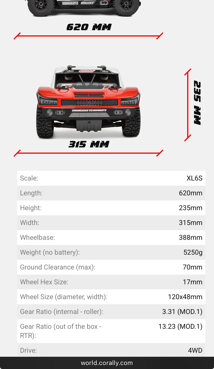

The shiroi is based on the kagama chassis, main differences being shorter arms & driveshafts, different shock towers, bumpers, side guards, bodyshell wheels & rear plastic chassis braces removed everything else within the chassis is same as kagama. To make a stunt truck just get a spark stick kagama shock towers & arms on it if that’s what you want.
You're right, I swear someone said it uses the Asuga but I didn't check until now.

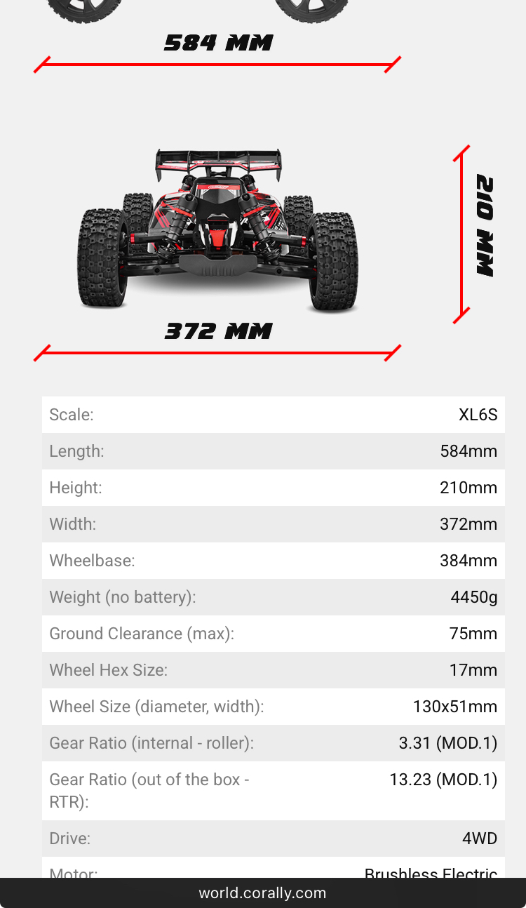

I think that was me. But i measured it and the Asuga chassis is ±15mm shorter than the Kagama's and Shogun/Muraco/Kronos's.
Almost none of the earlier aluminium upgrades that'd fit the Shogun/Muraco/Kronos's chassis, will fit the Kagama's. And probably the Shiroi's neither.
No none of the chassis braces will fit but the rest of the 7075 parts corally do should fit. If you want to see what parts are compatible if you look at the technical specs of parts on corally site they will tell you what models they will fit but sometimes takes corally a while to update for new models. If want to see dimensions of models if you go into the corally world portal on their website you will get all that info.

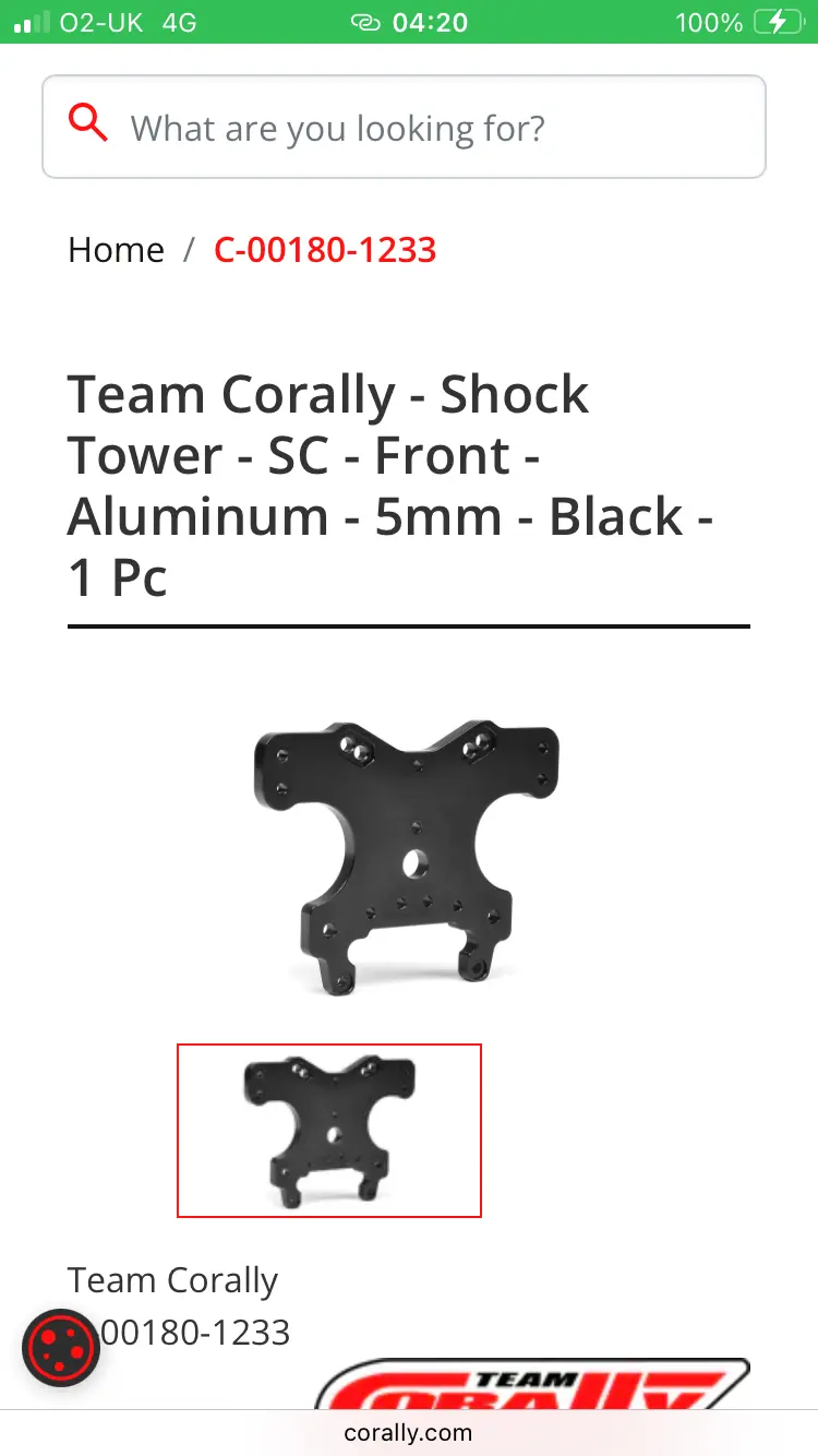

Before shiroi was released I spotted these shock towers on corally site I thought they were going to be for a sct but now it released & they not for it no idea what these are for or what sc could mean, stunt car , street car, idk 🤷 Bracing for the spark adu racing has that covered
