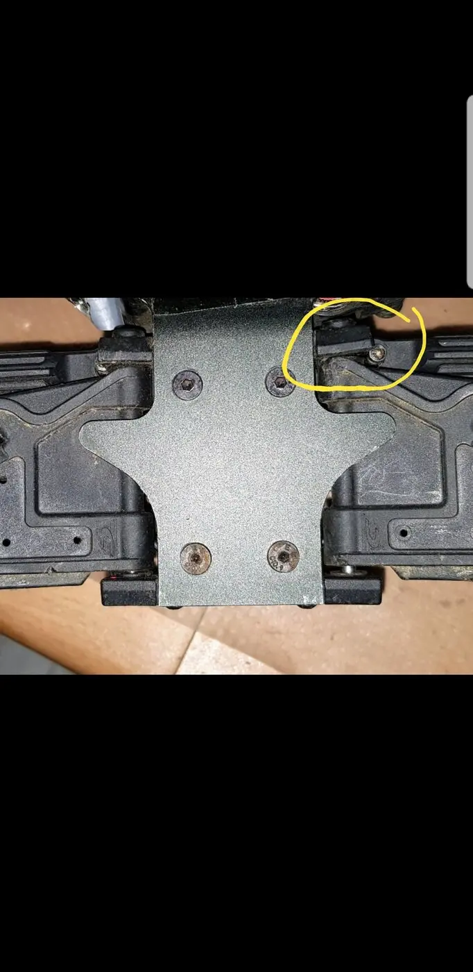

Perfect Thank you very muchLooks to be similar layout to the Punisher. The whole of the front diff housing will come off the chassis with 10 or 11 screws. View attachment 4717View attachment 4718

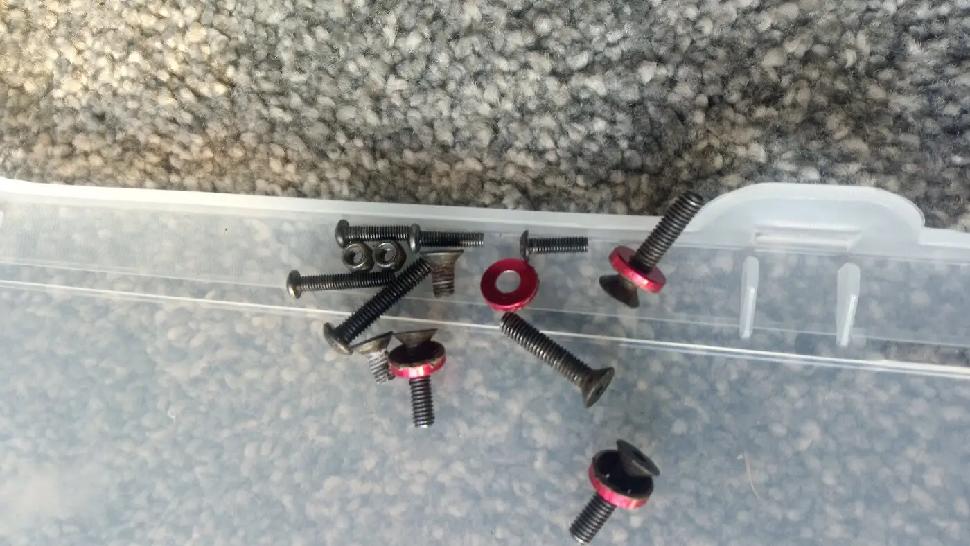

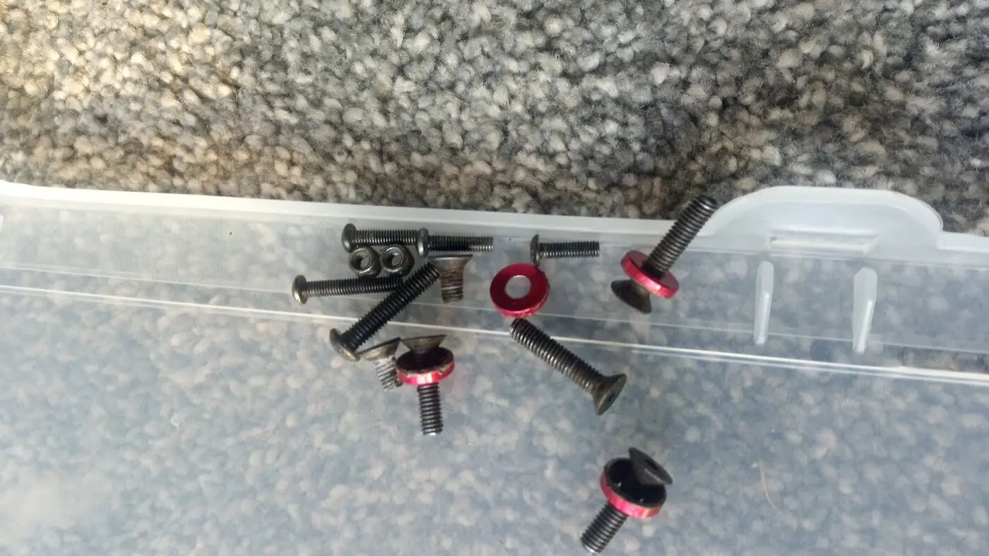

4 into the diff case.
2 into the steering posts.

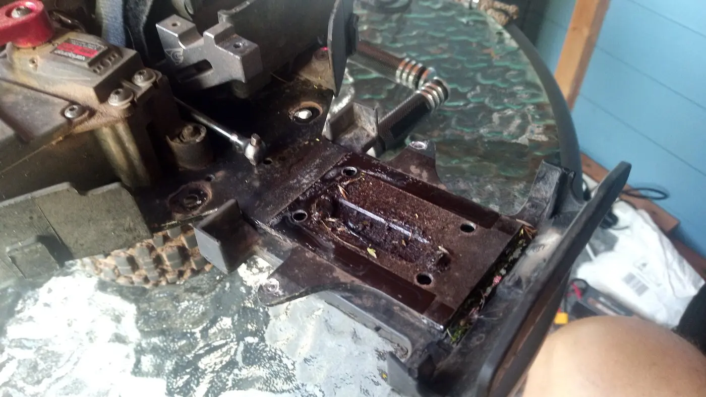

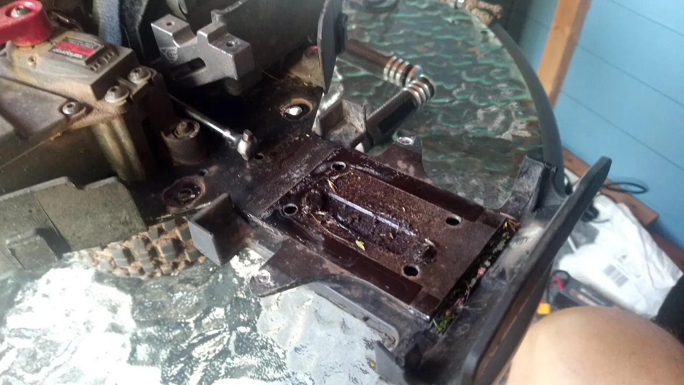

A couple of braces and the one holding the link to the servo arm.
The whole assembly (arms, tower, shocks, diff etc) comes off as one piece - it's really well thought out for maintenance and repair.
