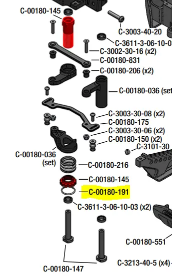

Thanks for the hint … we talk about the yellow marked O-ring in the drawing below, right?
Sorry for this newbie question - but what is it for?

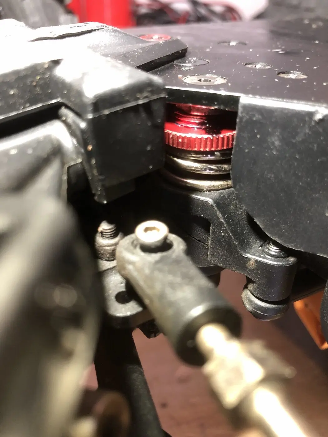

2-4mm vom Chassi bis zur Rändelmutter!!
Thank you Koma71 … I just measured 4.2mm - so I am a little at the stronger side, but that’s ok for me. I also marked the position with a black permanent marker to easily see if it will move again by itself:
