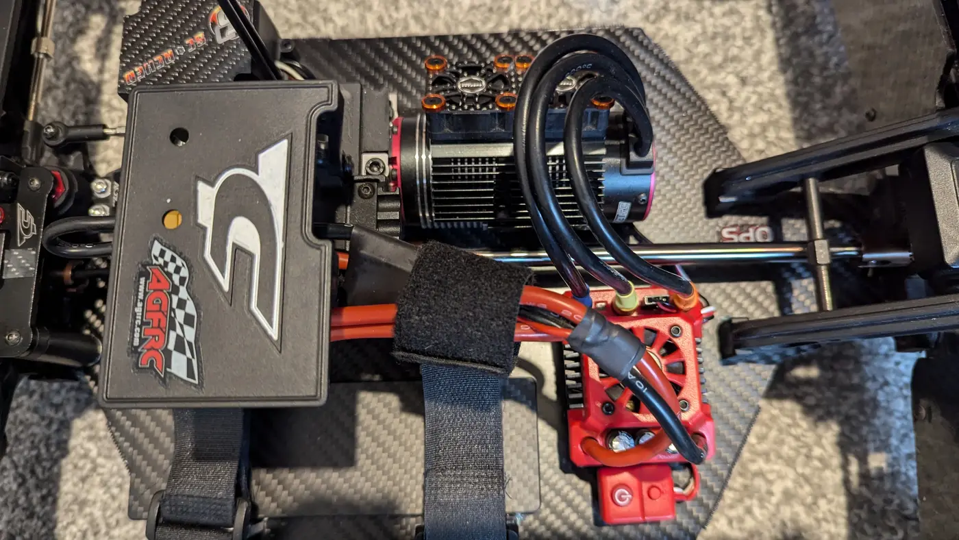

Below is a link to video of oscillation, hope link works.
https://photos.app.goo.gl/vPGoyh8vrDrRfBvJ7
Great - this shows that the rear drive shafts - for whatever reason - are too long.
I don't see how matters would improve when the car's arms are level - because then there's even less room for the driveshafts.

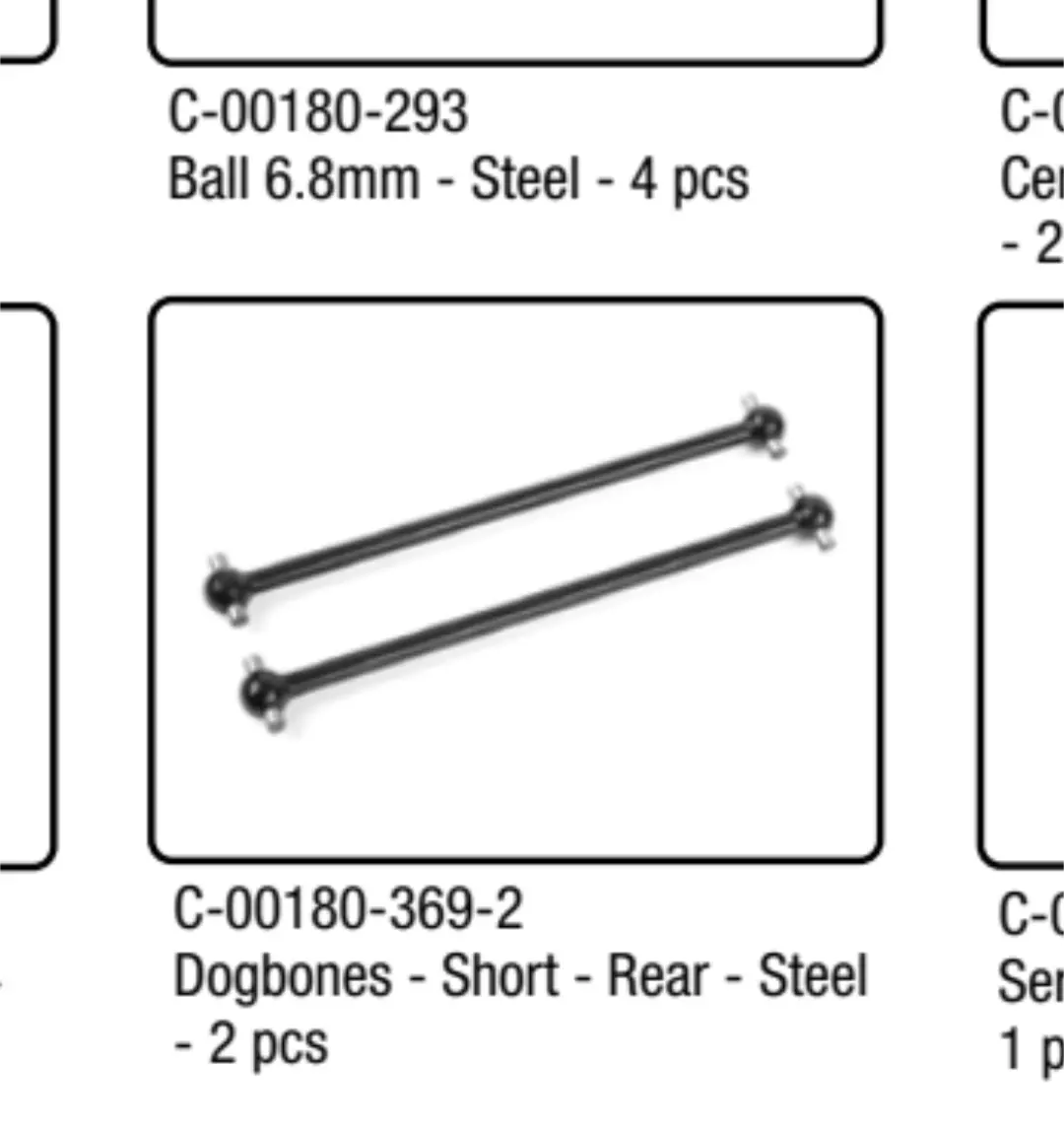

Would you mind going and helping some other people, and let people that own the vehicle at least feel like they can contribute? I feel that people might be reluctant because you ridicule and are argumentative. I want help, but not from you, thats as politely as I can put it.
Whatever you've got in there right now - they ain't working.
I note the numbers in the PDF manuals are different to the ones in yours, so perhaps they've amended them?

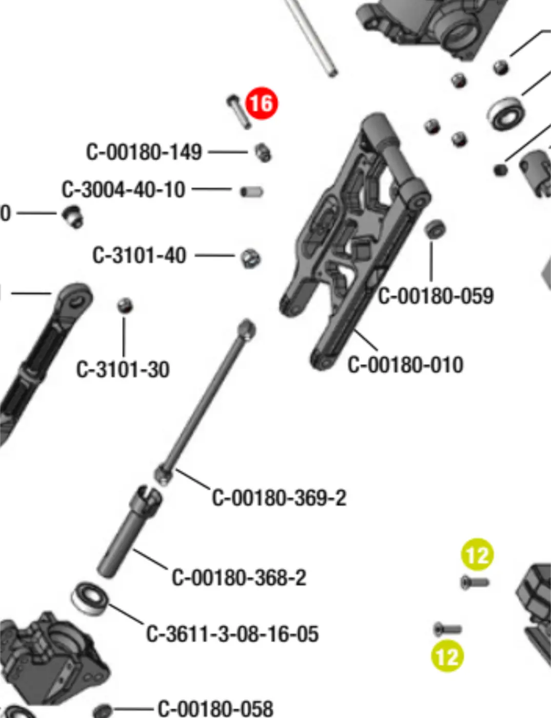

There isn't a listed upgrade for the rear driveshafts on Corally's website, not yet anyway.
For what it's worth, the centre driveshaft lengths in the Kronos manual were wrong too. But I measured mine with calipers between the pins, measured the ball diameter and found a perfect match with Scorched Parts titanium item.
While you're at it, you may as well check these out:

You replaced dogbones that you mentioned were faulty with CVD's that are quite evidently too long - even with the arms at full droop, they're pressed right to the end of the diff output and binding. There's no room for the pins on the dog bone end.
When you place that rig on the ground, with level arms - matters will get worse - not better. The shaft will have to bend to accommodate, because the hypotenuse (at droop) is longer than the base (arms level).
