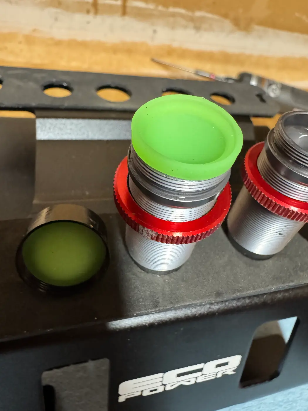

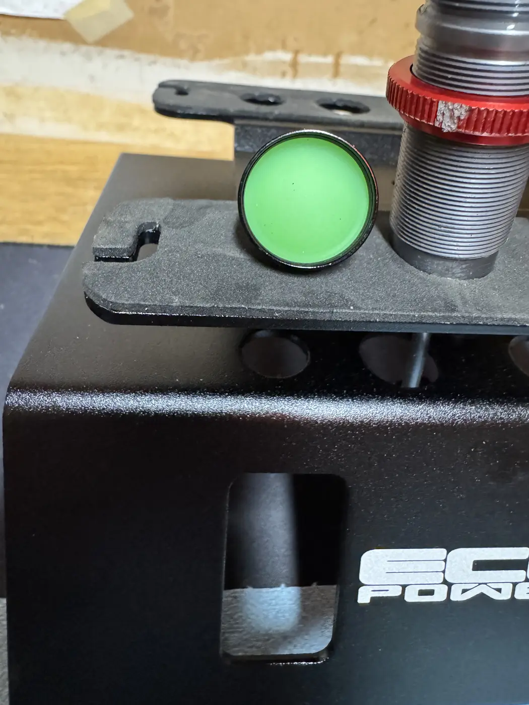

What helped out chassis slap a lot on both my Kagama and Spark is to replace the corally bladders with Traxxas ones meant for their maxx line of shocks. The corally ones allow oil to leak past, allowing too much air in the shock. This causes the shock to blow through the first 1/3 travel too fast which allows the chassis to slap.

The manual lies shocks come with 600 cst oil from the factory. Also the Traxxas shock bladders work better than the Corally ones which often leak air even on first use.

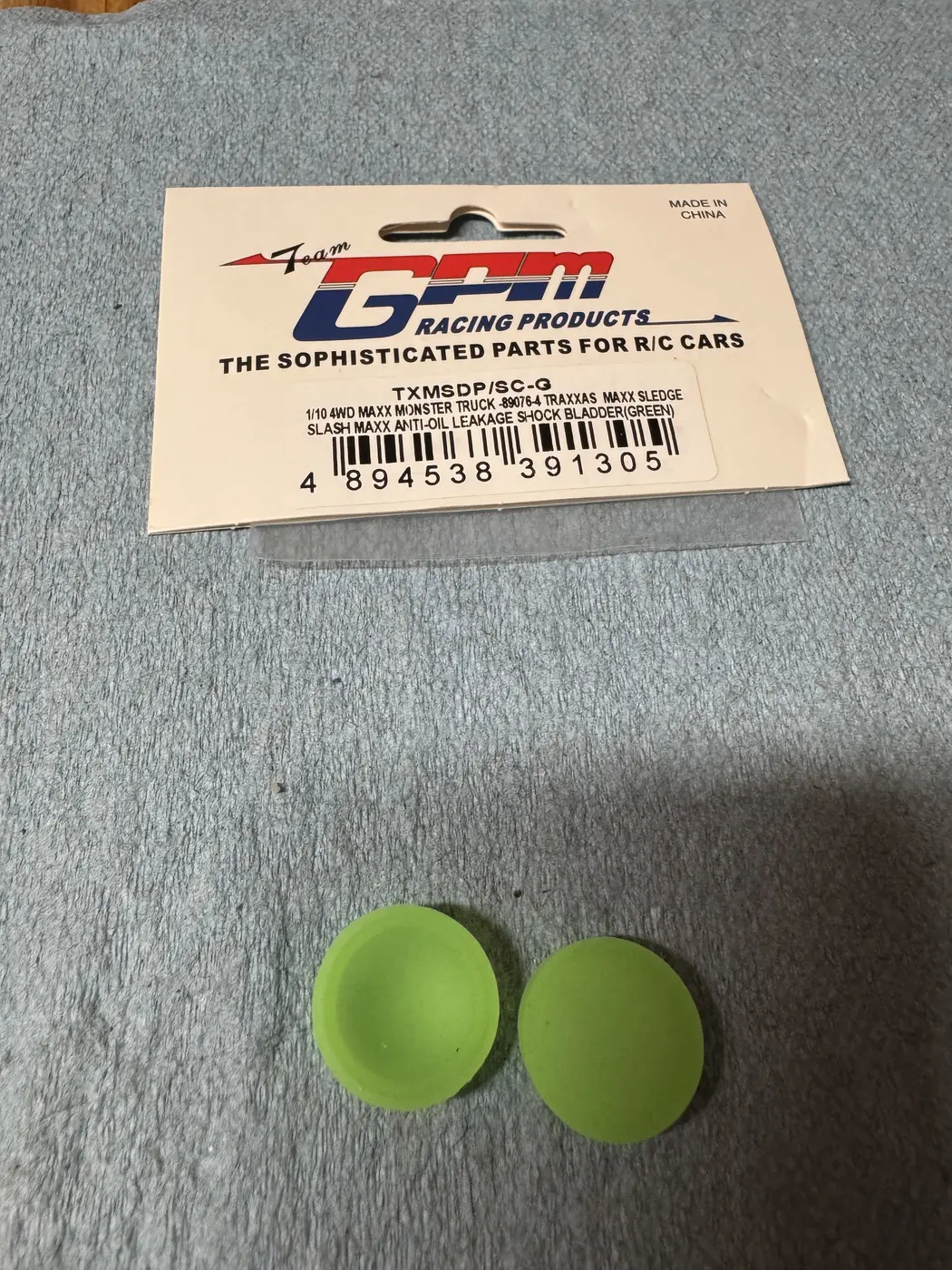

Thanks, any idea which part number for traxxas please?
GPM Anti-Oil Leakage Shock... https://www.amazon.com/dp/B0D97XS4SM?ref=ppx_pop_mob_ap_share
Brand: GPM
Model: TXMSDP/SC
Thanks for that, it says they are not available to ship to my country (uk) do you know if the standard traxxas maxx bladders would work? I could get them quite easily i think
Search for the following in your country.
Brand: GPM
Model: TXMSDP/SC

The M2C ones leak out the bleed port for me. They should come with a nylon washer to seal the bleed screw.

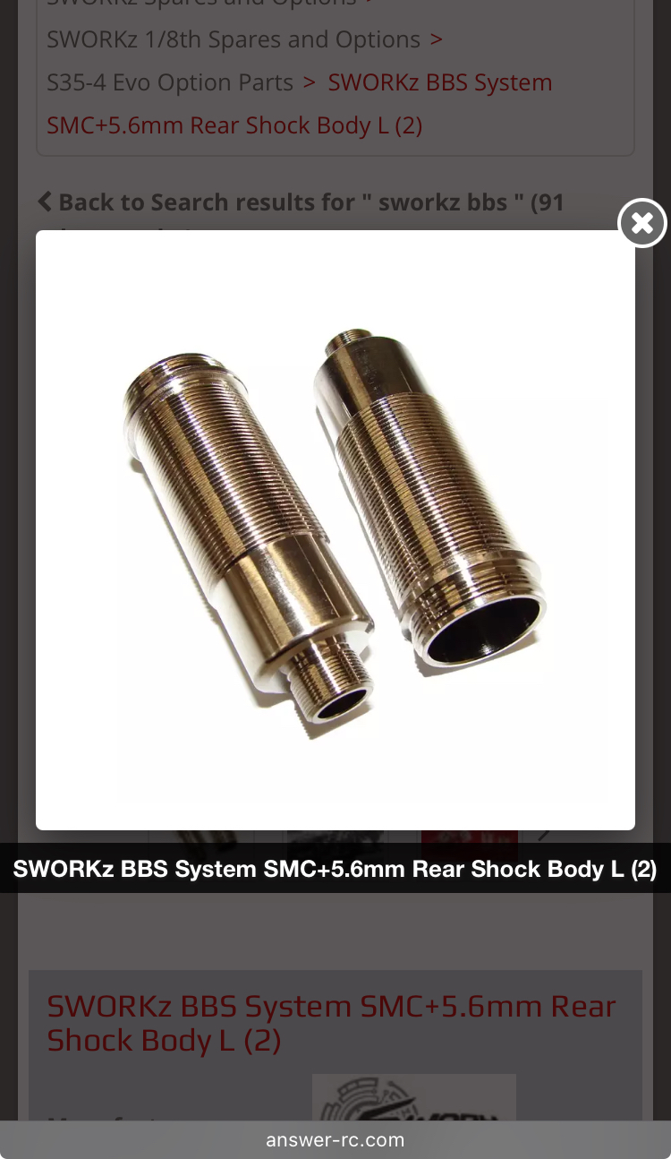

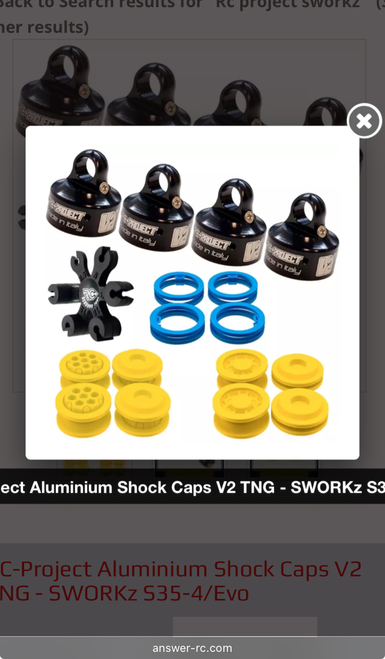

Rc project have washer, I’d love a set of them on sworkz bbs shocks with the smc (super mirror coated) shock body but you’d be looking at over £250 for it all 😂
