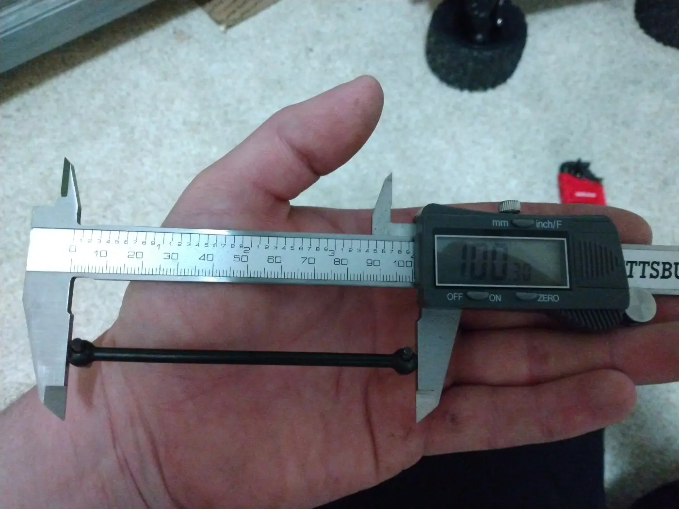

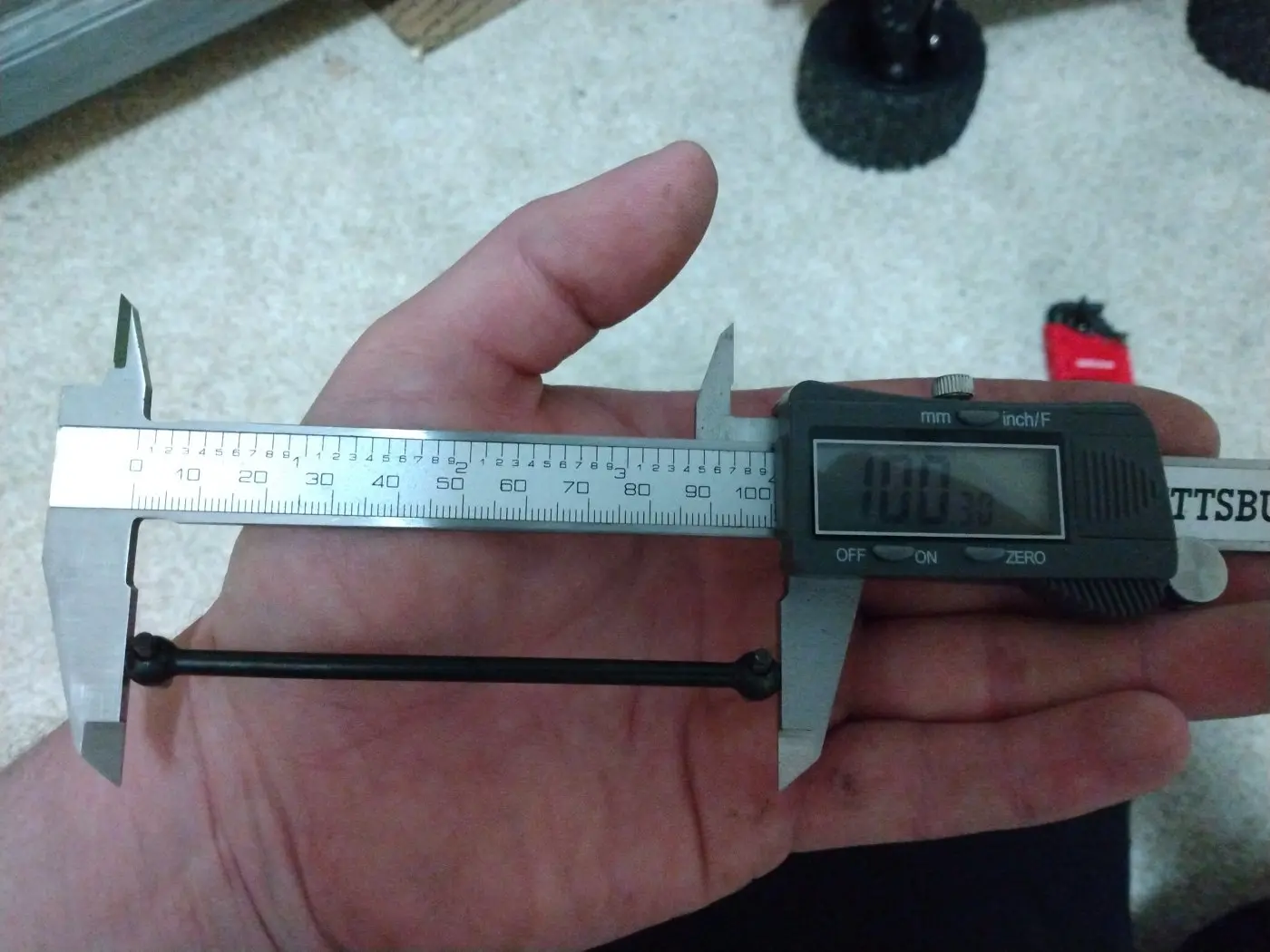

So while my esc is out for warranty, i went through and took care of all the diffs. While putting the rear diff and axles back in. I found that the axles bind if i turn them with no load on the suspension. Like they are too long, squat the suspension and all is smooth. Put it all back to the way it came. Not sure how i should correct this, adjust camber?

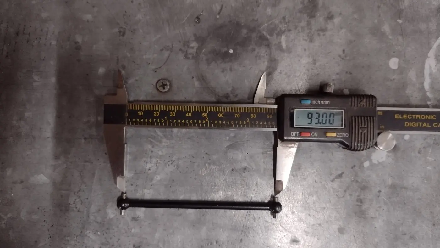

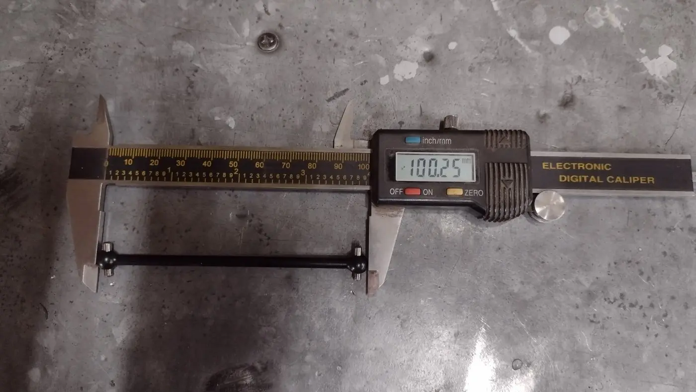

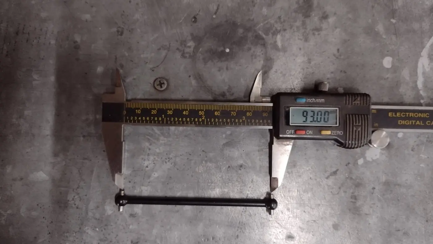

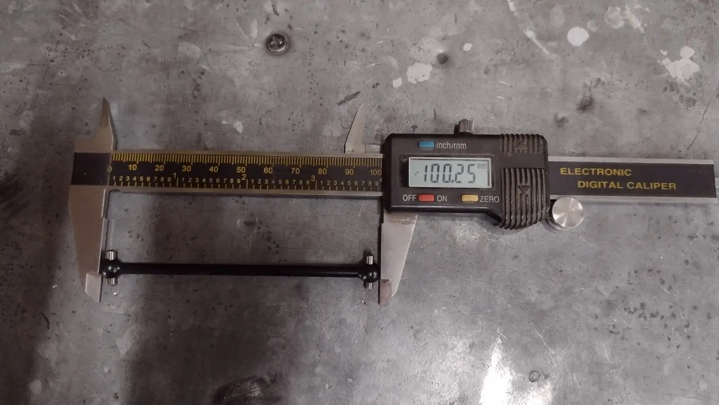

So hrp says the rear dogbones should be 93mm. Mine are 100mm no wonder they bind

Even then they are still over 93 mm.. i think they were 96mm
Center to center of the pins. Just trying to save you a few bucks from ordering another set that'll be the same as ya got. I verified the measurements on some new in package stuff corally has the lengths labeled on, they base it of the center of the pins
Sent the same pics to corally, they are sending new ones. Will see how they measure
