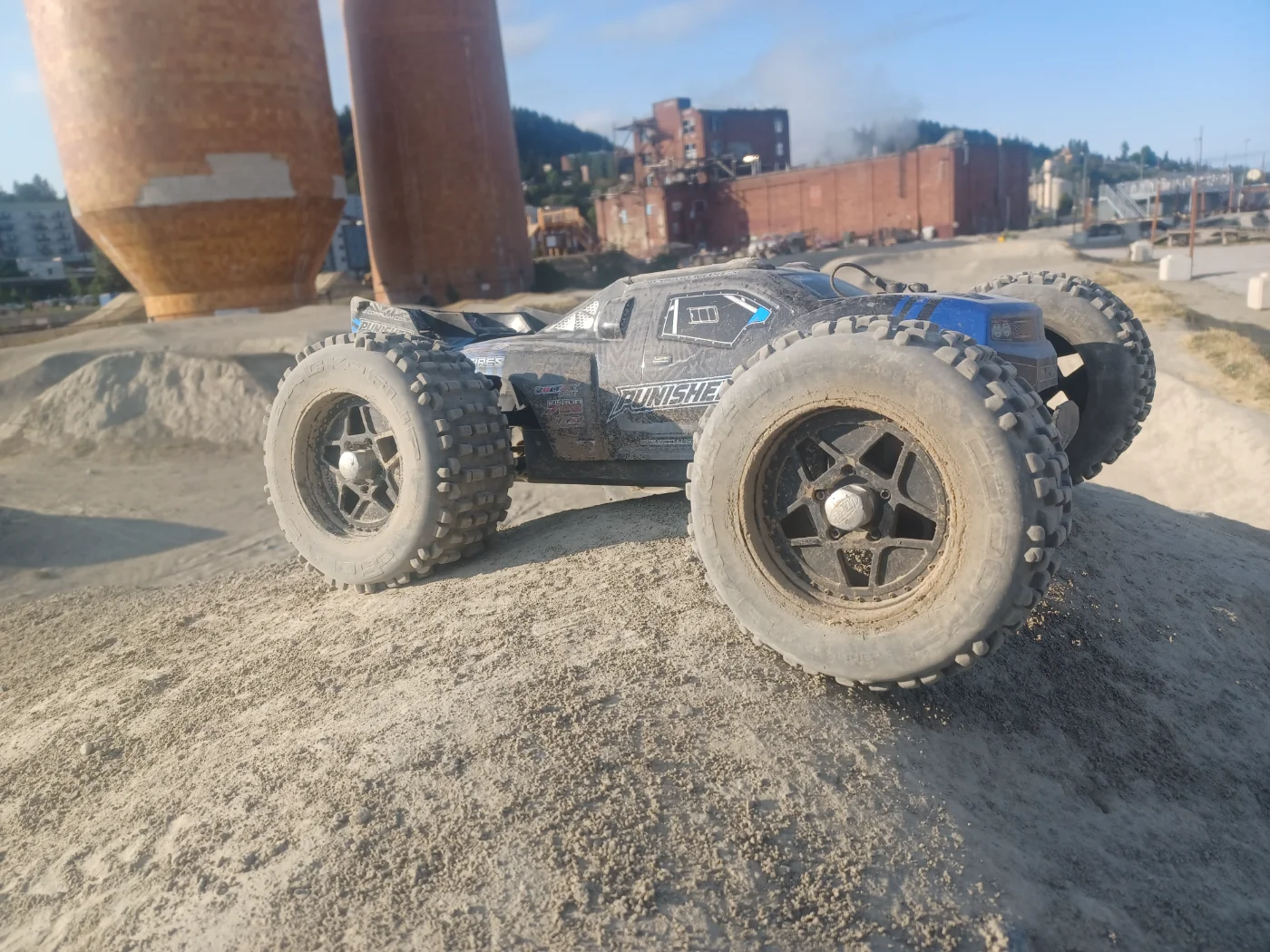

Better late than not at all.
You have to run Asuga arms or every time you hang a corner you'll drag the body with the front wheels. I have 10mm extended hex as well (when you adjust for wheel dish it's probably closer to 4mm).

HAHA, just asked for this shot in the other post. Looks good

wich pinion do you use? I tried those tires with the 15T but got strange noises. No problem with the 13T

The strange noise is probably because you're running your gear mesh on the very tips of the teeth. Go to a 14 in the 13 slot or a 16 in the 15 slot. This will get your gear mesh where it would be if you had set it yourself.
Ok, I run 10mm hex extenders and cut out the body to get rid of body rubbing. Will try the 14T. Is your car more of a stunt truck now with the 6S system? I assume you run 6S?
