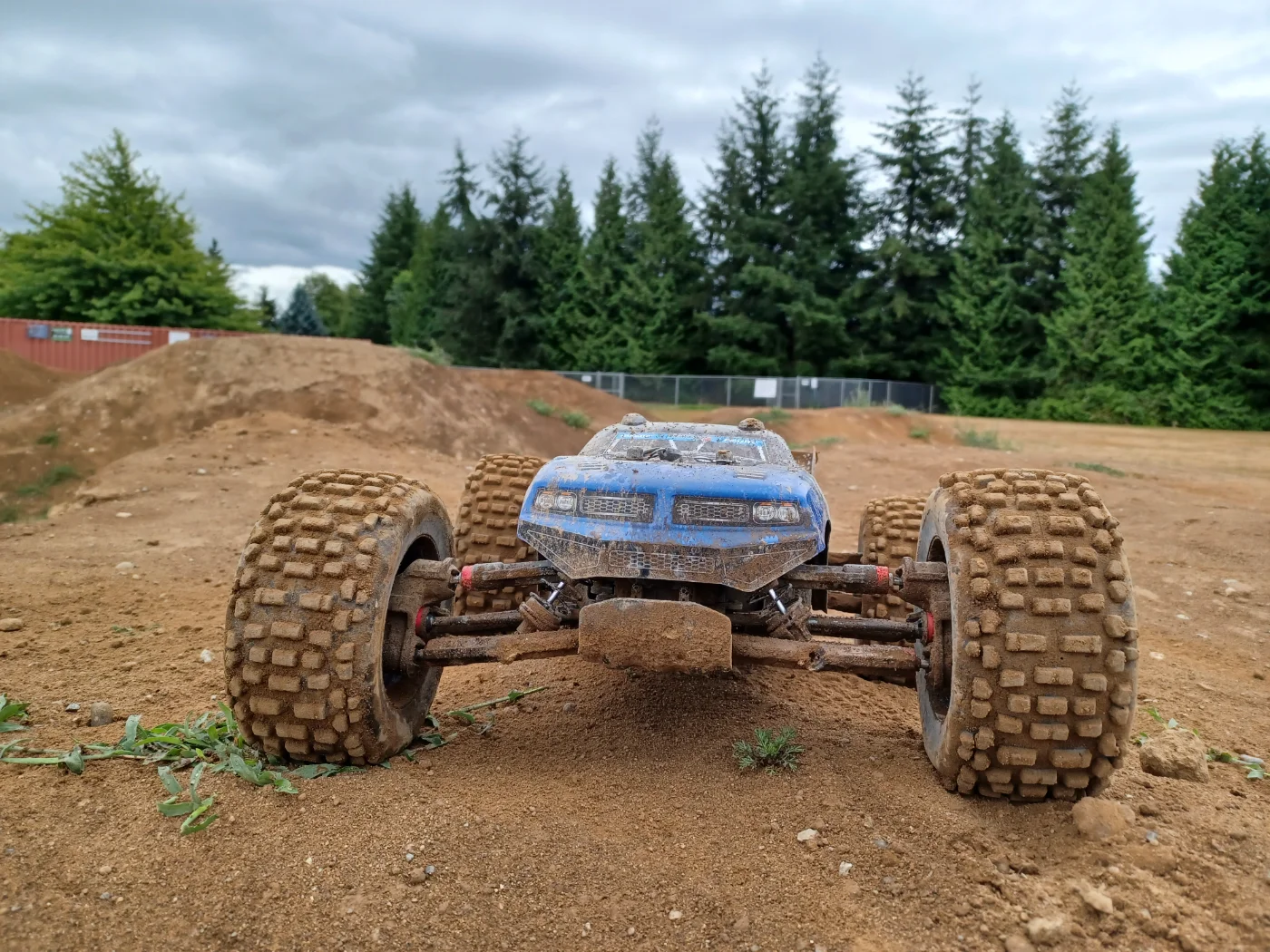

I have Asuga arms on my Punisher. The upper arms require trimming to fit. I ground the backsides off of the inner mounts till they fit. I probably got the same idea from the same video. The wheels are Arrma 6s Backflips.

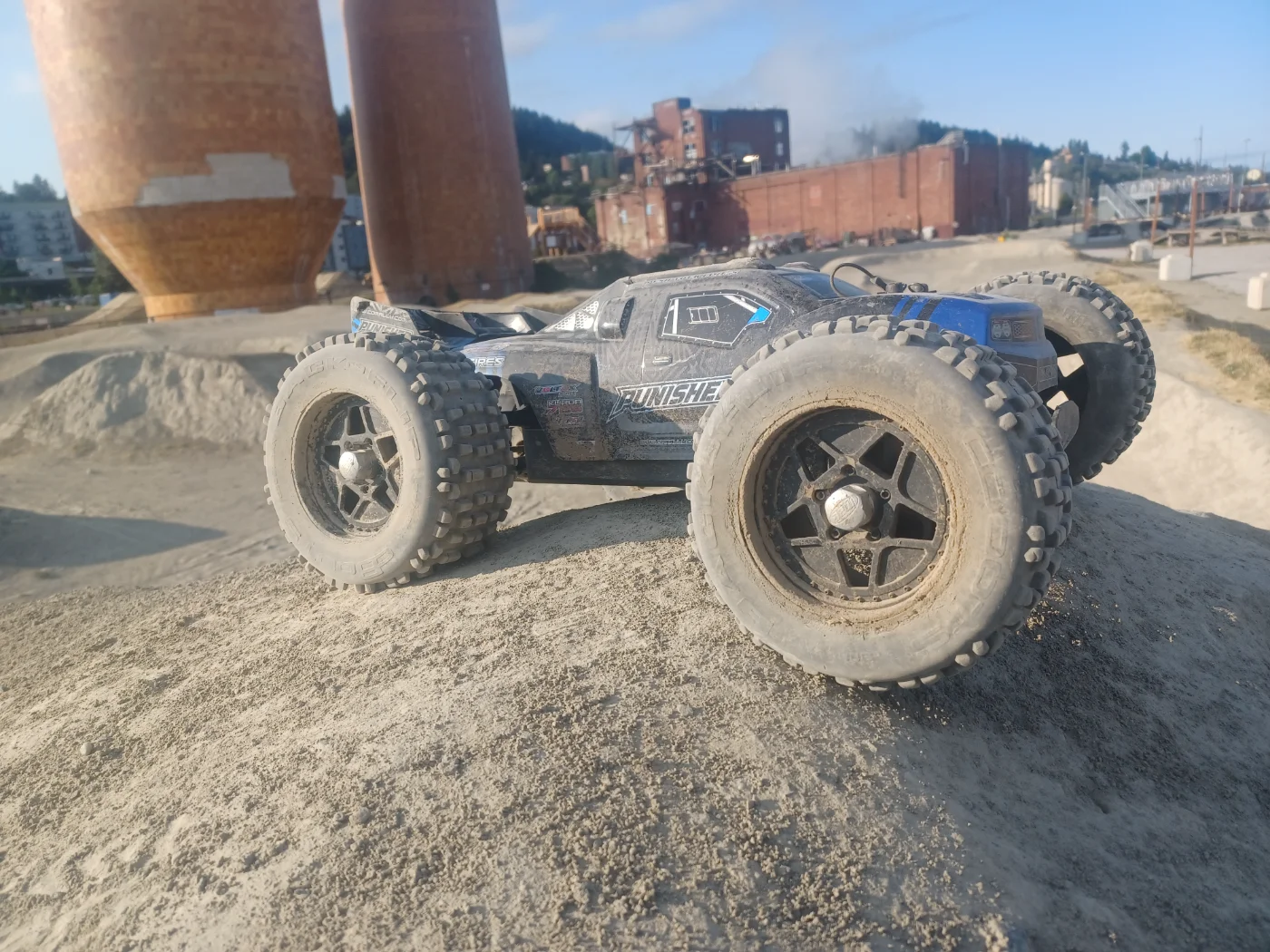

Nice!!!! Any side shots? Also, what ya do for gearing? Mine with stock tires or with my Hyrax tires that are a smidge smaller running a 15 or 16 to pinion loves to run hot. Thats with fan motor etc.....
I run a 2050kv truggy motor and a Castle ESC with a 16t pinion and 6s Backflip wheels. The stock electronics were pulled out before its first drive. I've been at this for a while and my junk bins are well equipped.

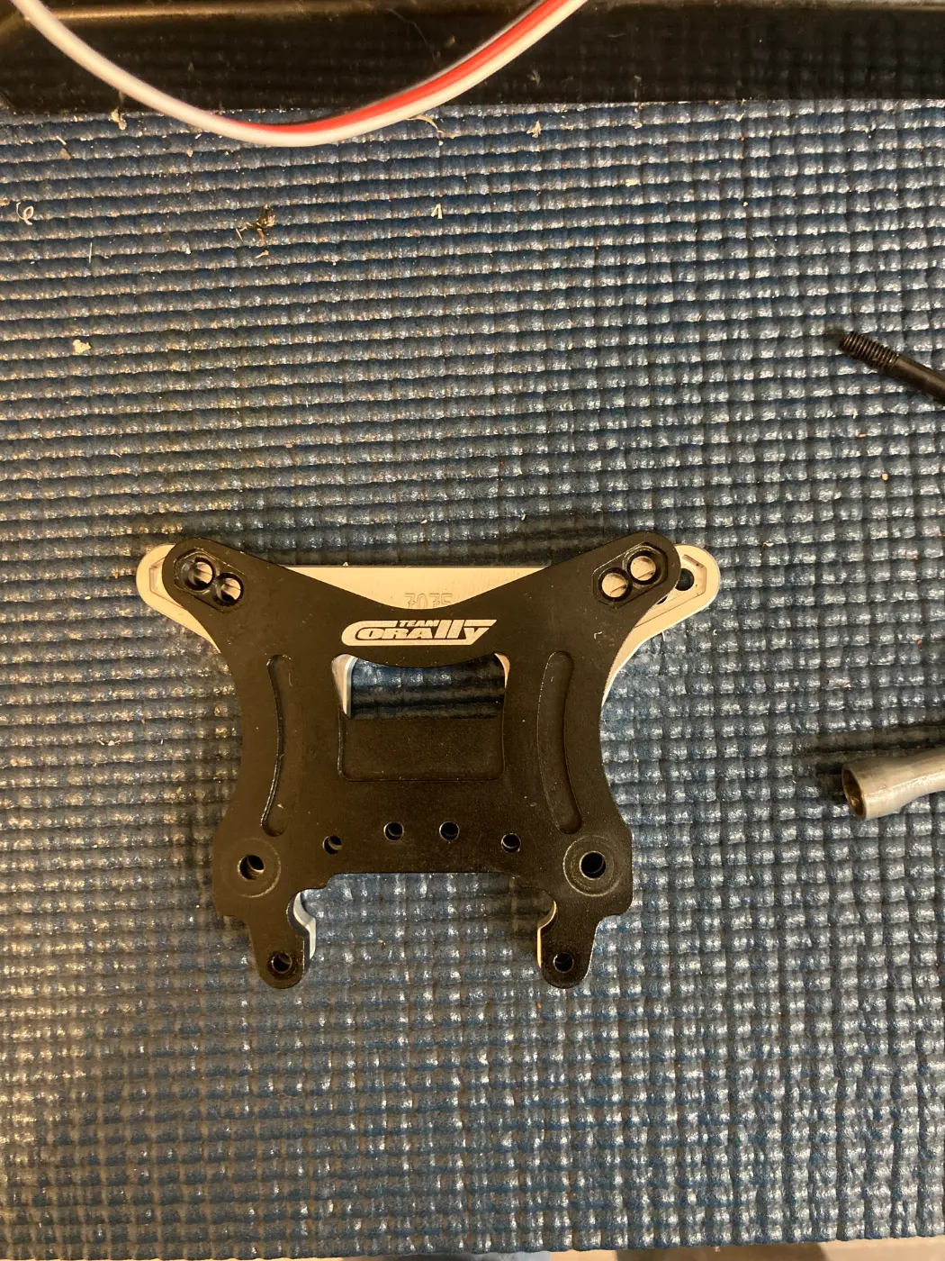

I was replying to the thread not to you specifically but your not necessarily correct, if you’ve fitted Asuga arms but not changed your shock towers, shocks , bracing etc if look at pic (Kronos/asuga) can see shock towers from vehicles with wide arms not much different geometry to Asuga so prob get away with wide arms too if wanted to without changing everything else
