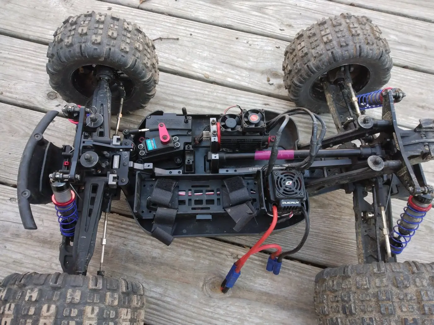

I think you could potentially fit an Arrma kraton "super basher " bumper..or whatever it's called. Also, the RPM kraton front bumper could be fitted..
I lifted this photo from @Caleb90 .. maybe he can provide details?
https://www.corallyforum.com/threads/first-6s-run-complete-failer.636/page-5#post-10757
