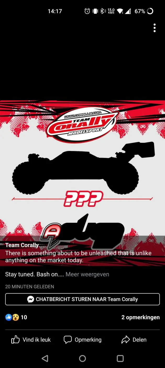

I'd be up for that, of course that said it could be a 1/10 scale too, who knows. They got us all excited a while back and it turned out to be a pan car, great for those into that but most of us here were a bit let downCould be 1/5 scale buggy? Might be cool. It says like nothing else on the market.
True, I’d dig that.I'd be up for that, of course that said it could be a 1/10 scale too, who knows. They got us all excited a while back and it turned out to be a pan car, great for those into that but most of us here were a bit let down
A lot of peeps do that with their buggies, it would make sense.Tires look big to me. I say a 6s 4wd buggy with truck tires.
Same. 1/5 would be awesome. But 1/8 is also oke. Try and lift a 1/5 car back home when the batteries are dead. No experiences but i figure it is heavyI'd be up for that, of course that said it could be a 1/10 scale too, who knows. They got us all excited a while back and it turned out to be a pan car, great for those into that but most of us here were a bit let down

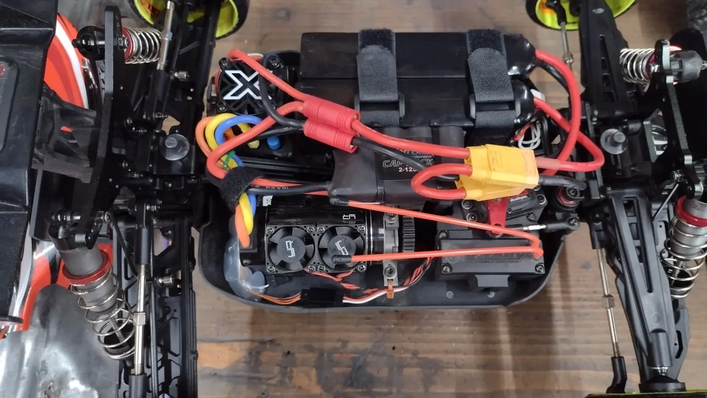

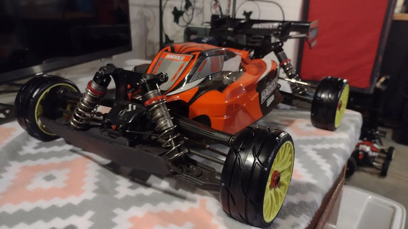

Behold!Depends how wide you wanna go, you can use kronos hubs/axles for added width but I stick with the radix ones so needed muraco/shogun cvd's/dog bones. Also need their shock towers and rear shocks, radix rear shocks can be transferred to the front, oh and rear sway bar from one of the lwb rigs
Once they're wide I will say you have to actually try to get them to roll, they become extremely stable, only reason I did it was because I drive to fast and always ended up on my roof when I turned, couldn't imagine going back now

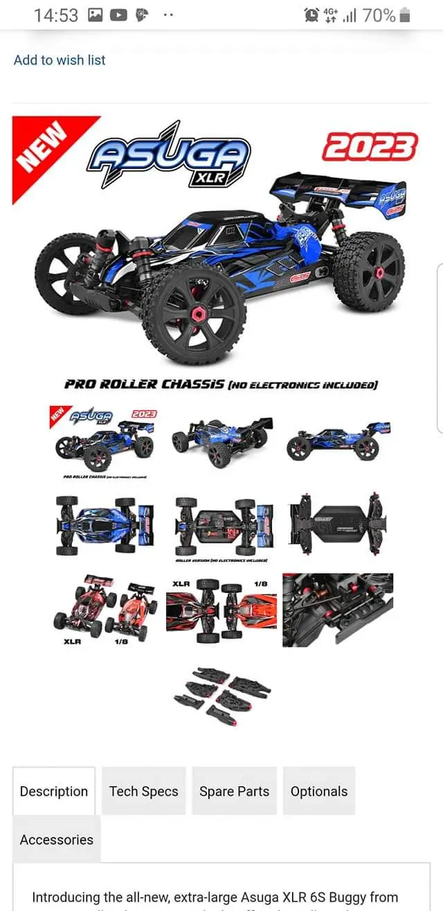

This it it.
