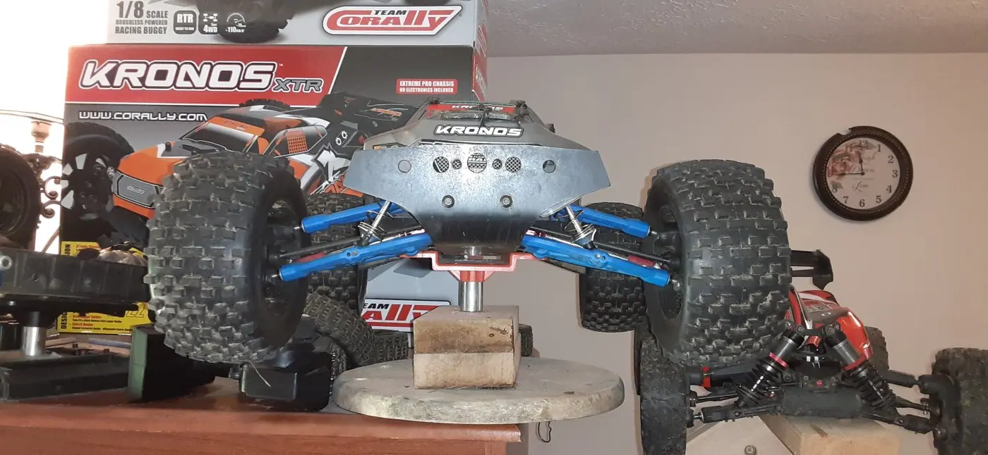

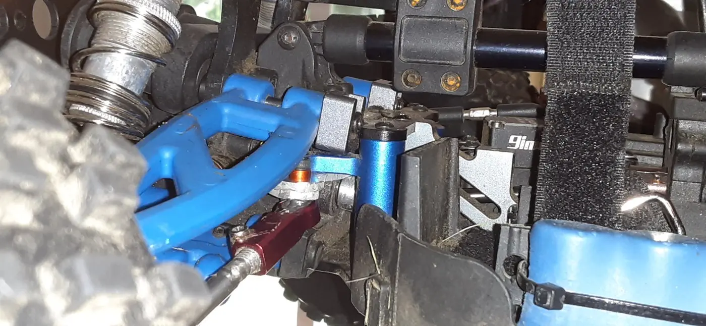

Kraton RPM front upper and lower arms. Rear arrma kraton exb arms . 3DRC kraton wing mount and talion wing. Wing mount required a lot of filing on rear shock tower.
I've been meaning to ask what all was needed to fit the kraton arms to the xtr..View attachment 2700View attachment 2701

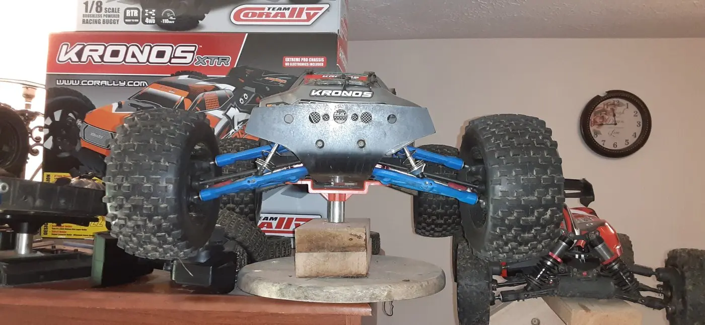

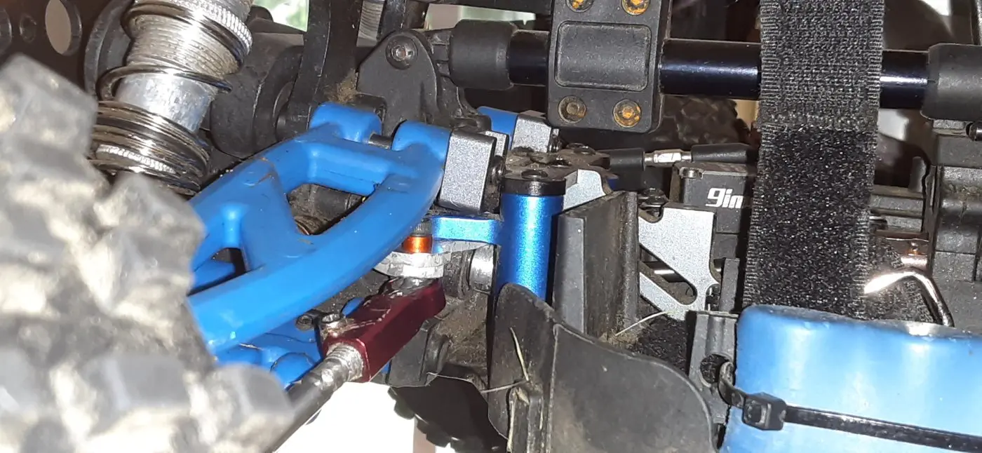

Oh my bad. I was just sharing the upgrades and changes I made. The arms fit fine. Front lower arms had to be shaved down by a tiny bit. Corally sway bar end links don't fit with out modification. I currently have rear sway bars only for now. The arms are a bit longer. So you need arrma kraton drive axles also. So I now got front and rear cvd,s. Used rear kraton aftermarket hubs and stub axles out of preference. Front is using corally nuckles still. Parts are surprisingly simularI've been meaning to ask what all was needed to fit the kraton arms to the xtr..

I also made a new steering linkage. Kept braking the stock oneI've been meaning to ask what all was needed to fit the kraton arms to the xtr..

Sweet man! I love customizing stuff like that bout to go hit the man cave now and see what I can replace my broken steer link with..Oh my bad. I was just sharing the upgrades and changes I made. The arms fit fine. Front lower arms had to be shaved down by a tiny bit. Corally sway bar end links don't fit with out modification. I currently have rear sway bars only for now. The arms are a bit longer. So you need arrma kraton drive axles also. So I now got front and rear cvd,s. Used rear kraton aftermarket hubs and stub axles out of preference. Front is using corally nuckles still. Parts are surprisingly simular
I found gpmkraton links on ebay. But you have to shorten the links a bunch. Kraton links are longer. I've heard kraton ends fit the corally,s. Prob the cheapest bet.Sweet man! I love customizing stuff like that bout to go hit the man cave now and see what I can replace my broken steer link with..
Definitely the cheapest and easiest. I put another HPI link on for now.I found gpmkraton links on ebay. But you have to shorten the links a bunch. Kraton links are longer. I've heard kraton ends fit the corally,s. Prob the cheapest bet.
So when I install the A arms I do not need to modify in any way??.View attachment 2700View attachment 2701
Not sure about Kraton arms but, pretty sure the Kagama arms are a direct fit. Much beefier than Kronos. Food for thought.So when I install the A arms I do not need to modify in any way??.
