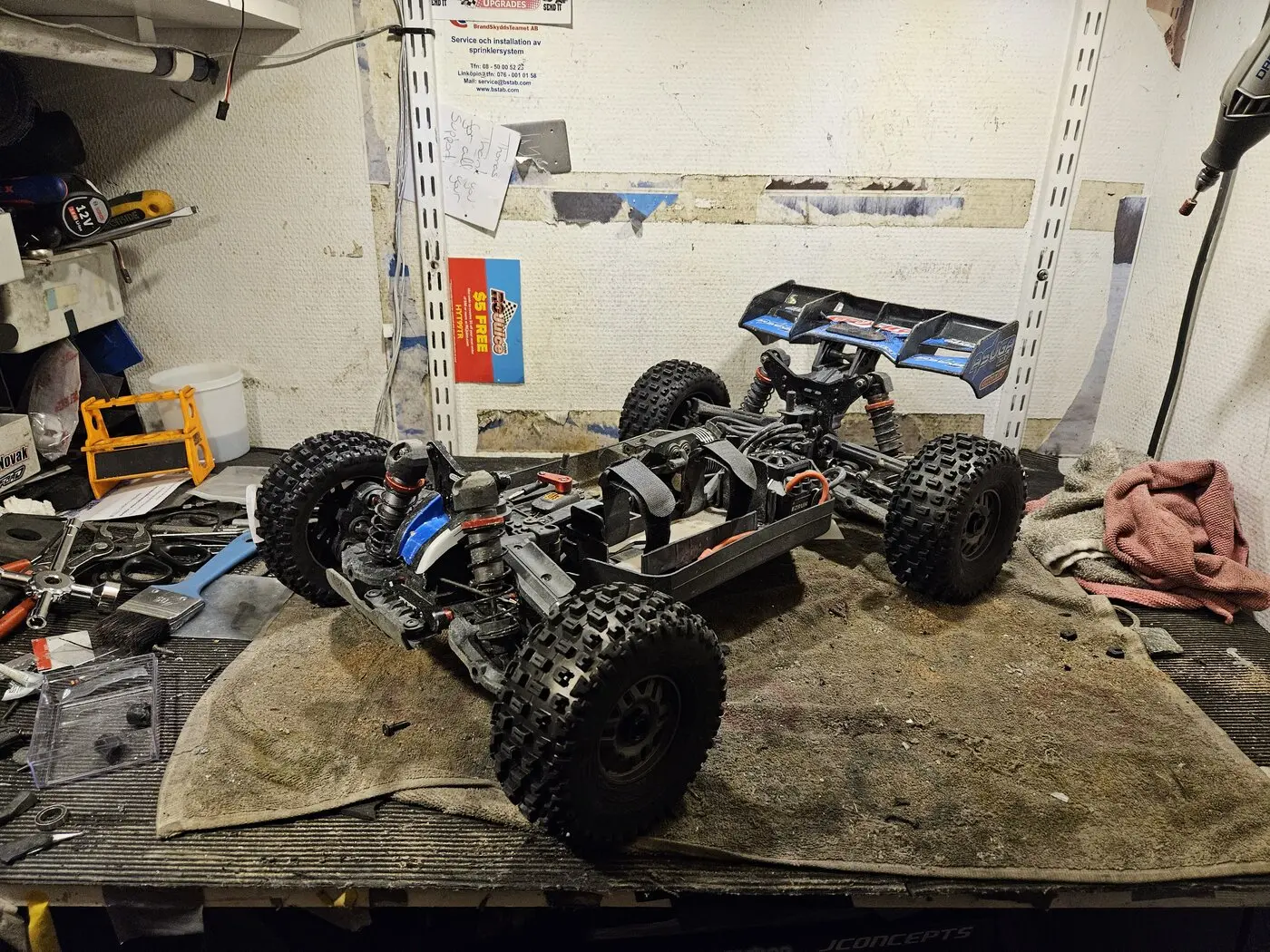

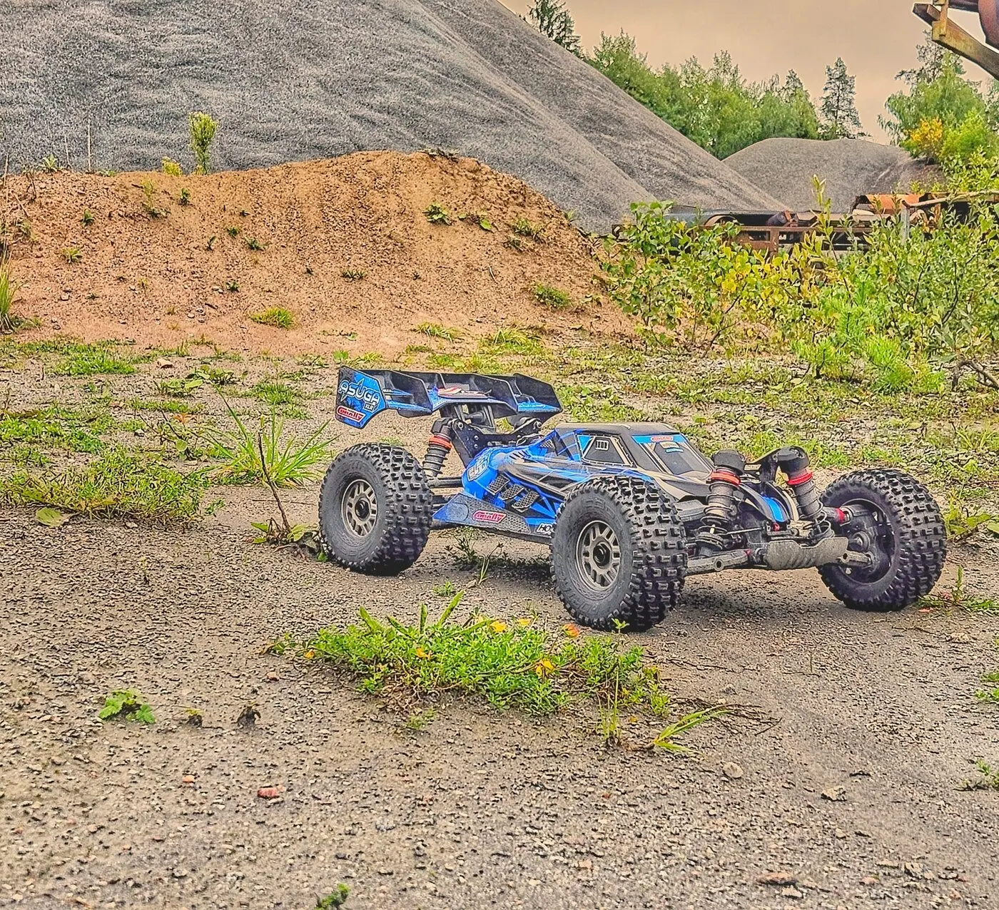

Had this masterpice for a while now..and i love it. Got the roller, using a max6/4985 ( will go down on motor later ) all stock..used UDR tires, but need a bit work to fit..so next up is the dBoots for Mojave, with extended hex.
Nice (y)

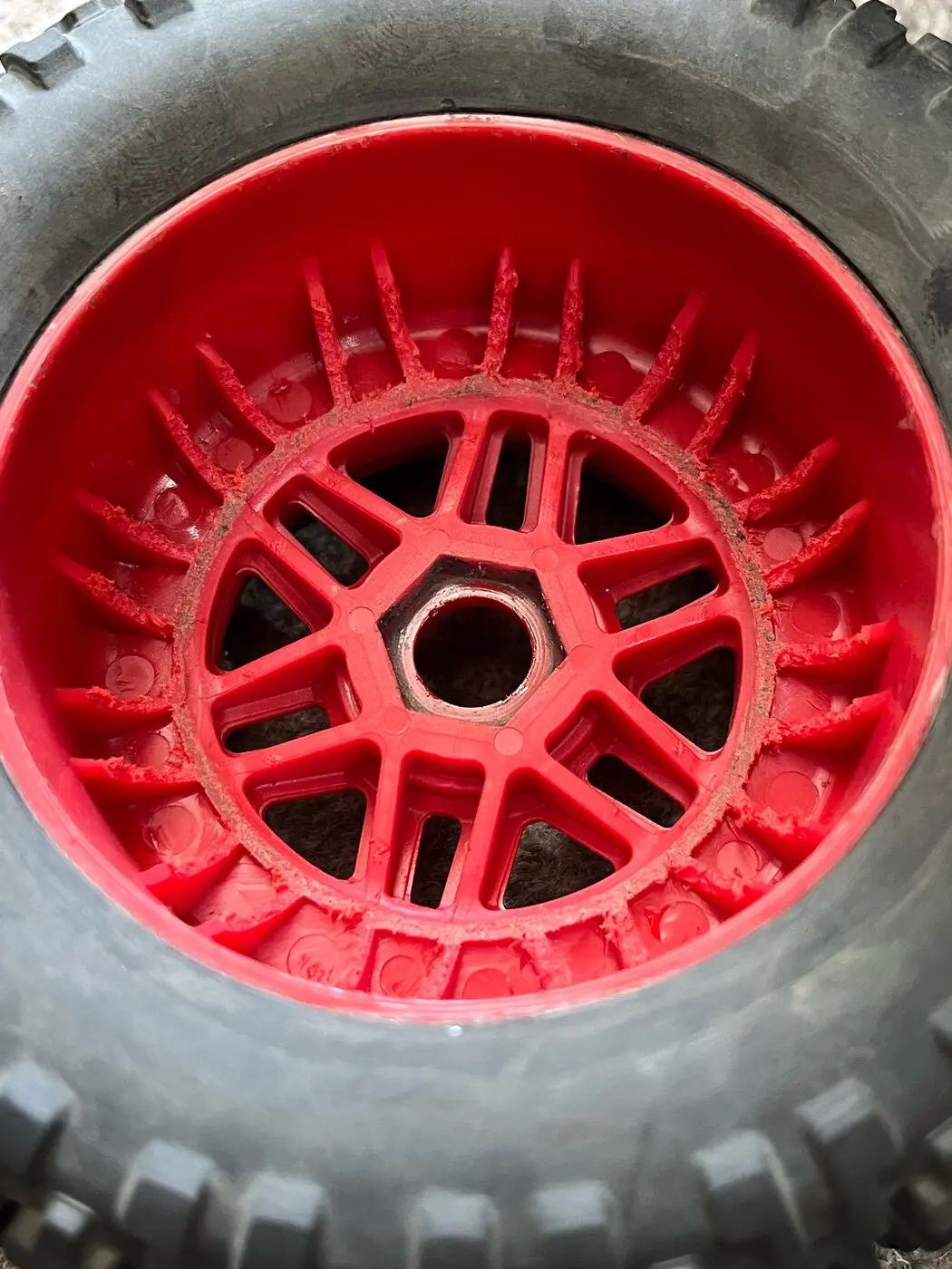

Does it need extenders to fit the Mojave tyres.??

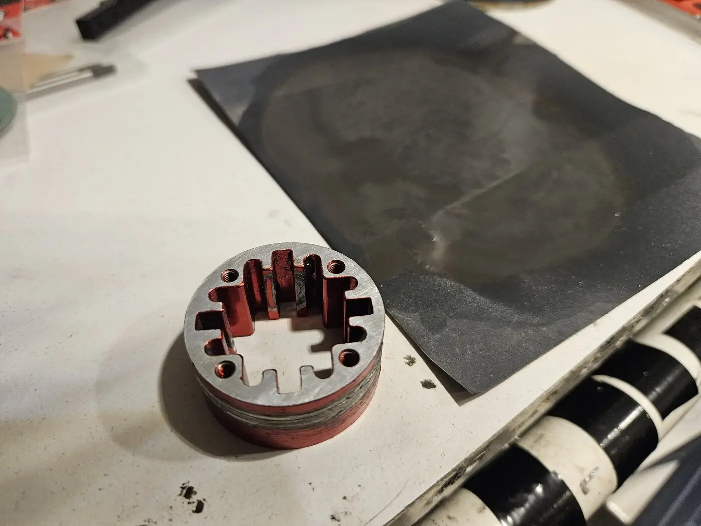

Ideally yes. This is what I did though, I sanded down some of the ribs on the inside of the wheels and removed material from the rear hubs. It’s not ideal but I wanted the car ready quickly. I’ve had a good few hours runtime with it like this and so far, no issues.
If it does have problems, I’ll be fitting the M2C 3160 extended hex kit.
For the Mojave, id say atleast 15mm..this is the ones i use and maks the car look goos imo. The handelinf are still mindblowing🥰

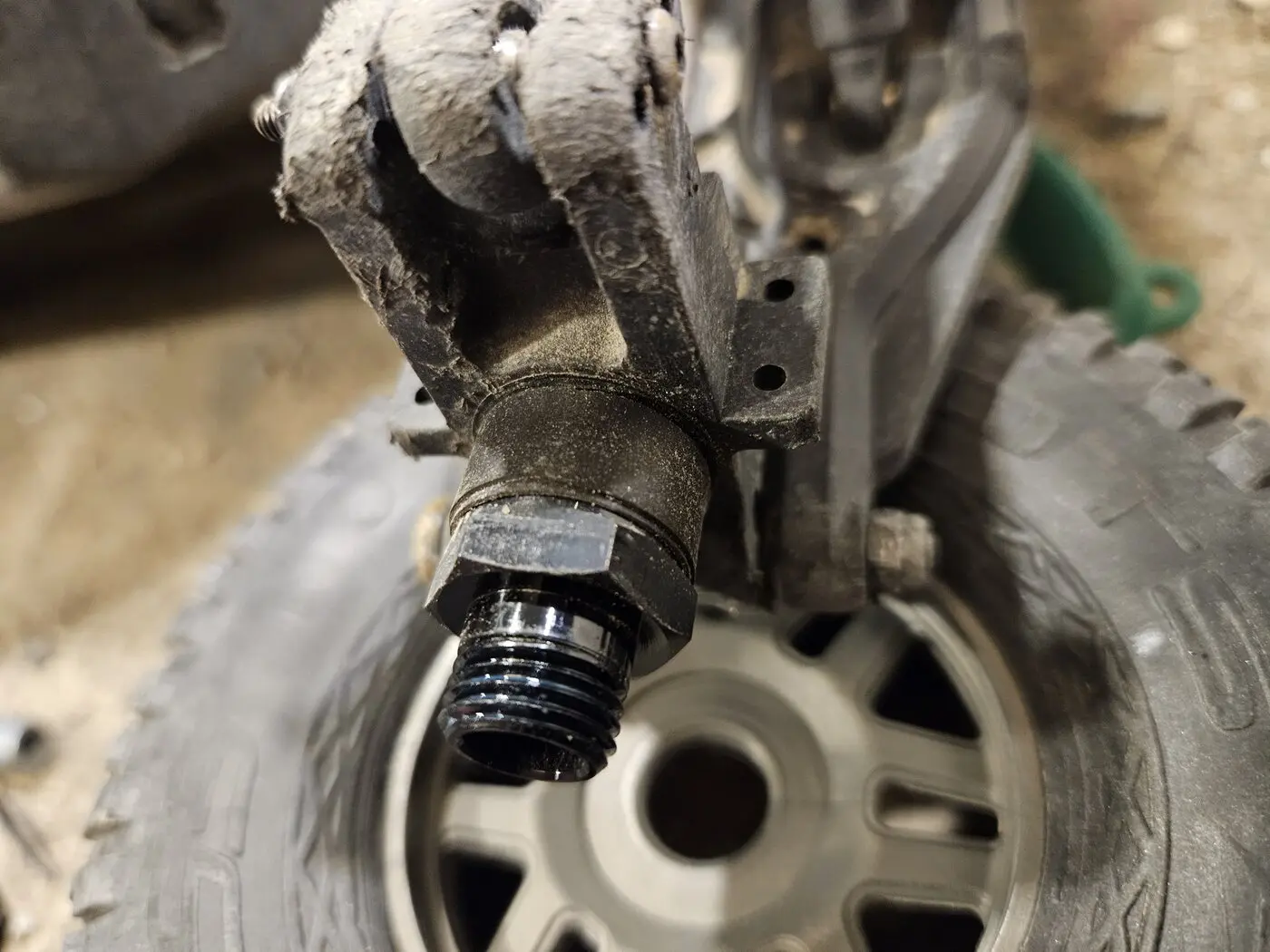

I have fitted 25mm extensions to the front of my Python. This has made it a lot more stable when cornering on rough grass terrain. I use it on 6S most of the time as I find this puts a bigger smile on my face than running on 4S. I am running Proline Badlands that are really grippy. For having a bit of fun I fit the original tyres on the front and leave the badlands on the front this makes it under steer at higher speeds rather than lifting the inside wheel.
The extensions are just standard ones for sale on eBay. To make them fit perfectly I had to remove the thin shim that was behind the outer wheel bearing. Because of this I will drop down to 15mm if this causes any damage to the bearings or drive shafts.
