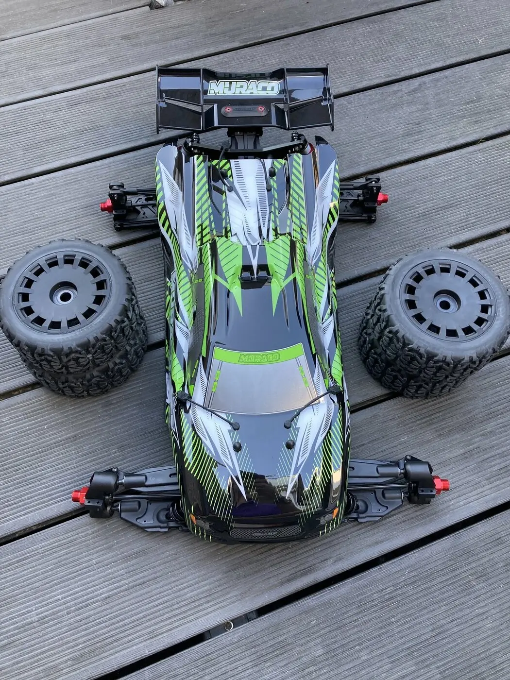

So I got a Muraco this week and need to get it ready ASAP for Saterday’s Arrmaforum 😄 bash day!

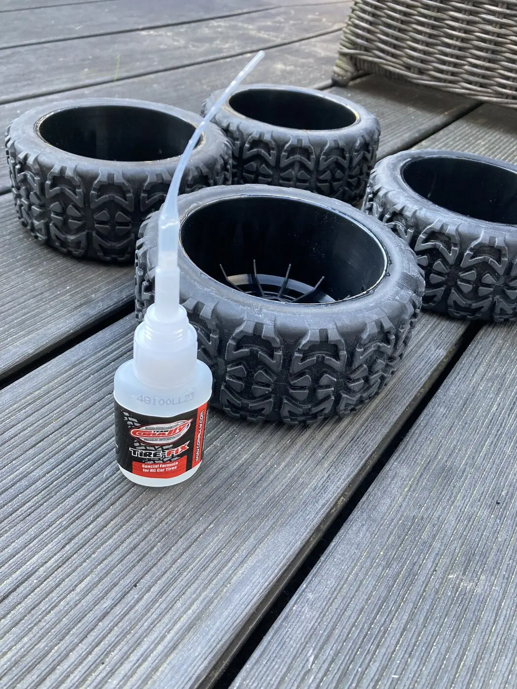

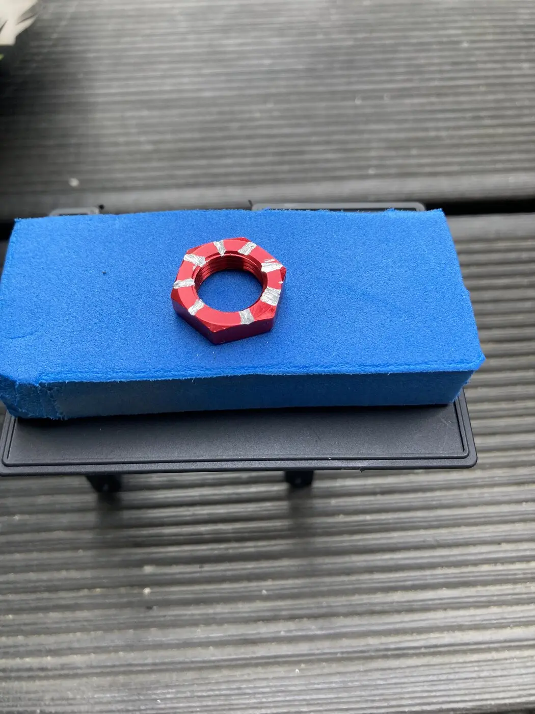

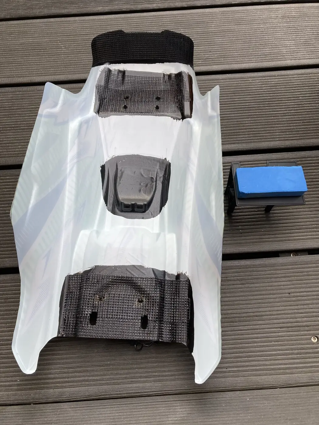

Glued tires, taped wheel holes, reinforced the body, used the Dremel on the wheel nuts to serrate them (non-errated wheel nuts?! Come on TC! Booohhh👎). Made a foam patch for the center roll cage mount.
Next: skid plates, add motor fans, change battery straps (longer ones and a 3rd strap) and check the included V2 chassis brace.

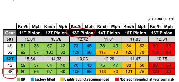

I have to say I'm impressed. Handling is good. Speed and accelaration is pretty brutal out of the box and I had even set punch down one level! It did 87km/h on sand and I'm not sure if there was even a little more in it, as the 'runway' was somewhat limited by tracks made by 1:1 offroaders.
I have no doubts that on road and with some lighter lipo's (I run 2x3s 8000mah) it will be close to its' stock configuration claim of 105km/h.
