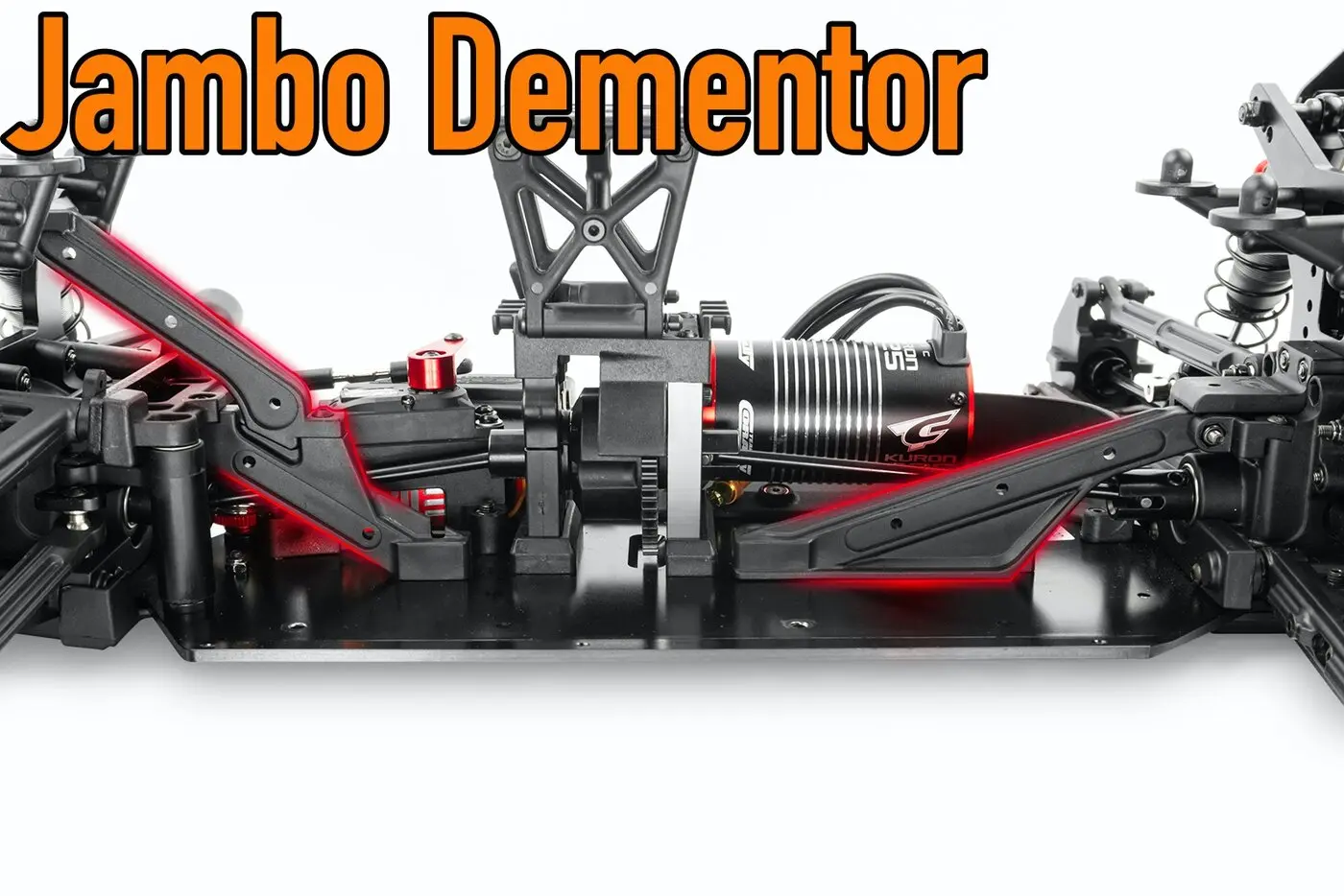

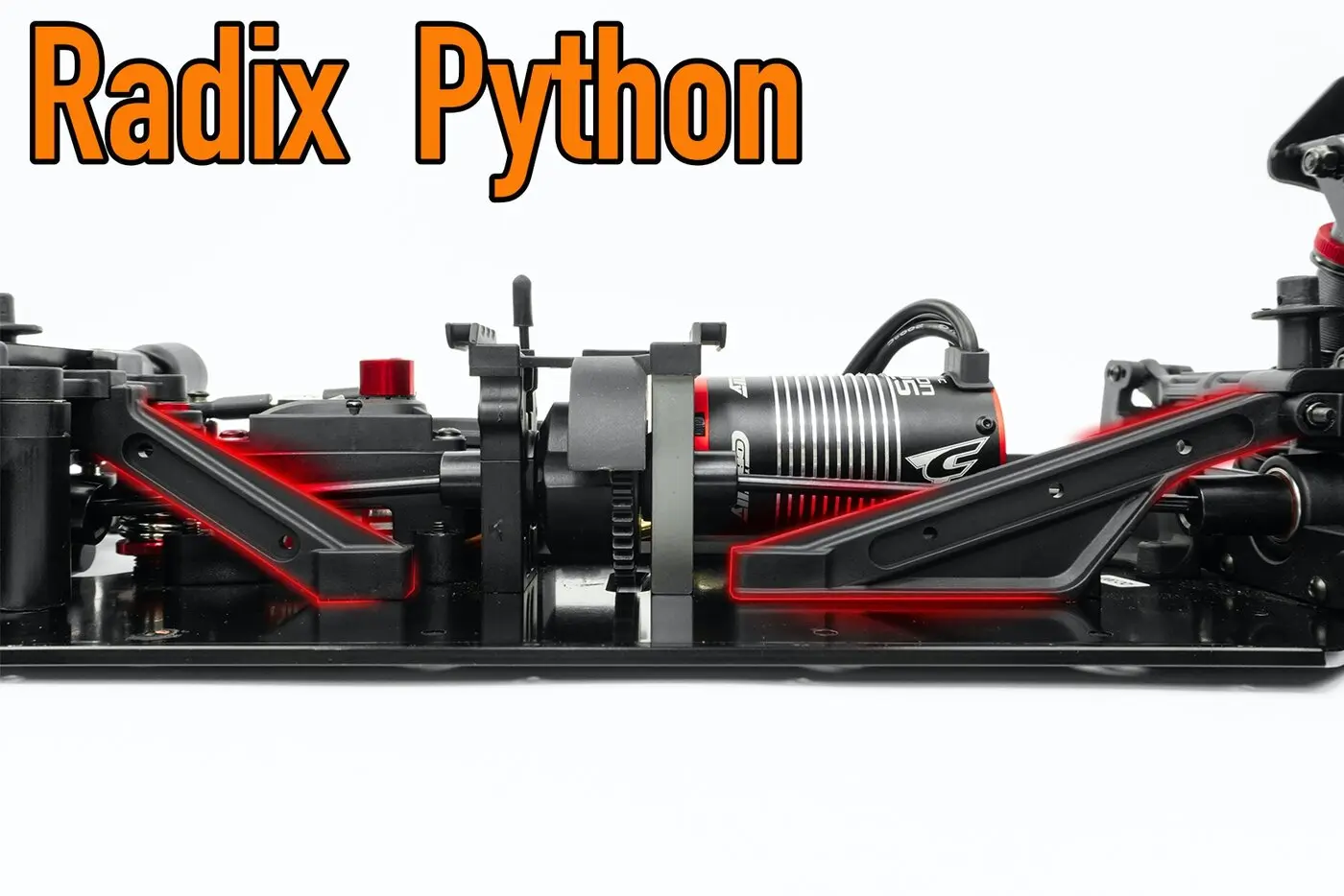

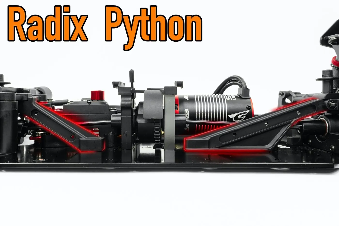

Here are some pics from Corally's website showing the center mount with different spur sizes and the height differences between models

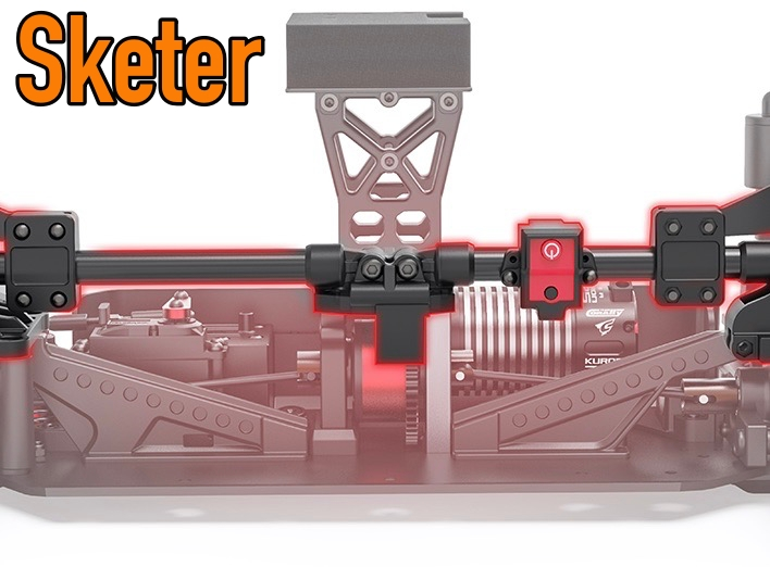

( Sketer is just here to show the differences in height as it uses a completely different mount !! )
So as you can see, the Radix has no spacers low mount with 46T, Jambo/Dementor shows 52T with what I believe to be a V1 low mount and 2 spacers and lastly the Sketer 52T with tall mount and 1 spacer.

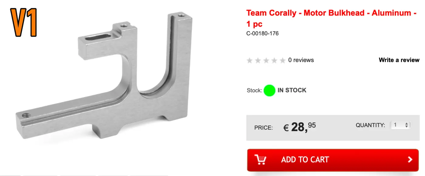

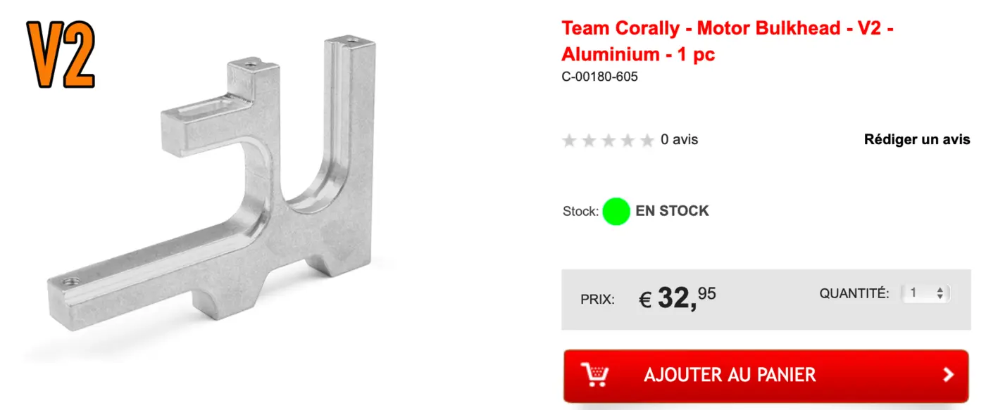

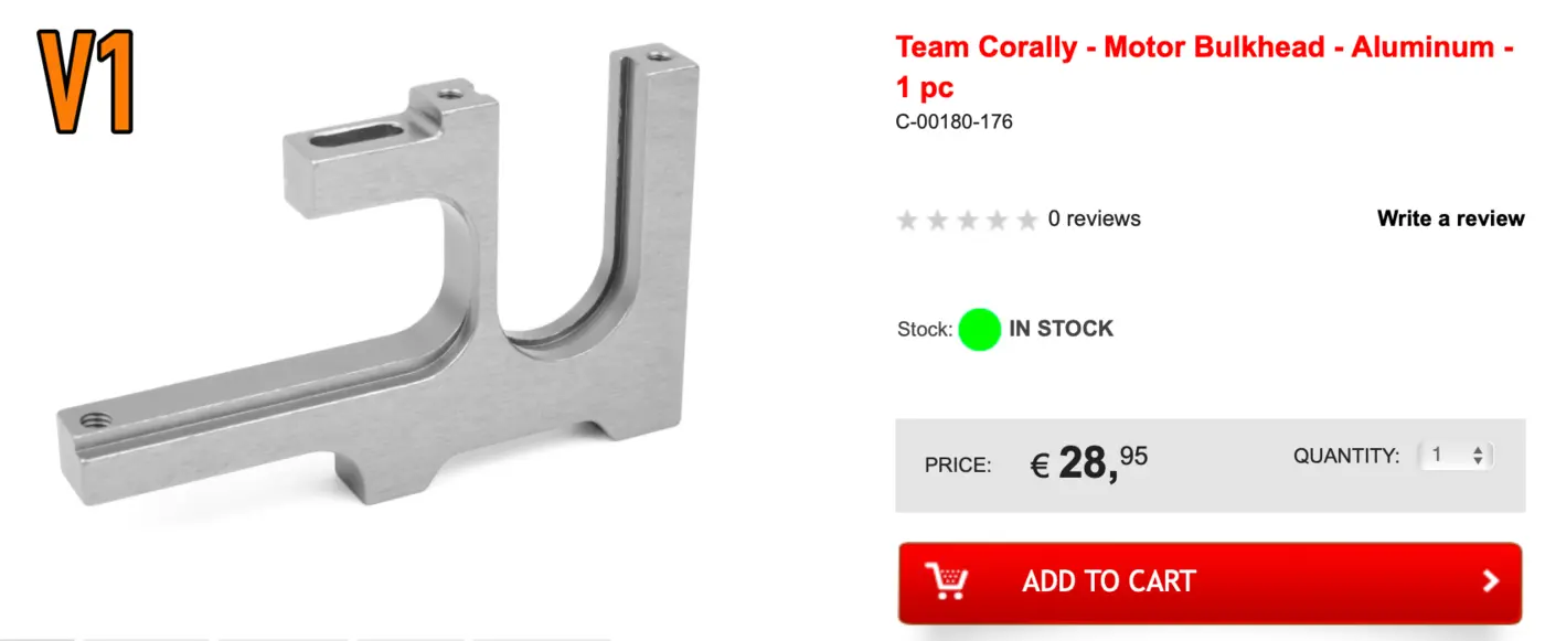

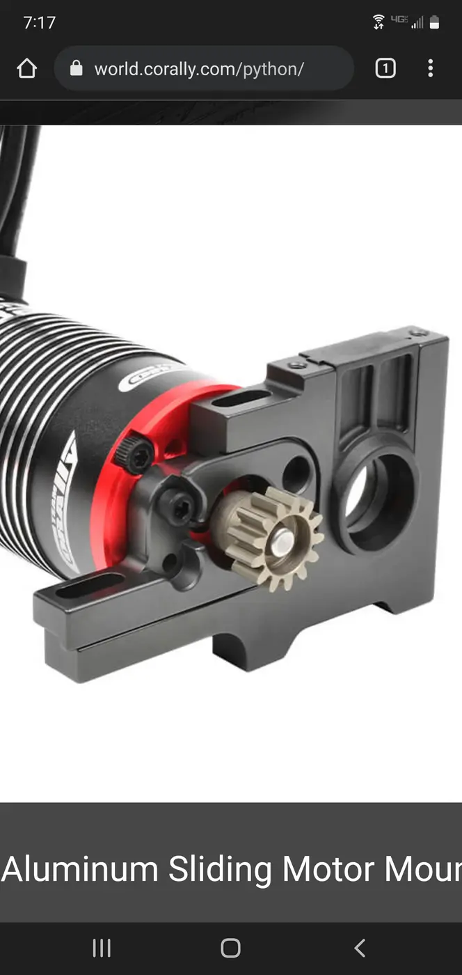

Here are the different motor mounts, I think this is correct.
V2 is fitted to the Kronos XTR as standard and maybe the V2 2021 models
The V1 mount is fitted to all buggies new or old and the V1 models..

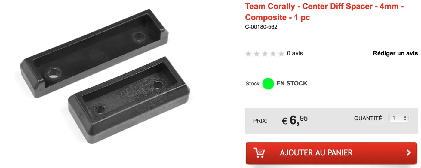

These are the spacers used on the various models, depending on what motor mount is used it might use just one piece or both..!!

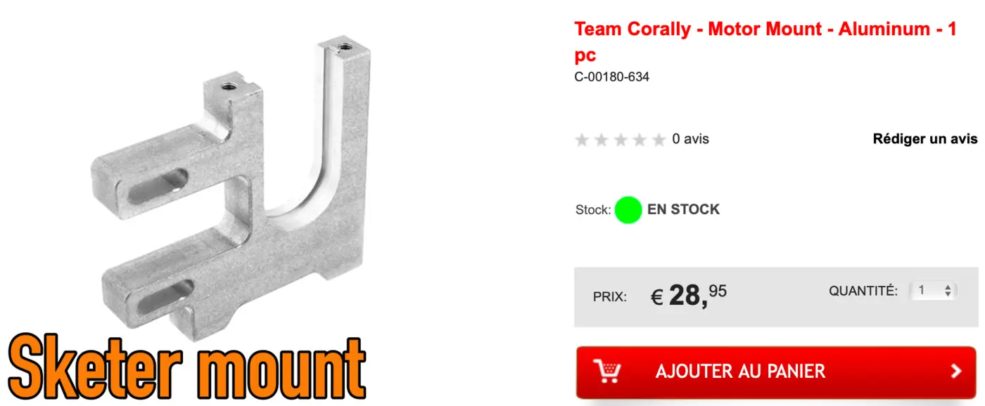

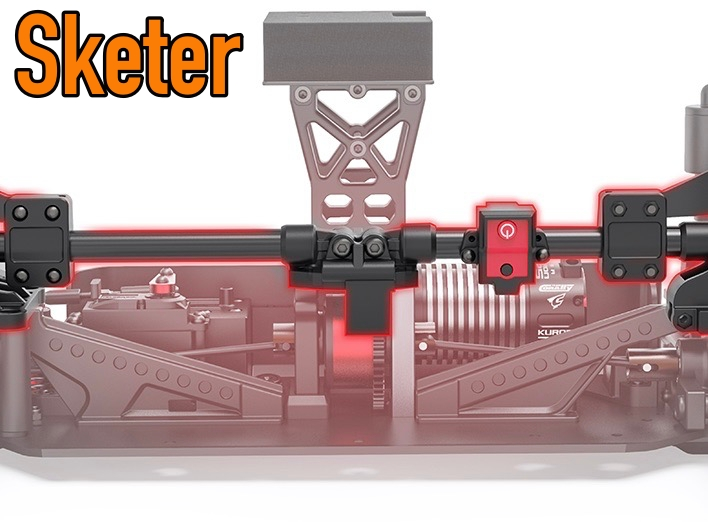

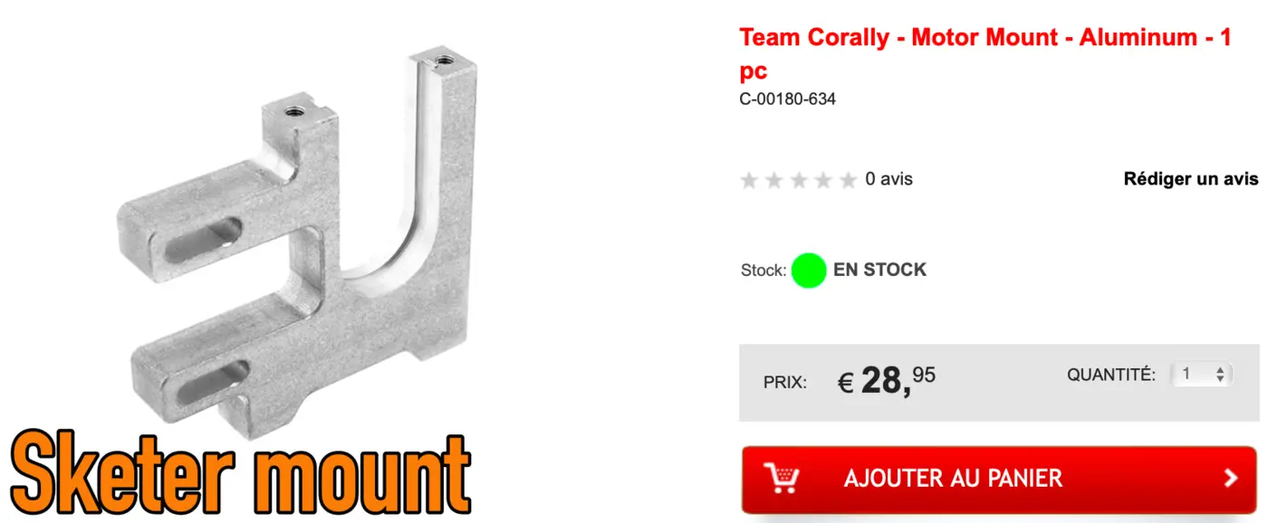

The Sketer uses a totally new style of mount that looks to be narrower than the conventional mount due to the Sketer being smaller..
I believe the sliding mount could work in a Sketer, but you will have to cut the side guard ( this has yet to be tested )
I'm not sure if I like this new mount as adjusting the gear mesh will be harder to do due to the bolt locations in the mount..!!

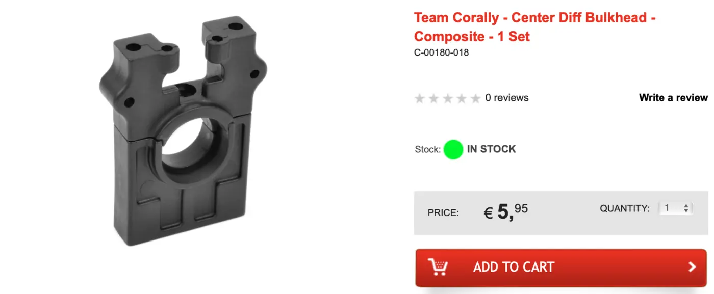

Ooops nearly forgot, the other end of the diff mount seems to be the exact same part used on all versions..
