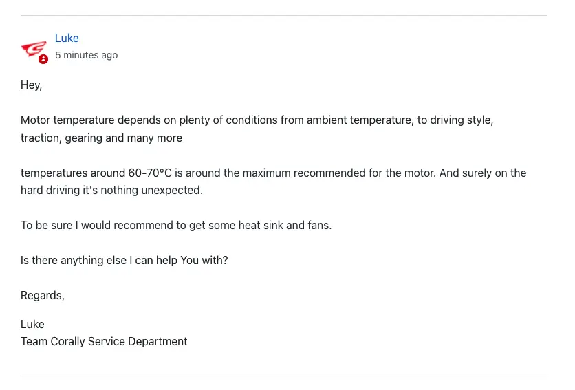

I've just opened a support ticket asking them, I'll report back.

Reply from Corally on motor temps for the Kuron 825, pretty standard stuff.
Yup, a generic response, not surprised TBH. So around 160f.. I guess after going beyond 70C, you're on your own in other words..

So to start wrapping things up on this thread, the XTR with the recommended TC electronics on 4S and the stock pinion runs very close to the max temperature limits on the motor. At a minimum, a good heatsink and fan is recommended.

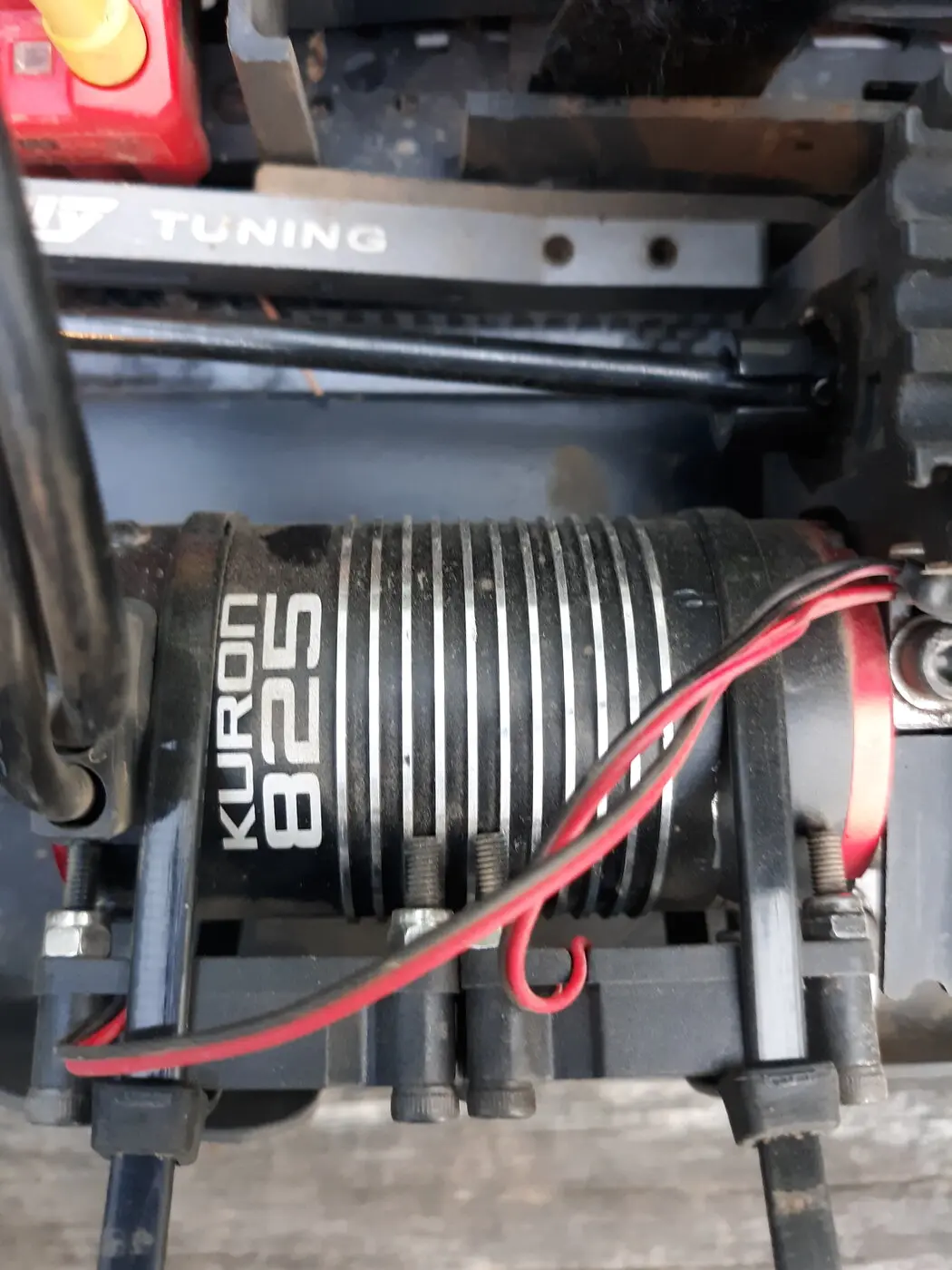

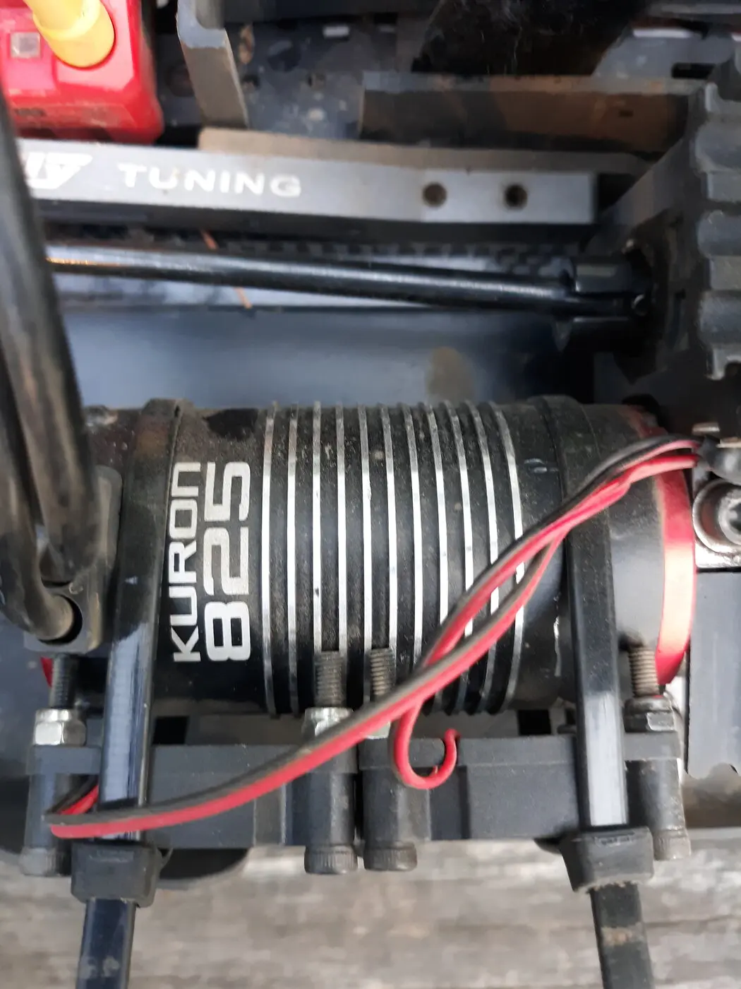

Oh yeah, right, I actually forgot to mention my personal experience with the TC equipped xtr🤪
So I got mine late last year,so fall temps (40-60f). No fans, 4s was seeing around 130f max. I did run 6s briefly this spring on same setup but don't recall the actual temps I was getting but not hot enough to concern me I guess..
I did install a couple 35mm fans recently in anticipation of running in 80-90f summer temps.

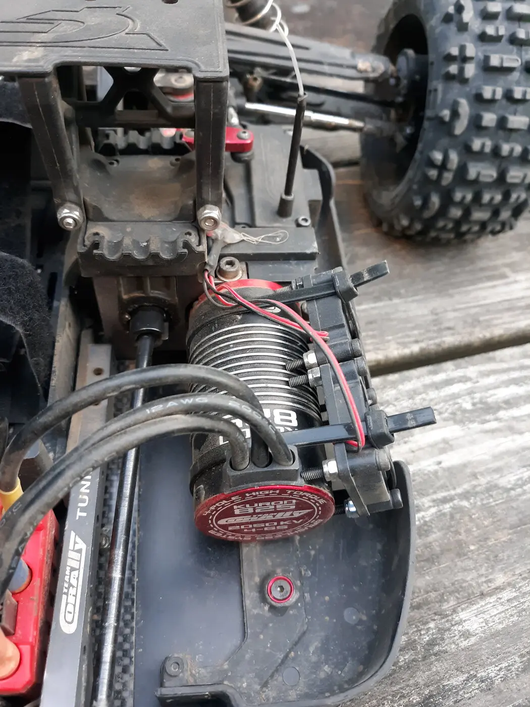

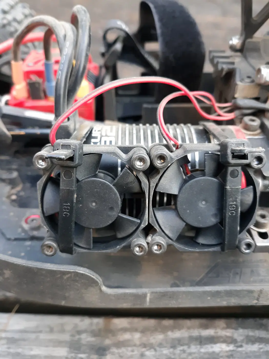

I'll take some picks of my setup if you promise not to laugh..JK. The fins of the motor are considered to be heatsinks, so I mounted my fans using M3x20 or 25mm screws with nuts and zip ties to maintain satisfactory distance from the motor for good airflow. Some real hillbilly looking crap TBH 🤣🤣
The jury is still out as to whether it'll be enough or not. The fans are Winsin dual bb 9k rpm from amazon at 5 for $15 so $6 invested thus far..

Soo, here's my rendition of fancy like😁🤣🤣
Thinking of longer screws, couple more zip ties and I might submit it for rig of the month?😁🤣🤣
Nice one! Actually a clever and resourceful way of mounting these fans!
