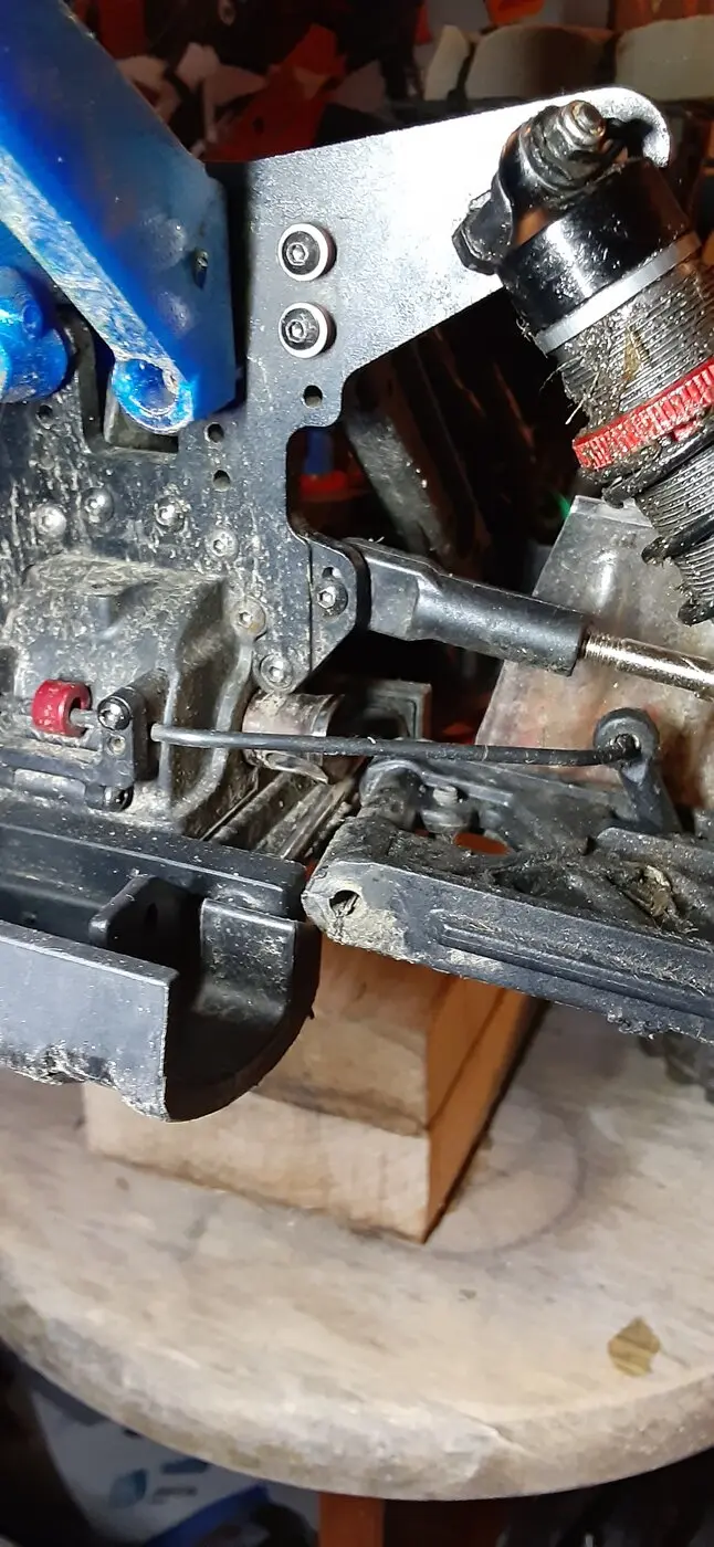

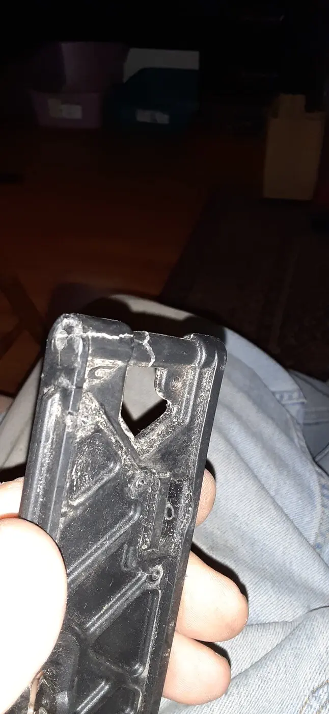

im curious what that looks like can you post a pic of the arm and tell us how they are breaking?
Excuse the dirt. I was to annoyed to wash it this time.They break when jumping. I have a 2 foot tall ramp.. get back flips and 10 feet high. But they seem to break on good landings. Seems strange. I'm tired of replacing arms
The stifners were supposed to help. I'm tired of replacing them..I have kronos exb arms coming... I'll make them fit..Mine don't break..Learn to jump wally! Lol jk take the inserts off the arms..The arms will flex a bit more ..Right now all the force is going to the hing pins

No steering links in back. Online it said 144mm from pin to pin.. that makes then 4mm longer. I will make my dog ones longer by 4mm to make up the difference. I'm a welder by trade..so I don't mind welding..You will probably need longer axles and steer links to run kraton arms I think. If you can fit them, I have no doubt they're stronger.
On the rear the inserts are not really needed..If you land wonky the hing pin is going to take all the force as the arm won't flex..Its a simple transfer of force path of least resistance..Now if you were racing this truck and needed to stiffen up the rear to suit track conditions then the inserts would be an optionThe stifners were supposed to help. I'm tired of replacing them..I have kronos exb arms coming... I'll make them fit..
