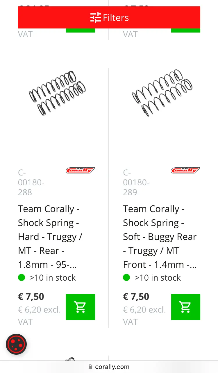

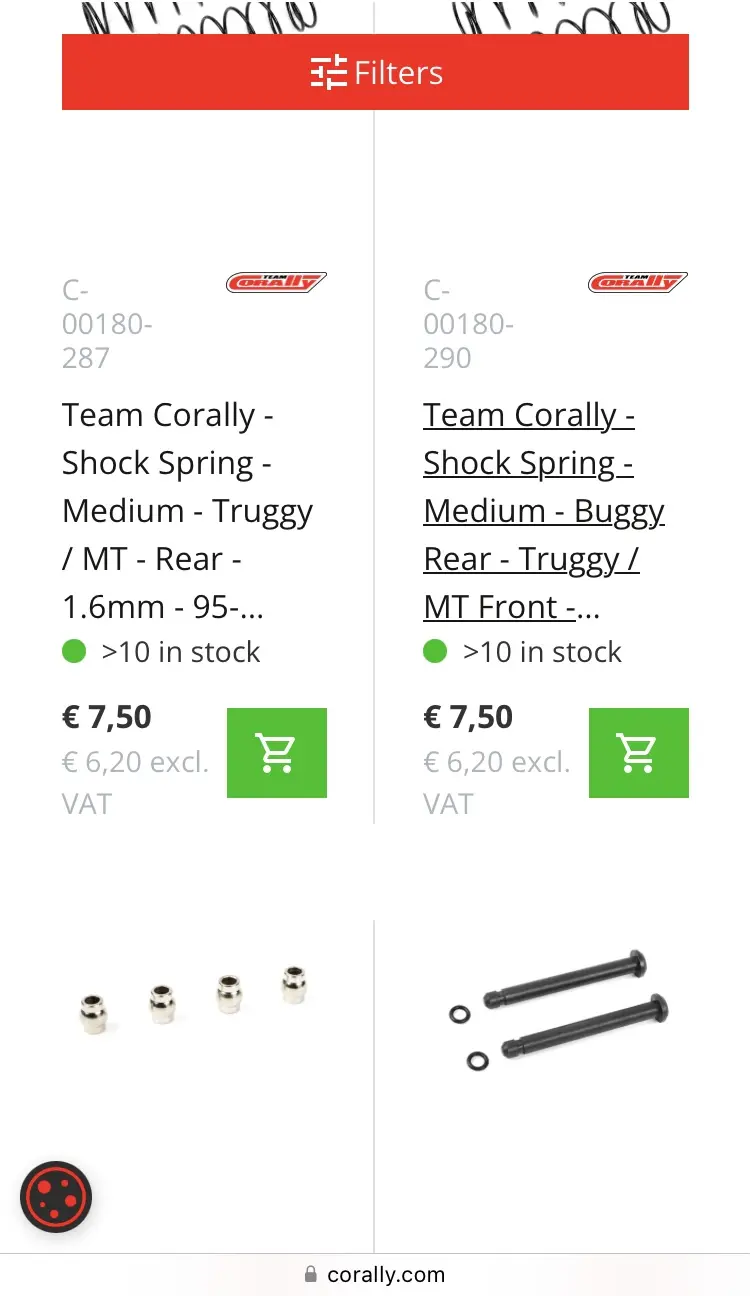

How do you tell if the shock spring is hard/med/soft? Thickness?
By thickness of the springs need set vernier callipers to measure but come with medium installed from factory soft 1.4mm medium 1.6mm hard 1.8mm
