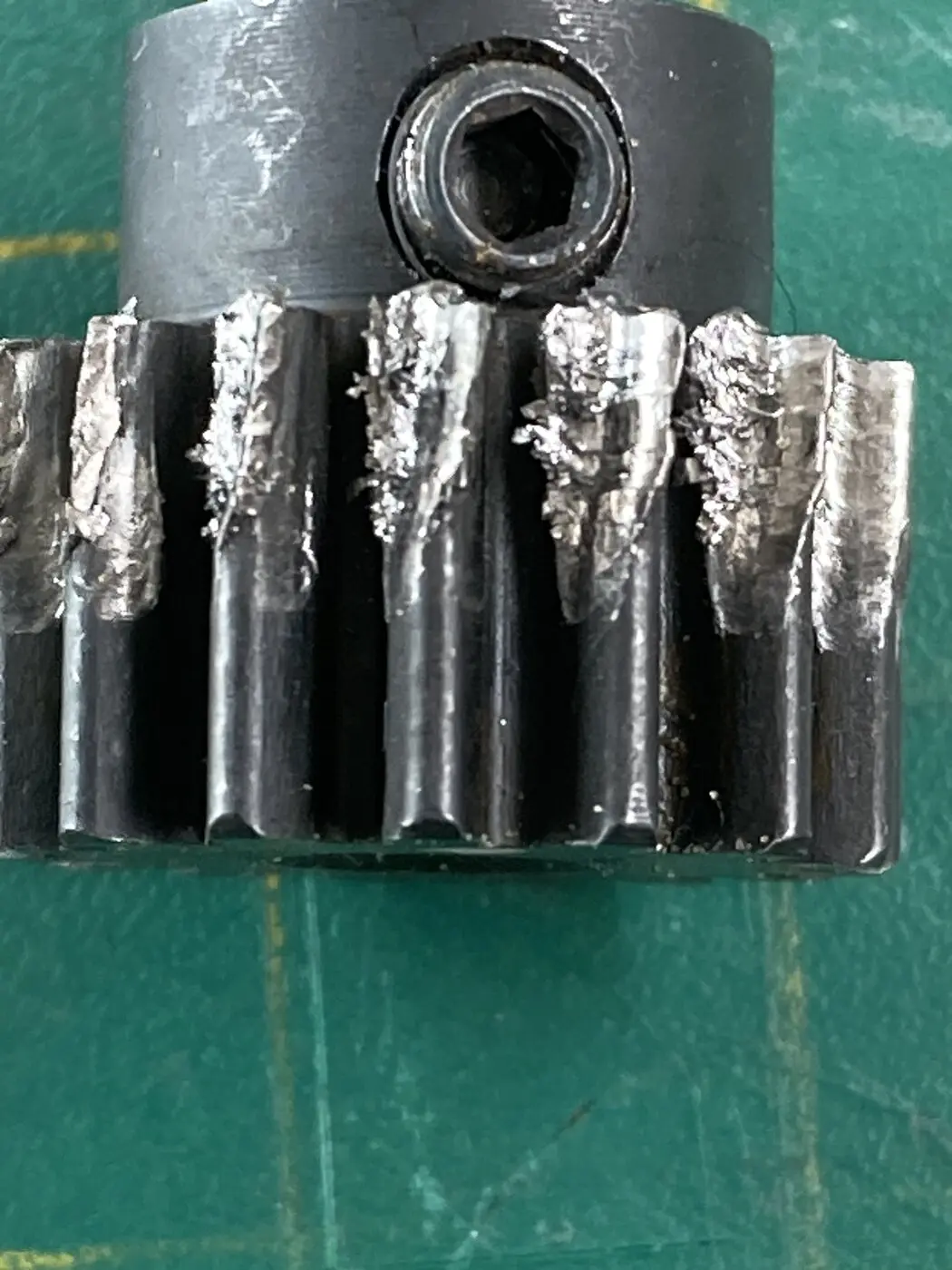

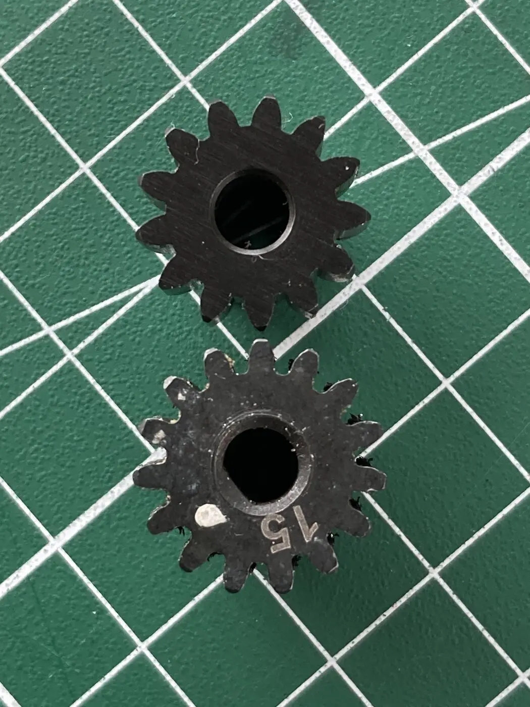

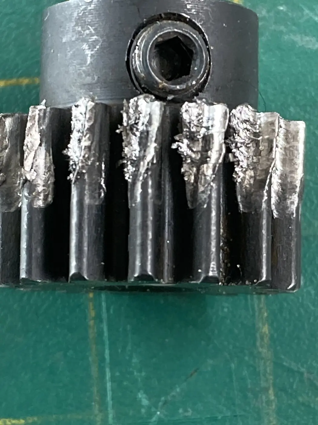

Closer inspection and it looks like TC pinions (the top one) is beefier and ‘pointier’ than Arrma’s D-Safe pinion (bottom one). In case one is wondering what those spots are on the Arrma one, the second pic is why, after almost 2 runs (first on 4s and second on 6s) 😉. TC spur still looks almost new.
Yep - that's done for! 😅🤣

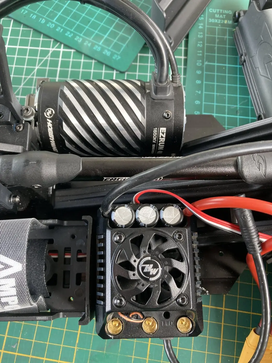

Last days of my vacation so installing the electronics as we speak.
Max6 G2 combo and DS3235Pro servo.

The Max8 combo is actually in the stock RTR Kagama combo (although with TC own branding). I’m pretty sure TC has it programmed with more timing for more speed but as a result also higher motor temps.
A max8 G2 2250kv combo or Max8 with a 4082/4282 motor (Rocket, Surpass, etc) would do. I’d keep the kv somewhere in the 1600-2200kv range.
A max6, either the ‘old’ 160A or new 200A G2 will give you a bit more headroom. Note that a 85mm motor is about the maximum you can fit. I had to sand about 1 or 2mm of the shock tower brace to make the 4990 motor fit.
