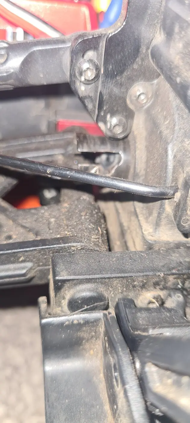

Yeah, once the outdrives look like this, they will break driveshafts.
Change them for the hardened spring steel option and they'll hold up much better.
No point putting new driveshafts into worn out outdrives. Lesson = Learnt.

Agreed☝️ The drive cup and shaft are slip joints, once the cup gets cavitated by the driveshaft pin, no more slip occurs and something has to give..it's well known that the standard XP cups included with the rtr models have deficiencies.
Get the upgrade spring steel drive cups for front and rear diff outputs, the center driveshafts don't move as much and do last longer as a result. Replace them as necessary..The outer dogbones and front cvds have been flawless for me for 2 years now. The center front shaft does wear more quickly than the rest but not too badly. Good luck👍
