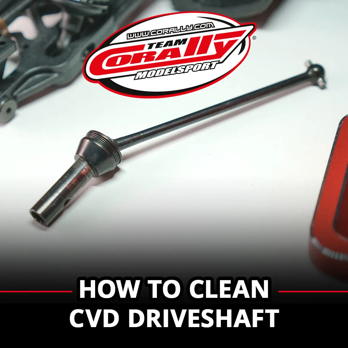

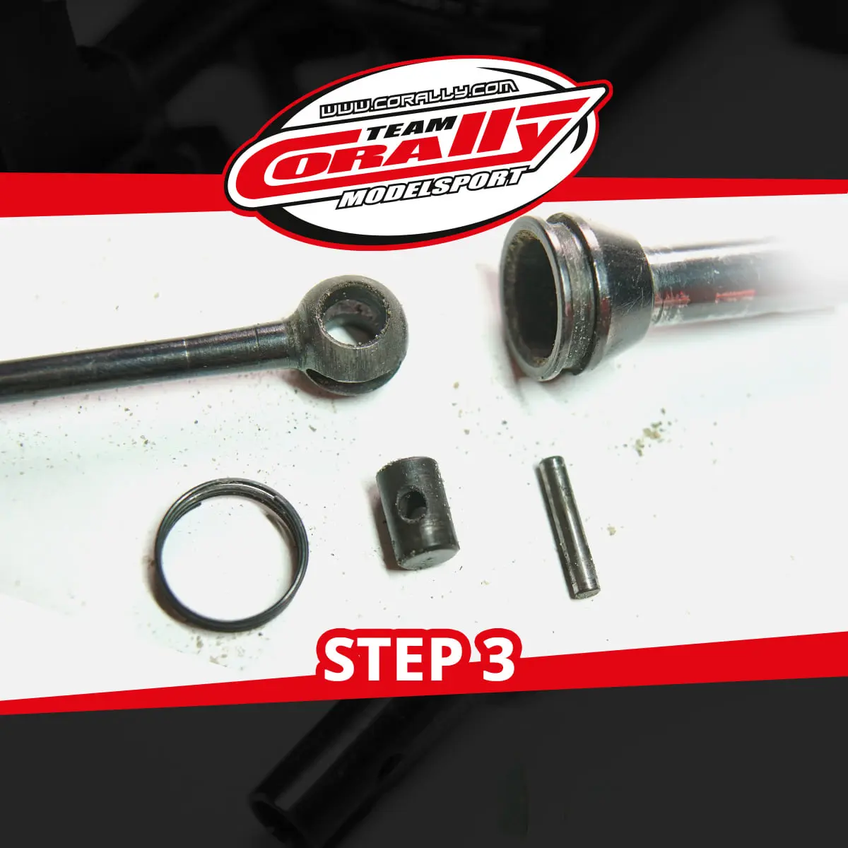

Another top tip and guide brought to you by Corally..!! ( & BashingBrian
How to clean CVD driveshafts..
Cleaning and maintenance of axles pay huge dividends compared to the simplicity and time requirement of the task.
Follow these simple steps:
Step 1: Remove the pin retainer clip
Step 2: Push out the cross-pin
Step 3: Disassemble completely and clean parts
Step 4: Lubricate with grease
Step 5: Reassemble and install
Bash on, friends!

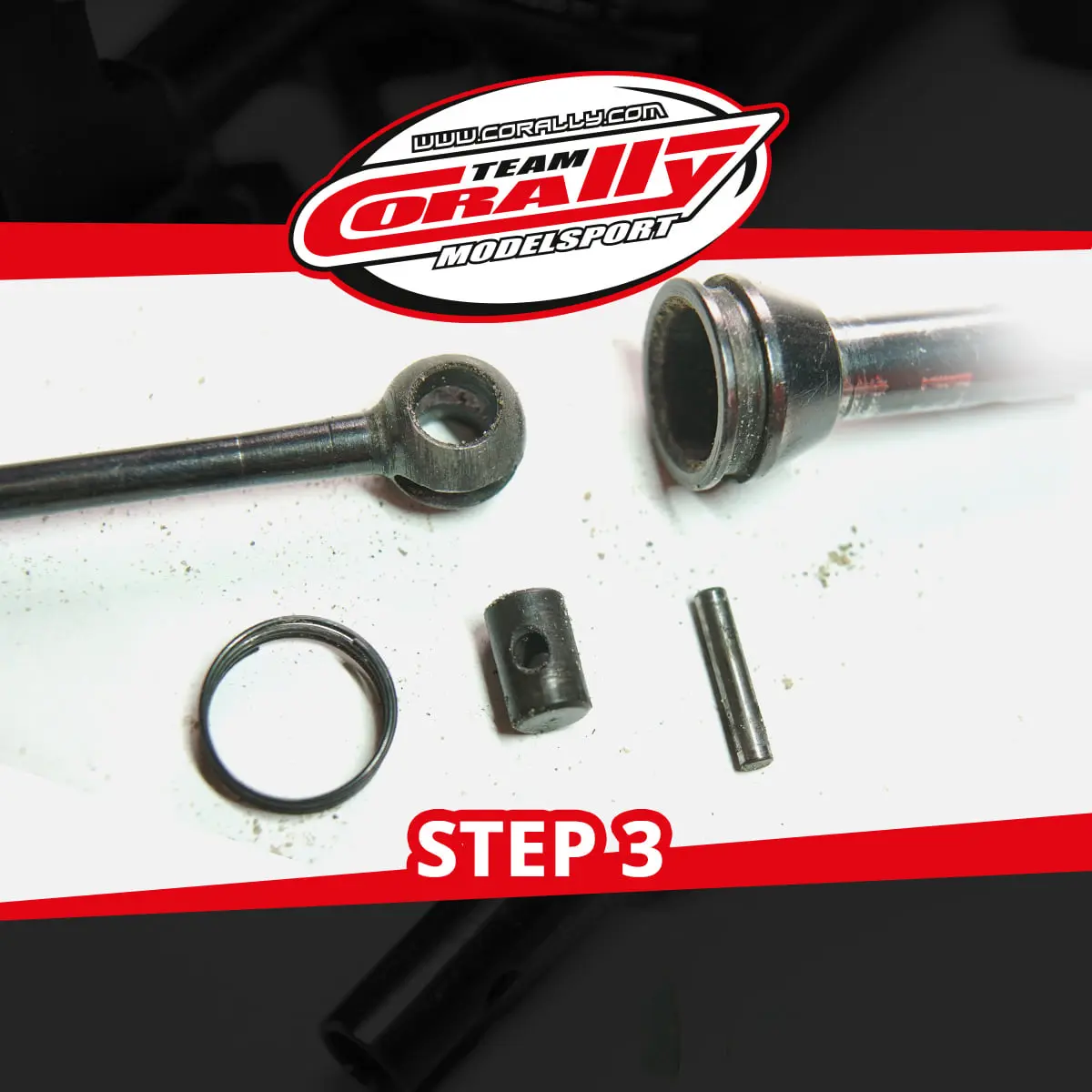

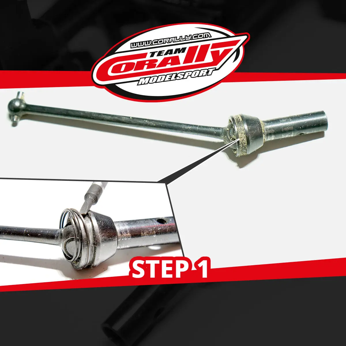

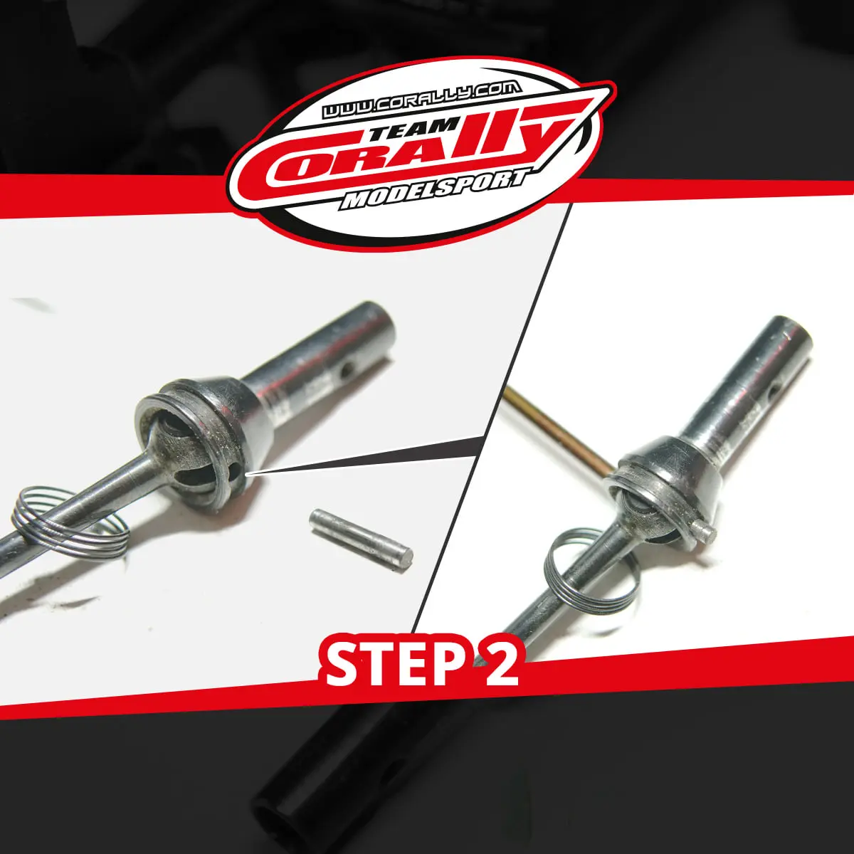

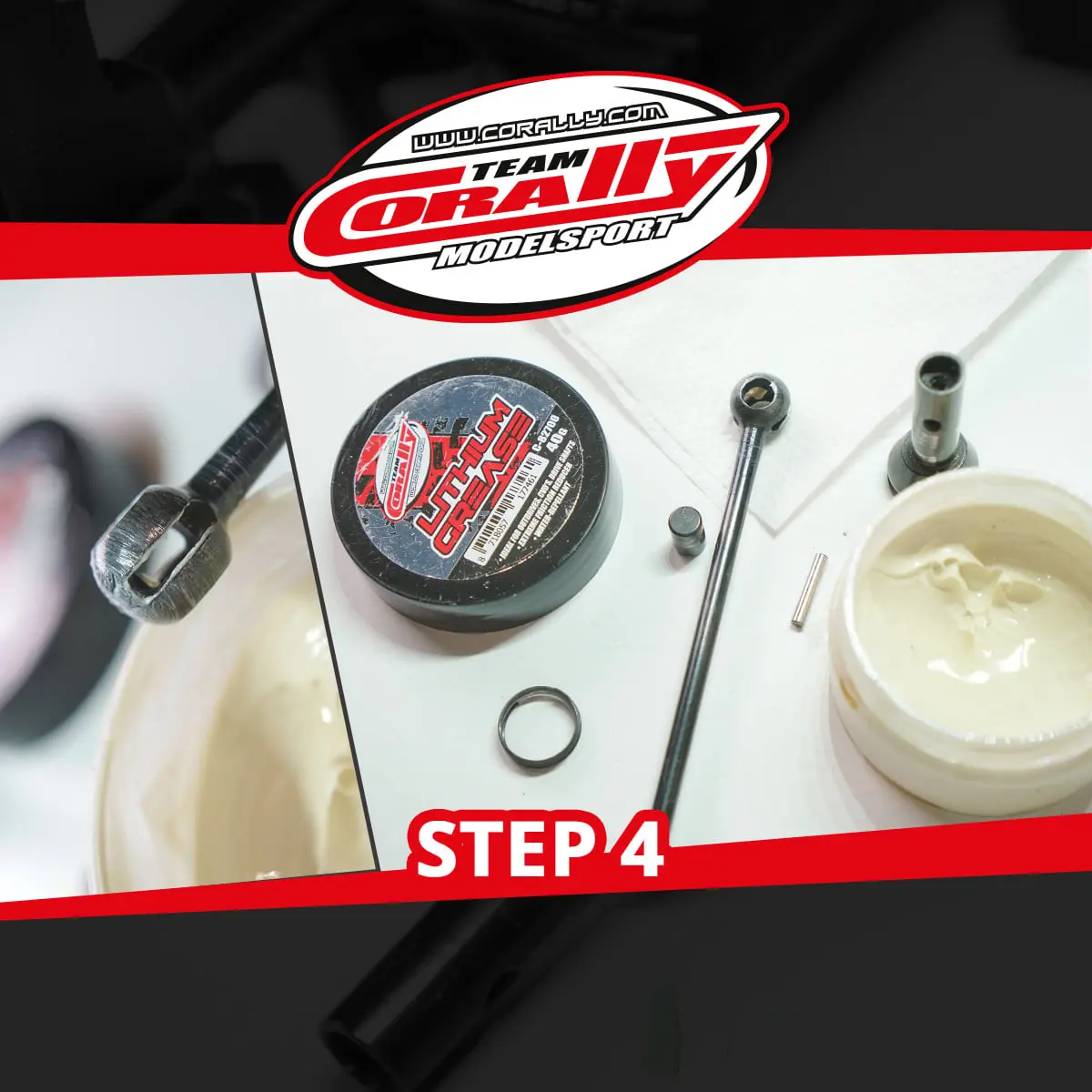

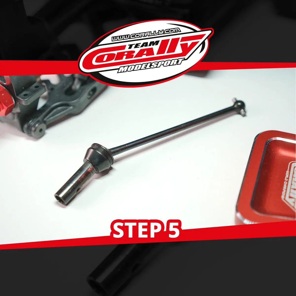

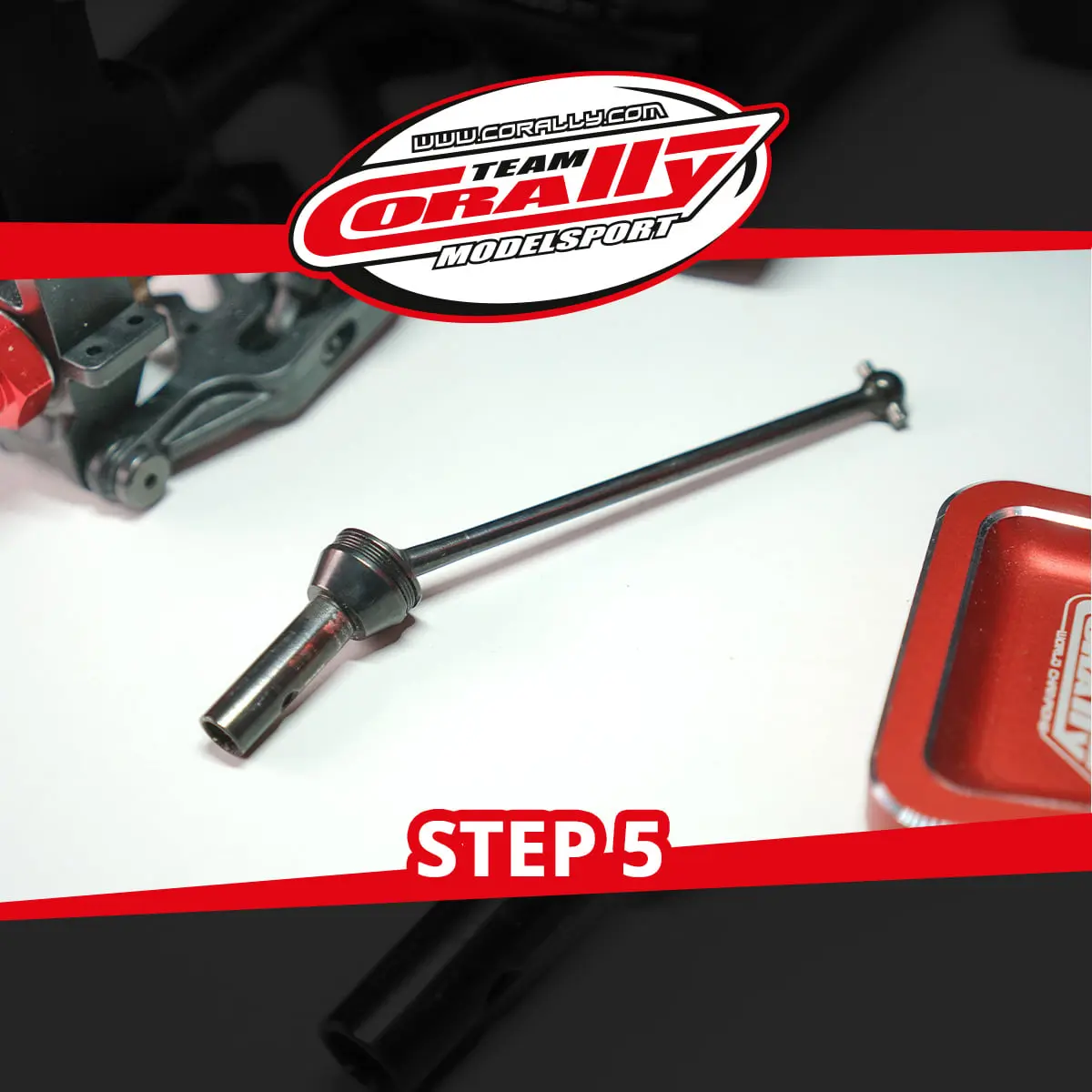

Bash on, friends!
