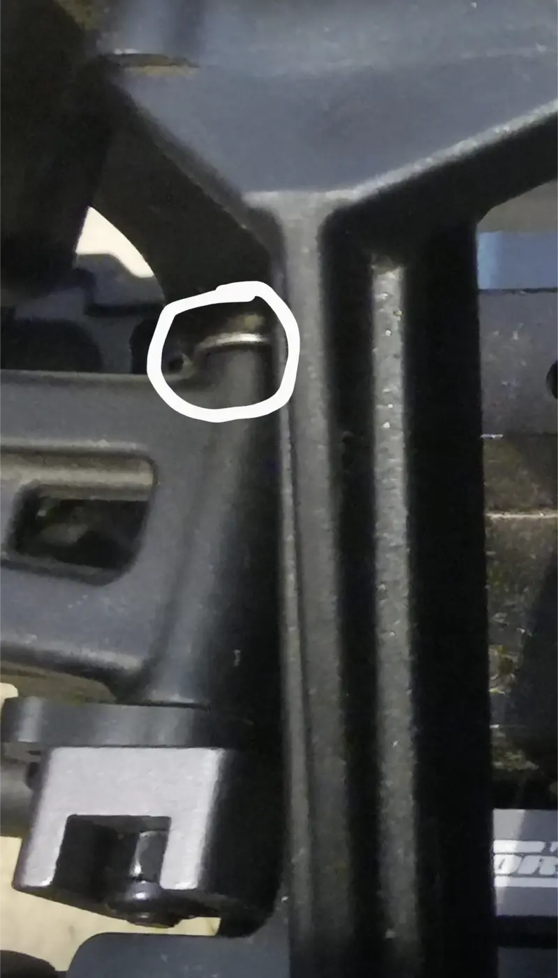

I hope this helps show what I mean...
Note also the threaded portion of the pin goes all the way through the nyloc nut.
