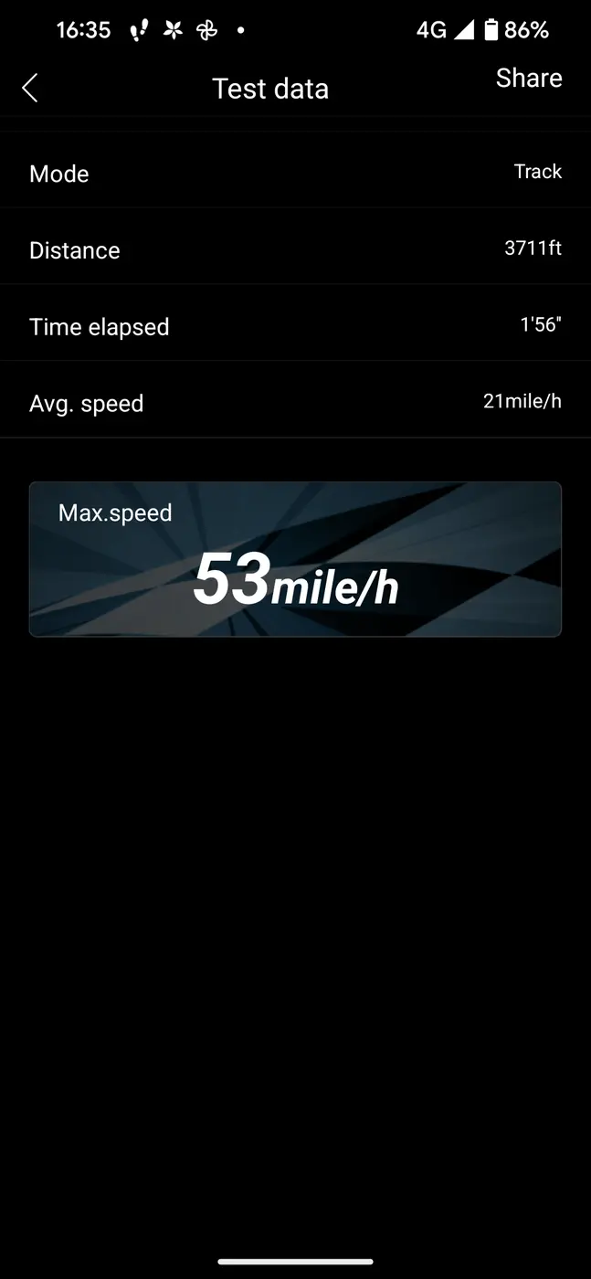

So I ran the Sworkz today down the 1/4 mile strip. In fairness, the car itself was almost flawless. 2 M3 screws got loose, but I noticed and dealt with accordingly. One was on rear chassis brace where it goes into the silver threaded ball. Why they arrange it like this when a nyloc nut hold it instead never know. Unfortunately as the steel ball isn't drilled M3 all they way through, I can't easily drill it out so will just live with applying liberal amounts of locktite.
My experience today with the castle proves that it's not my batteries - I think it's something to do with the sensor wire and it's connectors - so I'll be investigating that tonight.
The issue of beep beep and throttle cutting made it near impossible to do 0-50mph. It's done it with both batteries.
Bizarrely, when it let me have any throttle to play with - it gave me 54mph no trouble.

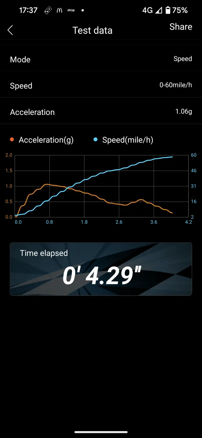

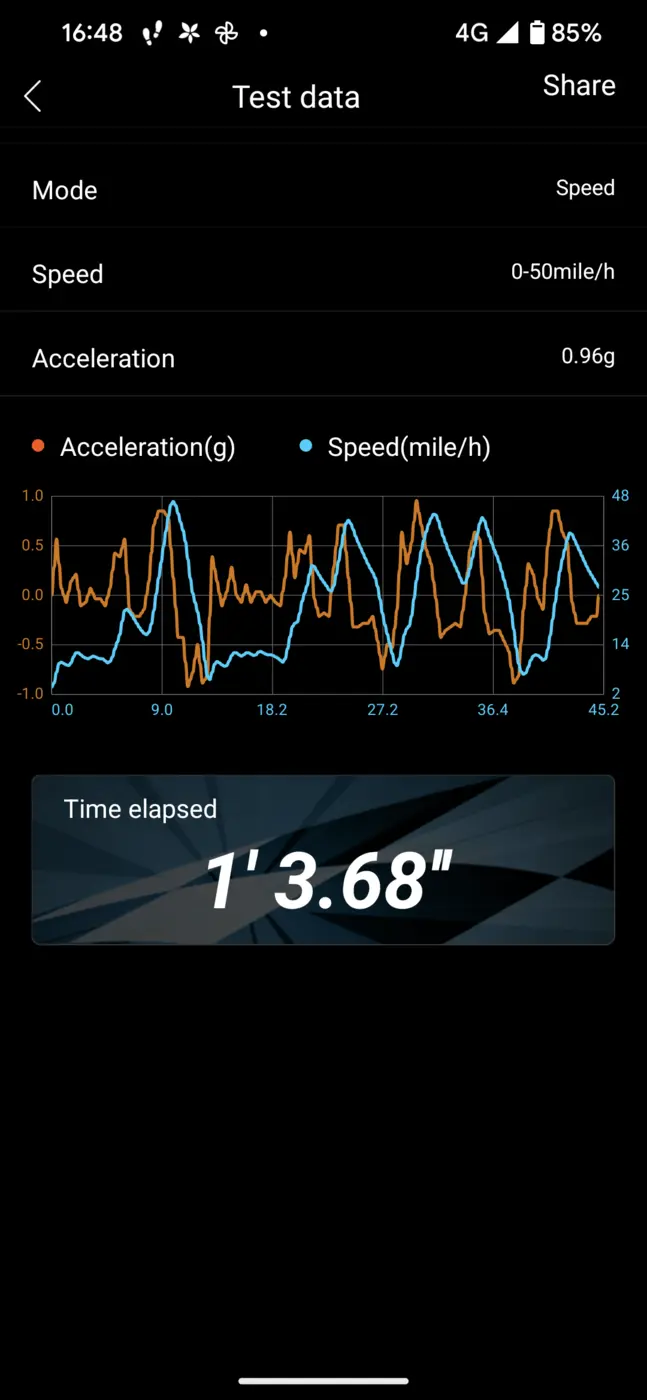

0-50mph attempts look like this:
Because it might take 2,3,4 or more attempts to get proper gobs of power.

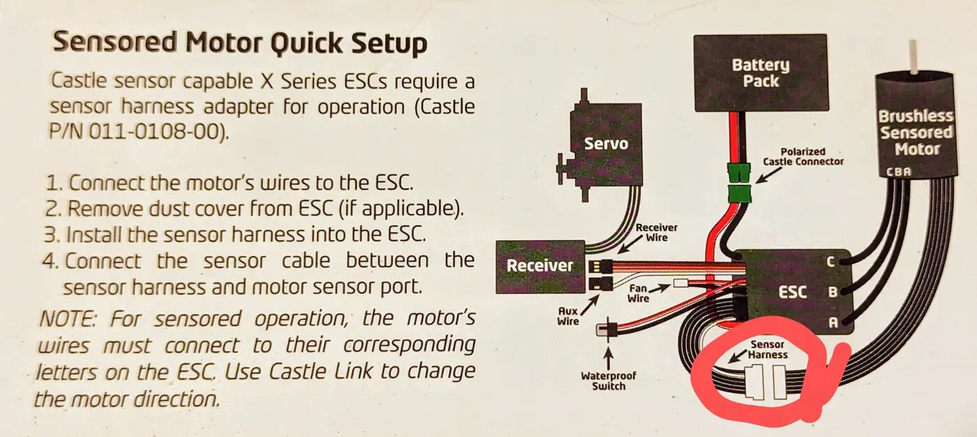

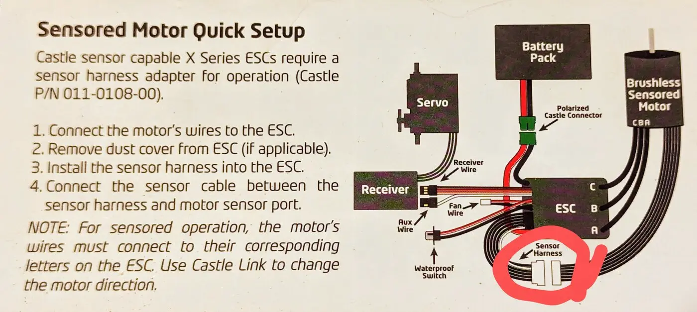

The sensor harness wire (and it's rather feeble, vague feeling plug) was indeed the cause of the issues.
I was checking for kinks or splits in the sensor wire, and whilst obsessing where the wires plug into the motor, whilst removing the MMX ESC from the chassis, the sensor harness parted company completely from the sensor wire plug.
Basically when I was inspecting the wires (all bunched together) whilst they seemed like they were plugged together - it obviously wasn't firm at the harness side.
So in fairness to Castle, it's fairly amazing it ran at all! 🤣
In my defense, Castle's sensor harness is.......less than optimal. It's flimsy, vague, difficult to see and physically different to their own diagrams.
The end of sensor wire plug is actually black, but in the diagrams, is shown as white the same as the harness. It may seem like nit-picking, but the harness plug looks different in reality as well - the only similarity with the diagram is the colour, but the shape is wrong.
Did nobody raise their hand and say - this plug is flimsy and vague - perhaps we should use a better one. Ideally with something that works! 🤣

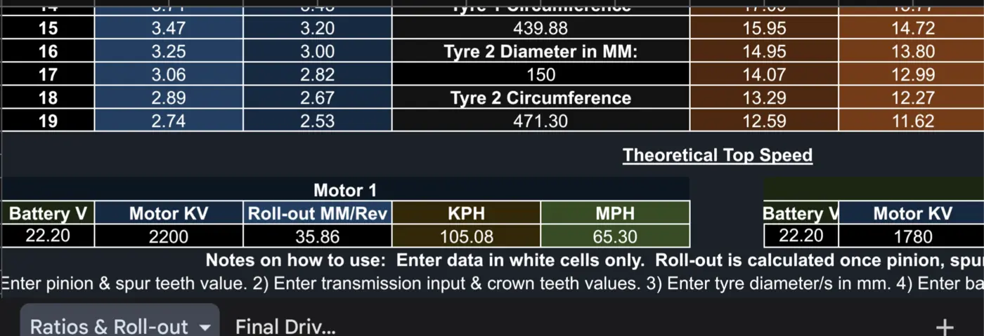

Thev Sworkz T2E is being geared up 3t to a Tekno 18t pinion on 48t spur.
On the Sweeps, this gearing should be good for 65.30mph, but hopefully, with an excellent 0-60mph time. 🤞

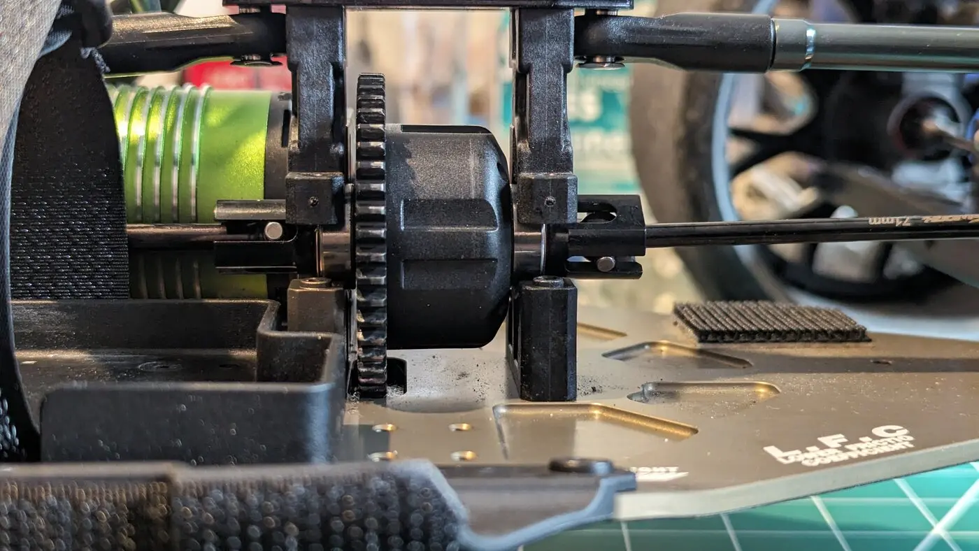

I've noticed a little end-float on the centre diff, so I've added a 0.2 shim at both ends.
Problem solved. 13x16x0.2 shims are extremely useful on Truggy diffs at the front and rear, too. 👍

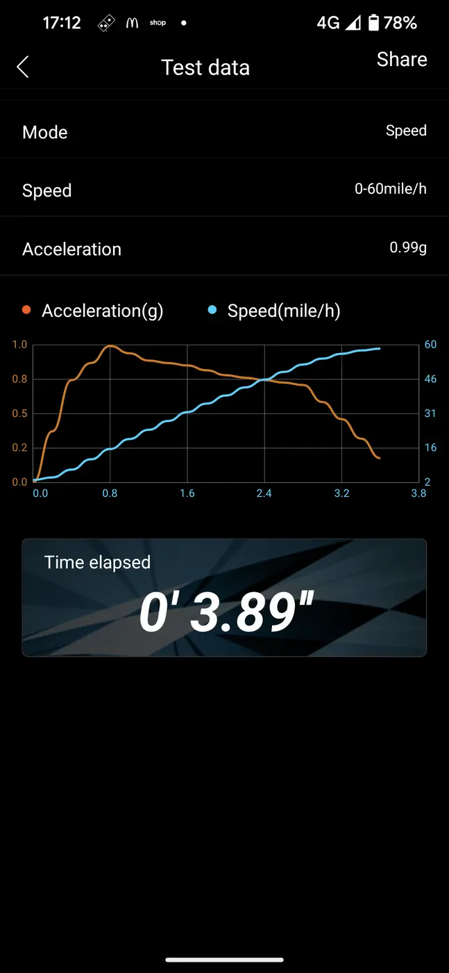

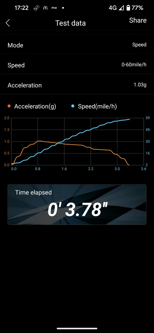

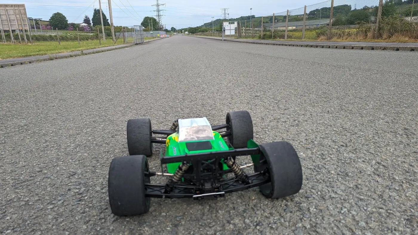

So today was 0-60mph day with the freshly prepped S35 T2E.
I'm happy to say it ran flawlessly, with no faults or stoppages.
This was just as well, because the strip where I was conducting my speed runs was being used as access to a Circus, thus there was a fair bit of traffic to be aware of.
Onyx Pack:
Run 1
Run 2:
Run 3:
I was beginning to sense a feeling of 'deja vu'. 🤣 Run 4:
Success! I beat my PB by 0.01 of a second. 😅
Run 5:
Run 6:

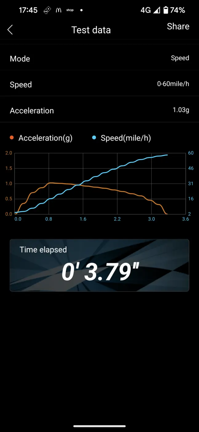

Now for the Gens Pack:
Run 1
Run 2:
Totally lit the tyres up on this run. Such a shame...
Run 3:
Tyres hooked up - nice 80°F tyre heat I. Each corner. New personal best!! 🤩
Run 4:
Equalling the XTR's best time....
Run 5:
And again. I'm about done.

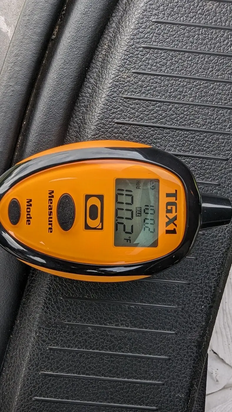

Motor temps were a very reasonable 102°F. Tyres were 70-80°F. Surface temp 82°F.
