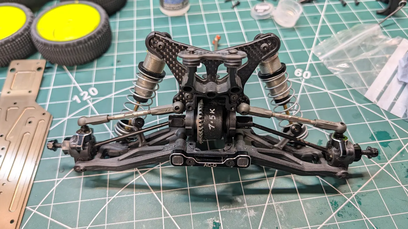

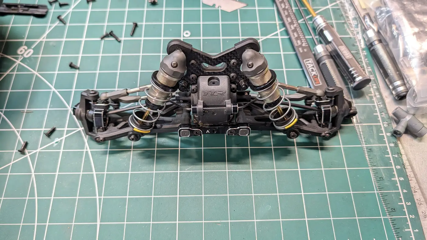

The business end! Nice. So if I bolted this onto my carbon chassis.......
And the rear end.....
And then did some jiggery-pokery on the middle bits - I could make this work. Right?

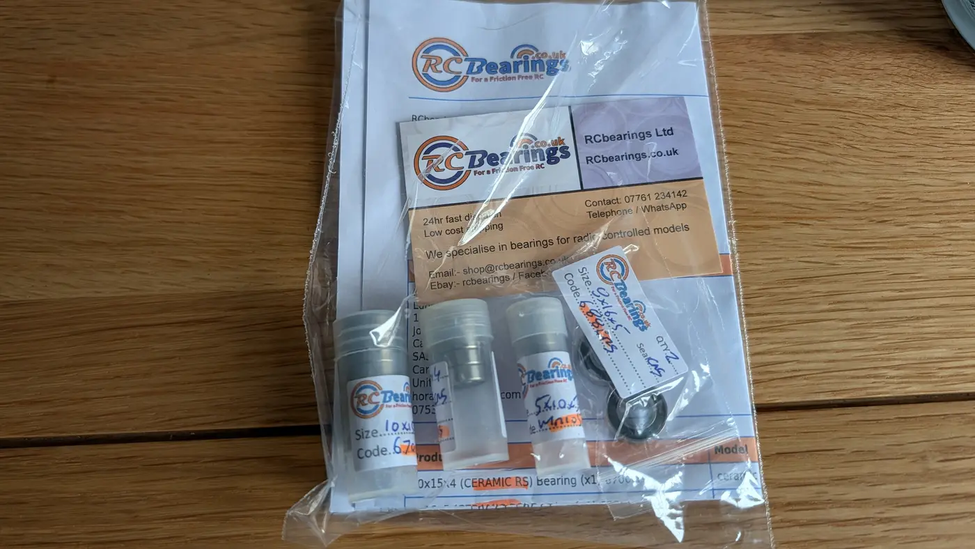

Ceramic bearings
Replacing these

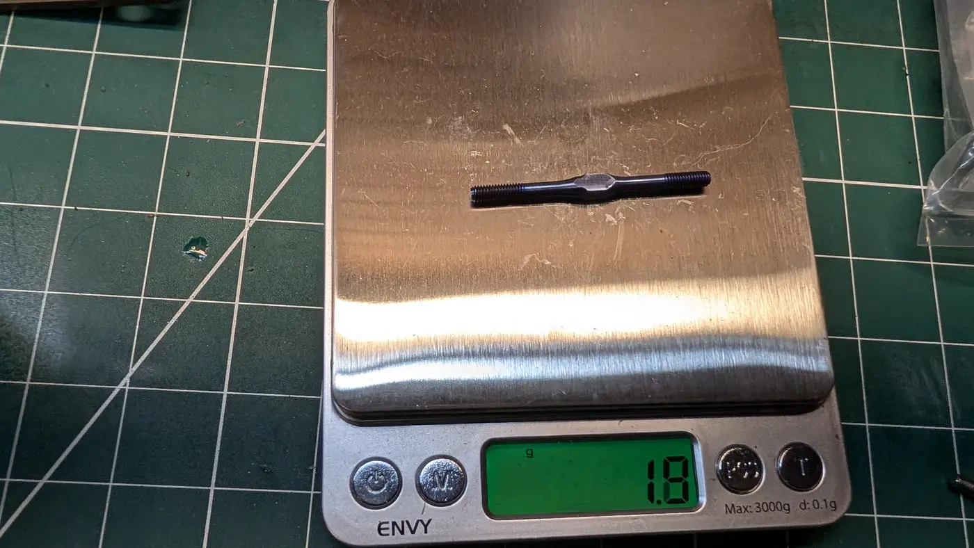

With R1 Wurks Titanium (burnt blue).

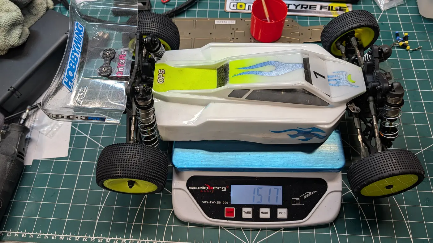

We end with this,
Getting whittled down to this:

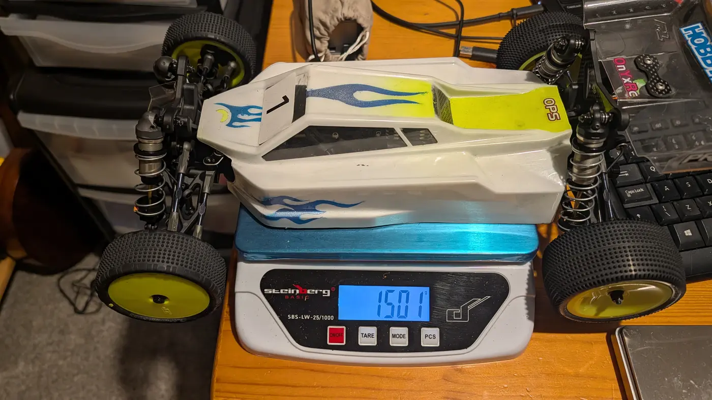

Which is only about 23g heavier than my Elite was - but with 13mm shocks.

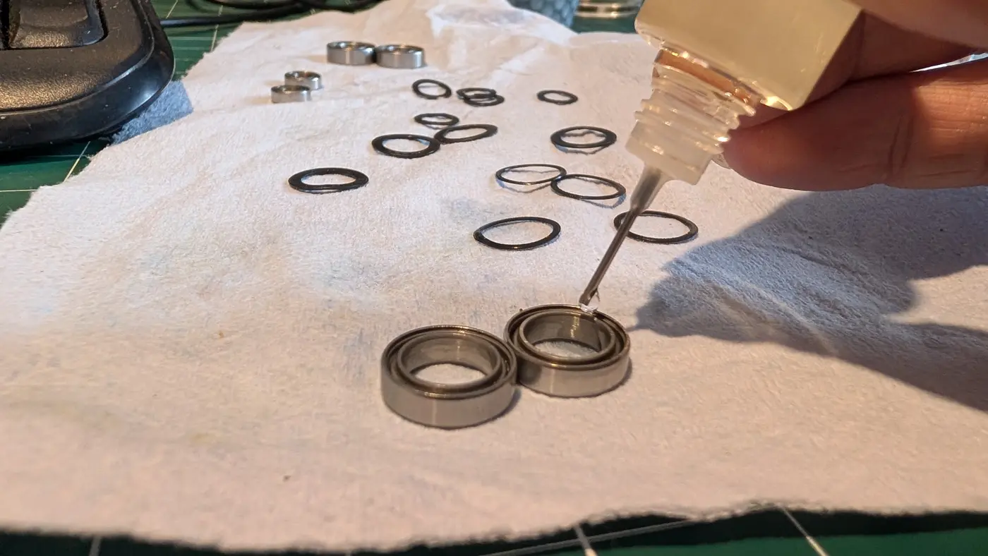

All 18 bearings had to be de-greased and re-lubed with ceramic bearing oil. Strategic seals were removed. Only those necessary were retained.

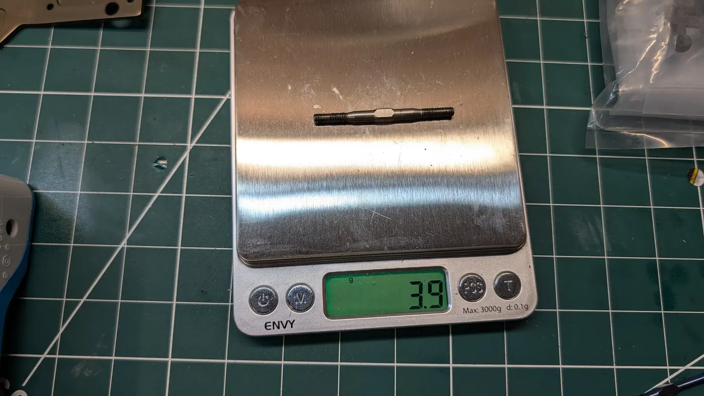

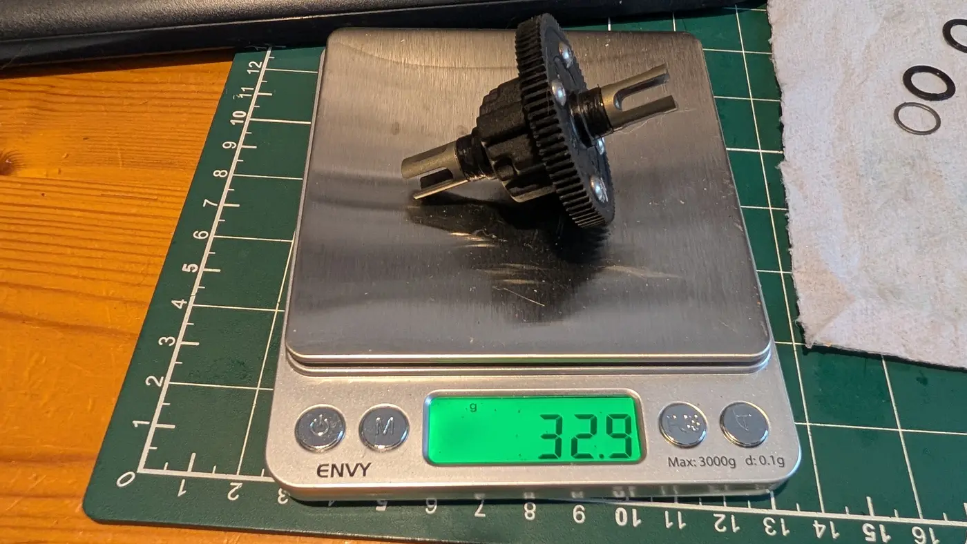

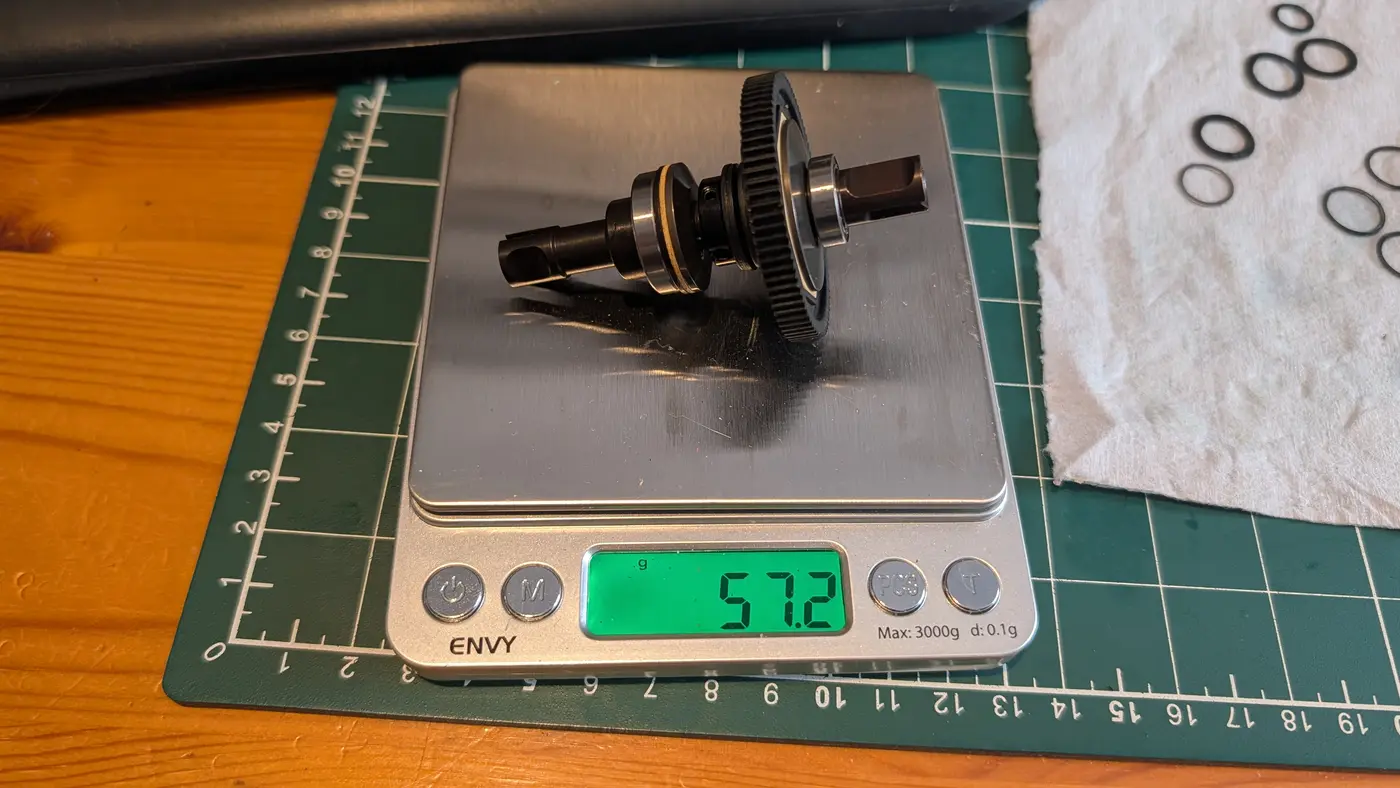

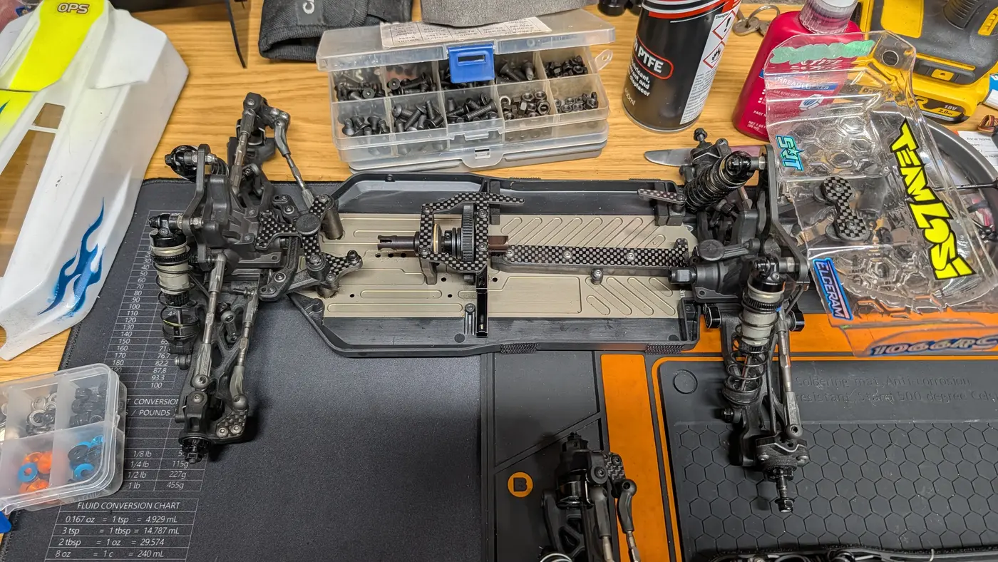

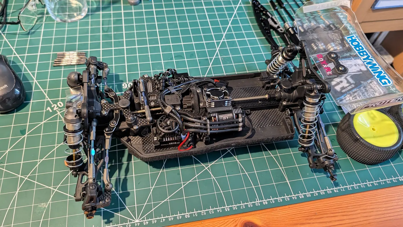

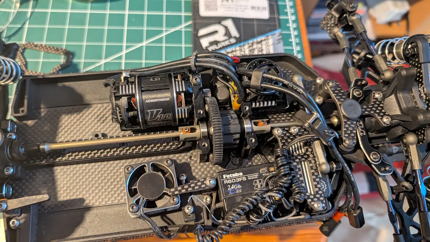

Bi-metallic lightened centre driveline saves about 12g of rotating mass, along with the diff saving a whopping total of 36.3g of rotating mass.
This rig is only limited by me as the driver. How fast can I get it to go? Can I win a third series with it?
Will racing 4WD impede my precise lines, and momentum-carrying MD24?
Let's find out!
So why did I stick to a 6mm shorter chassis?
Because: I'm used to the balance of the buggy and I enjoy the super aggressive handling. Whilst adding 6mm longer wheelbase - all at the rear of the chassis - moves the weight further forwards, you have a heavier, less responsive car with more weight over the front wheels.
Mine is much lighter, lower CoG, lighter transmission, thus violently quicker off the mark. I don't necessarily need my next buggy to be easier to drive - I just want it to carry more of my 4.5t motor's speed and momentum through turns, without grip rolling.
The lighter and stiffer the car is, the more likely I will be able to achieve my objectives.
