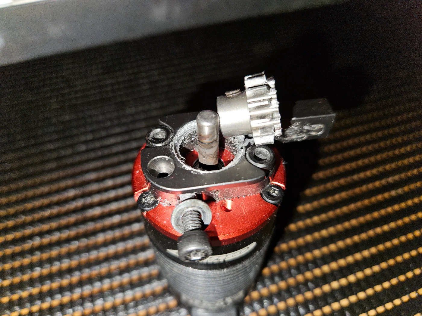

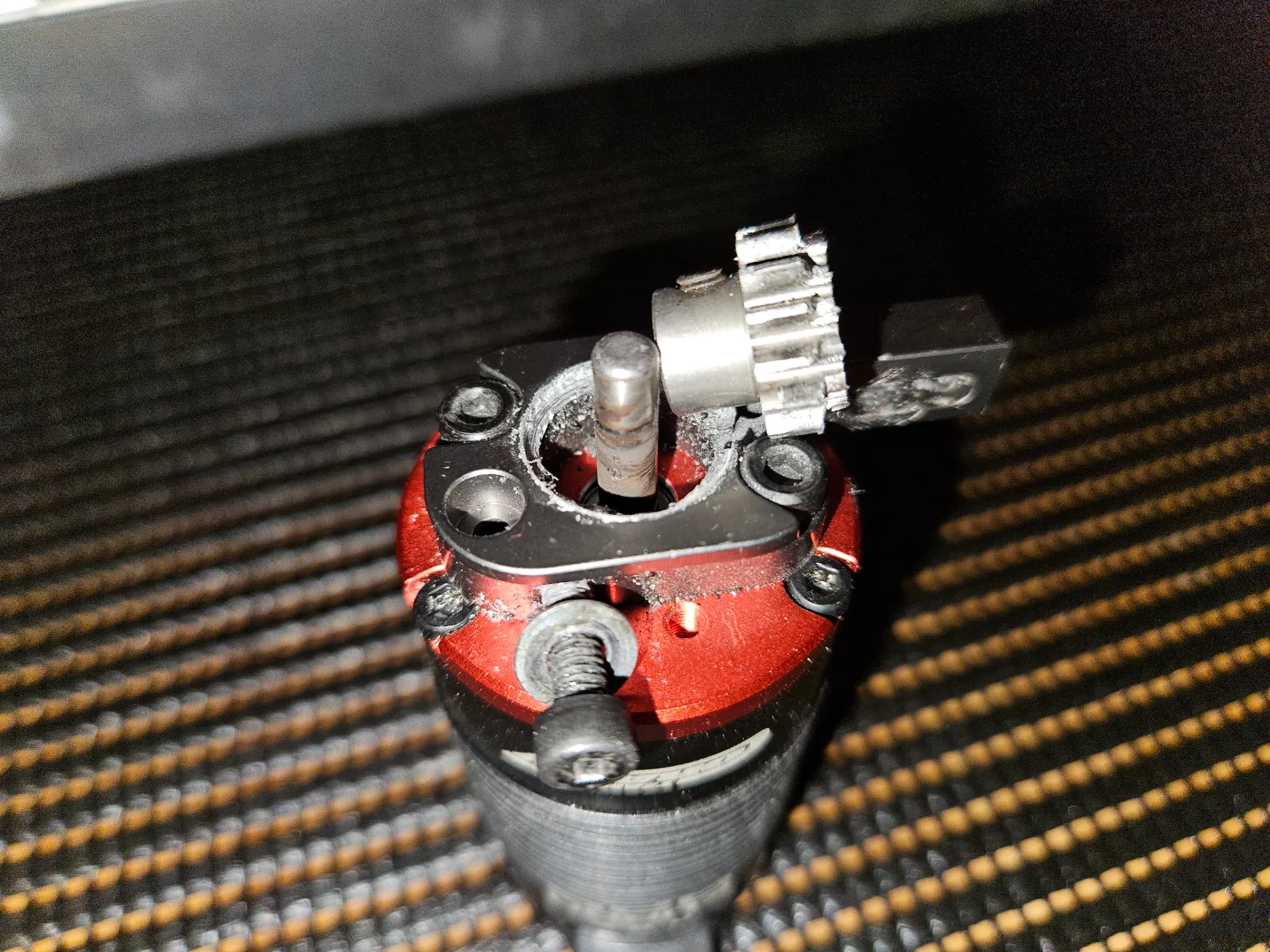

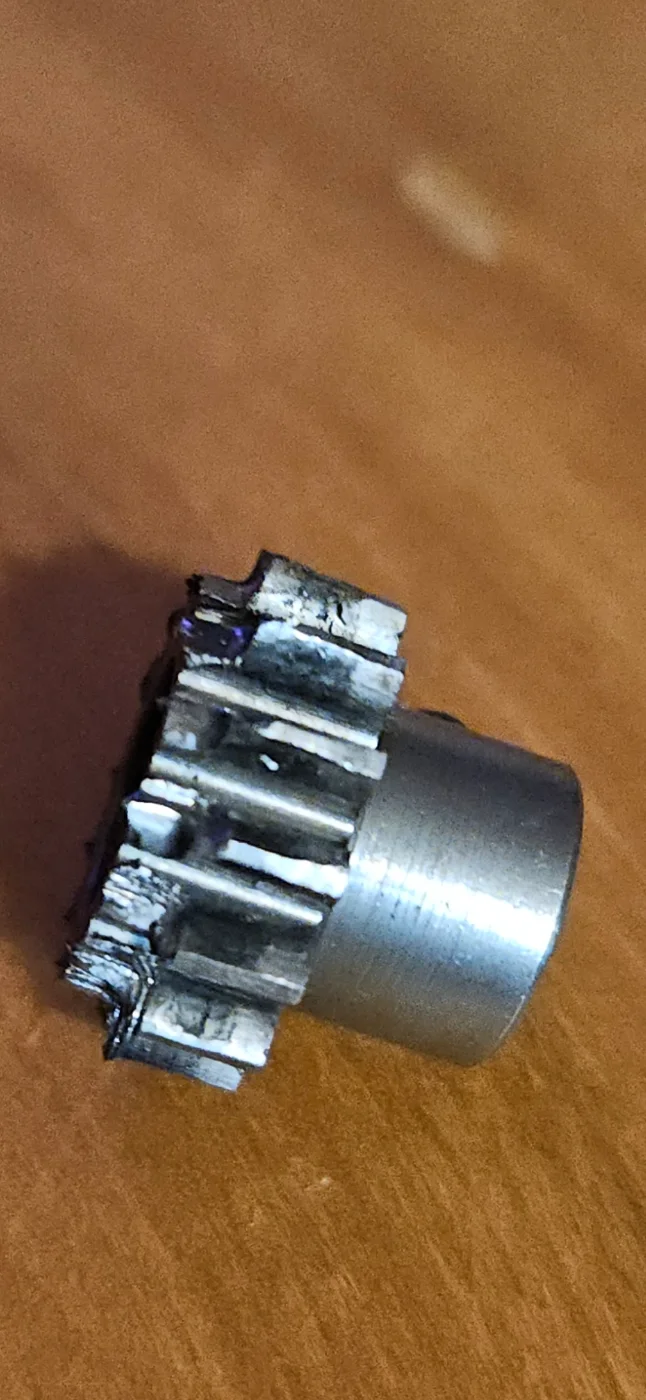

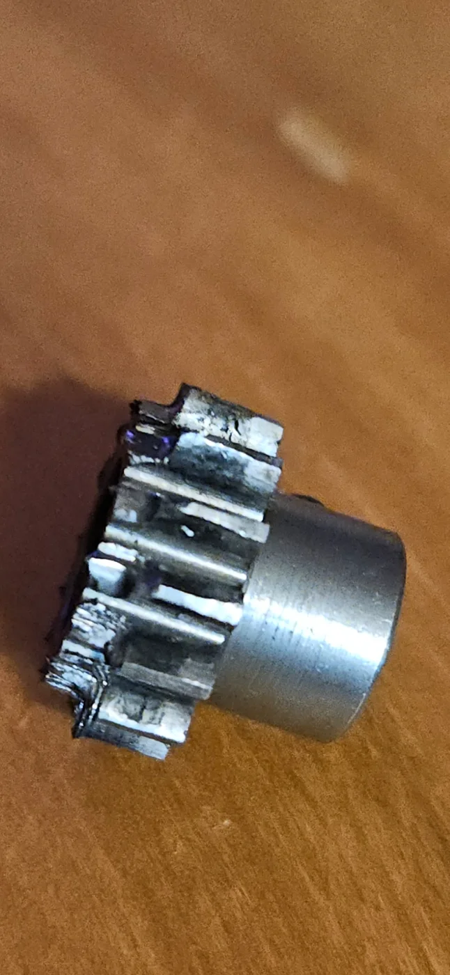

Kagama Haven't had this before🤣

looking for an easy fix to keep this from happening again....

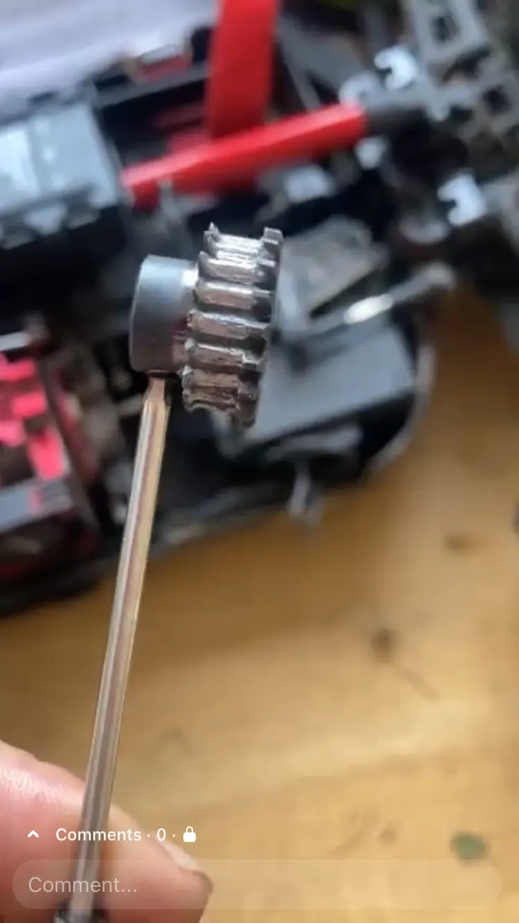

What kind of pinions are you running? I went with Amazon pinions for my Arrma 3S rigs and they were fine, but I had issues with cheap pinions when I moved up to 4S.
People on the boards recommended Robinson Racing and Tekno to me, since they use hardened steel (I believe). I went with RR and haven't had any issues, even running 6S. They're still pretty cheap, just a couple of bucks more than less expensive brands.

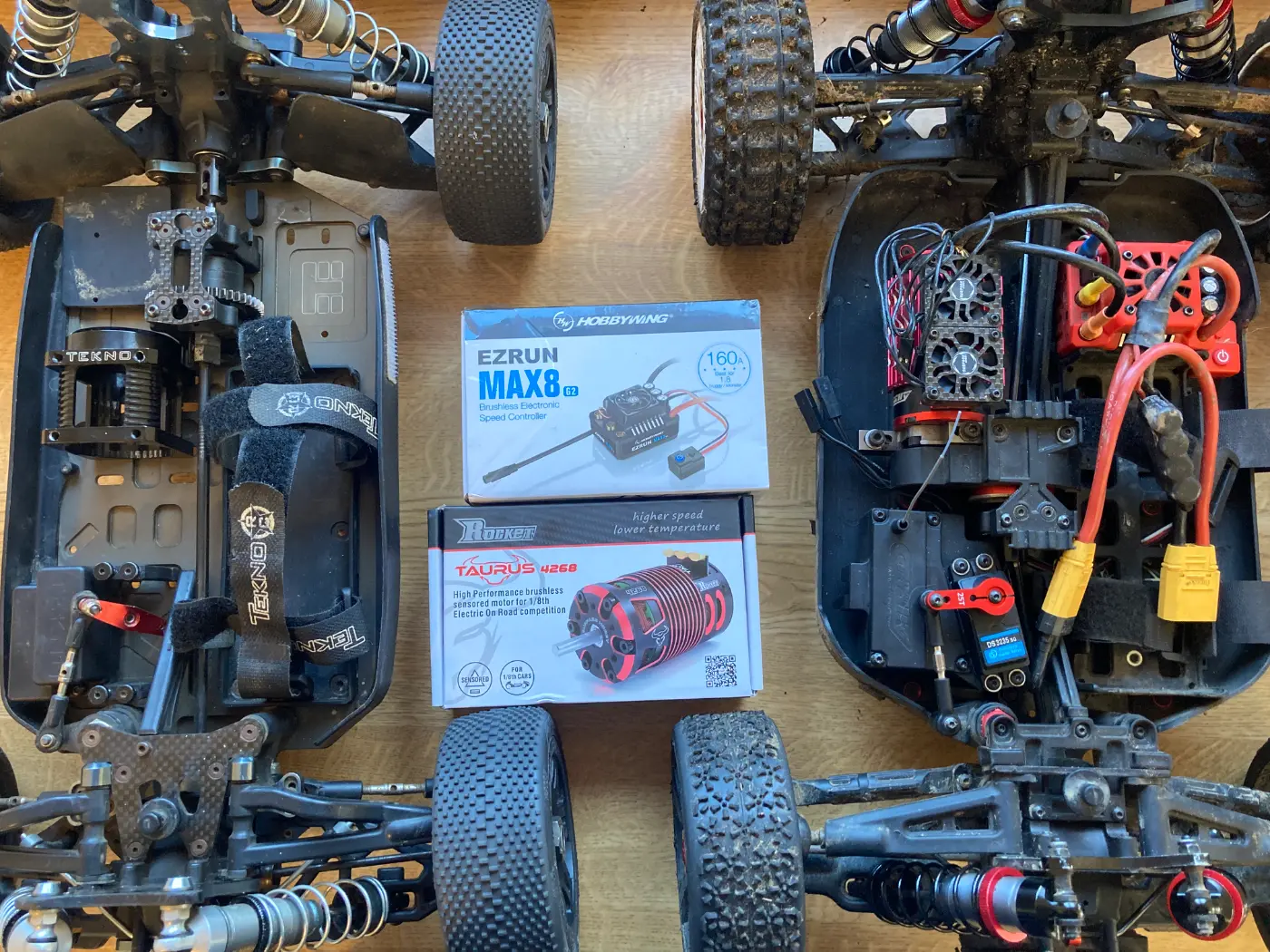

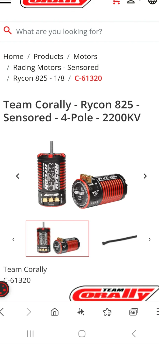

Ordered 1 of these....

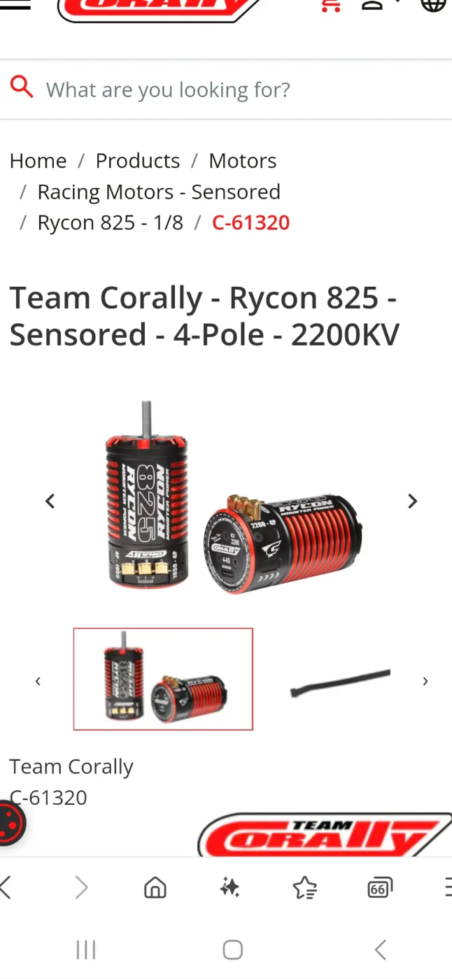

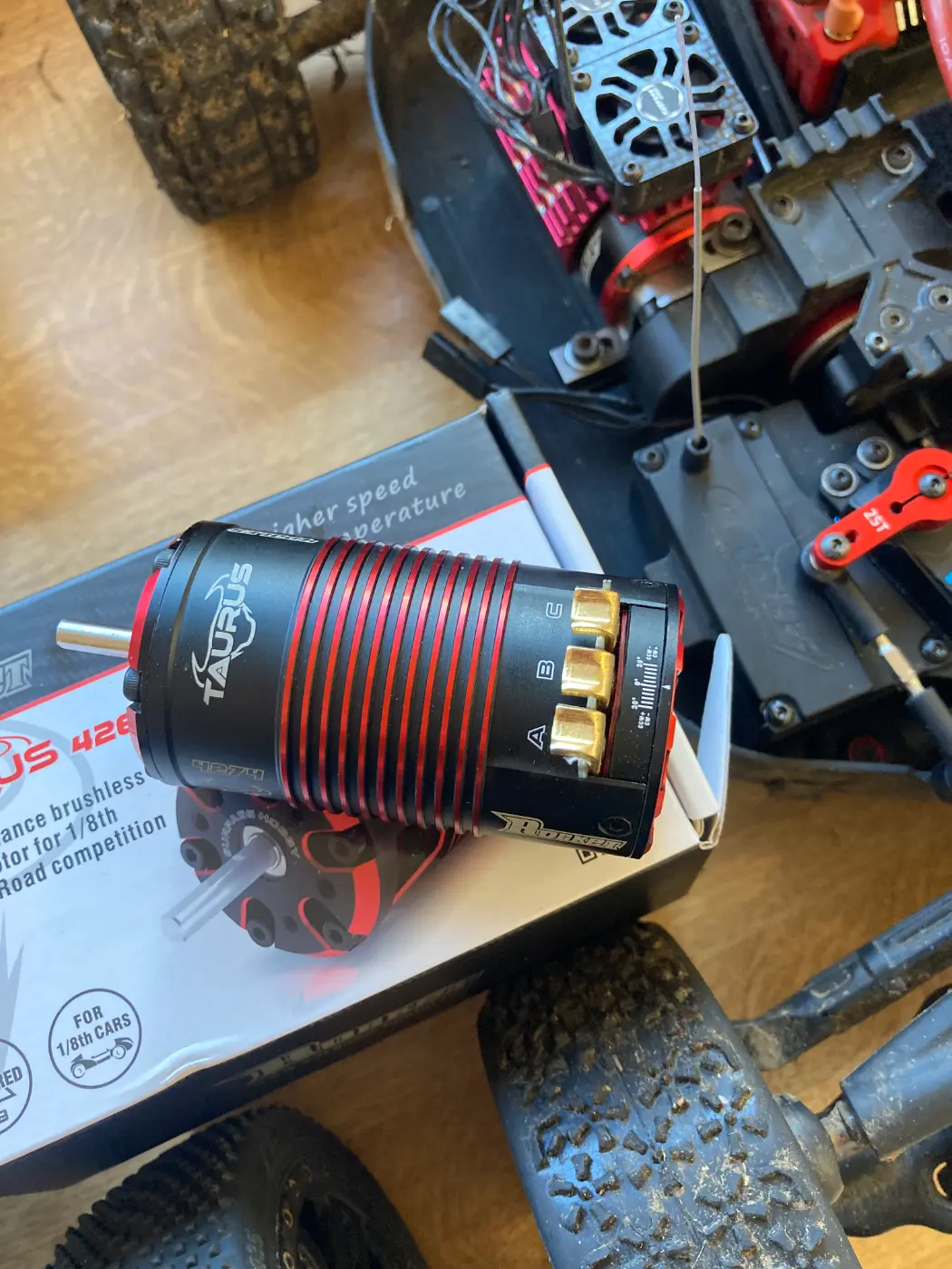

Always been curious on these motors and how they perform over the stock motor they look pretty nice if anything. Looks similar to rocket Taurus though I smoked that motor. I’ve chewed up pinions worse than that you in good company šŸ˜… but like others said need get good ones tekno, mugen, robinson racing, protek are good ones even the corally ones pretty good.
