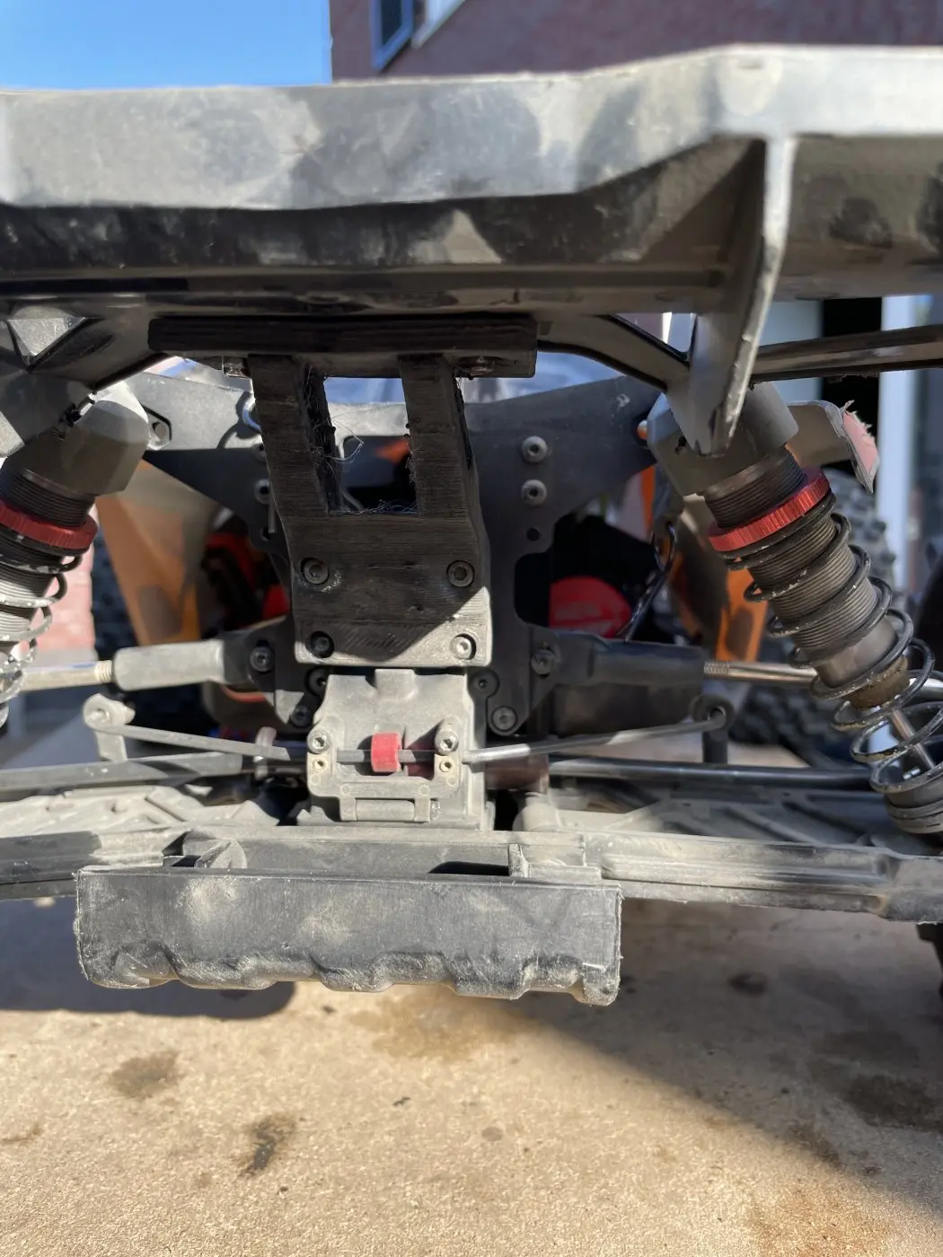

I know I mentioned this earlier somewhere else, but thought I share my review of this flexibele wing mount for the Kronos in a thread of its own.
It’s a wingmount you can print yourself. The files you need for that are free and can be found here https://www.thingiverse.com/thing:4630275/files.
Since I don’t have a 3D printer I found a printshop online that printed it for me for about 10 euro. The end result was a bit rough/ not nice and smooth finished everywhere but still ok. Once the mount is on the truck the rough edges are hardly noticeable.

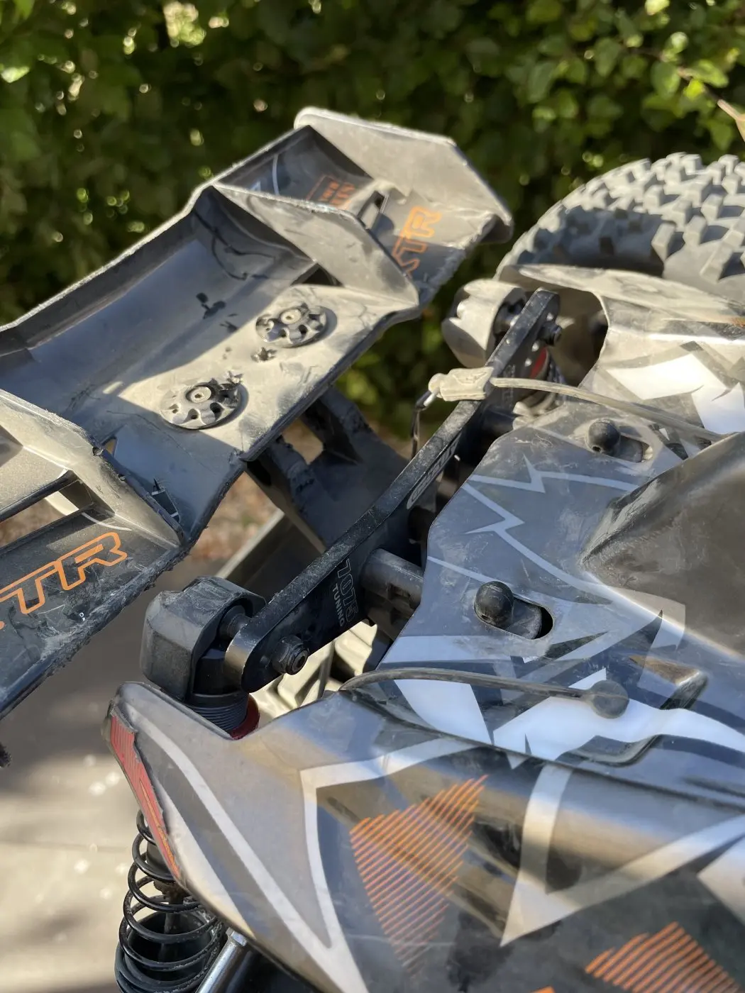

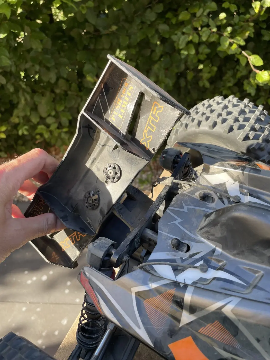

The mounting holes for the wing are a bit to close together for the wing to fit perfectly. Modded the holes in the wing a bit to make it work.
For mounting the wing I used the aluminium wing washers (C-00180-157). They hold up much better than the stock plate.

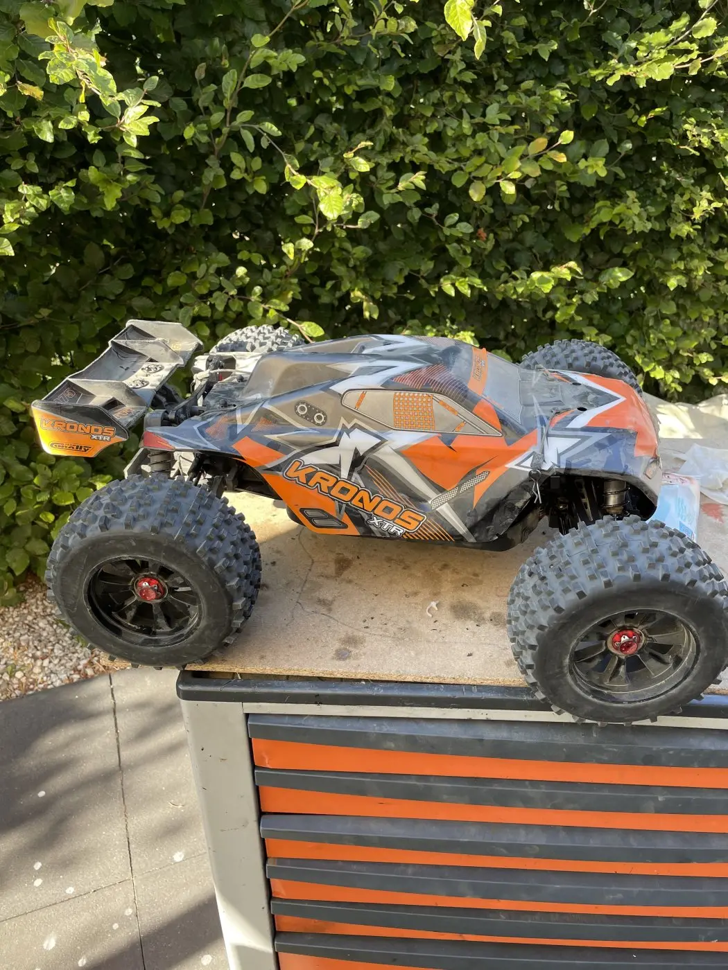

This is how it looks:
Im happy with the end result. With the original mount my wing broke off every run. In the two runs I did after I fitted this mount I haven’t experienced any problems. Too short to tell but this seems to be a good fix.
