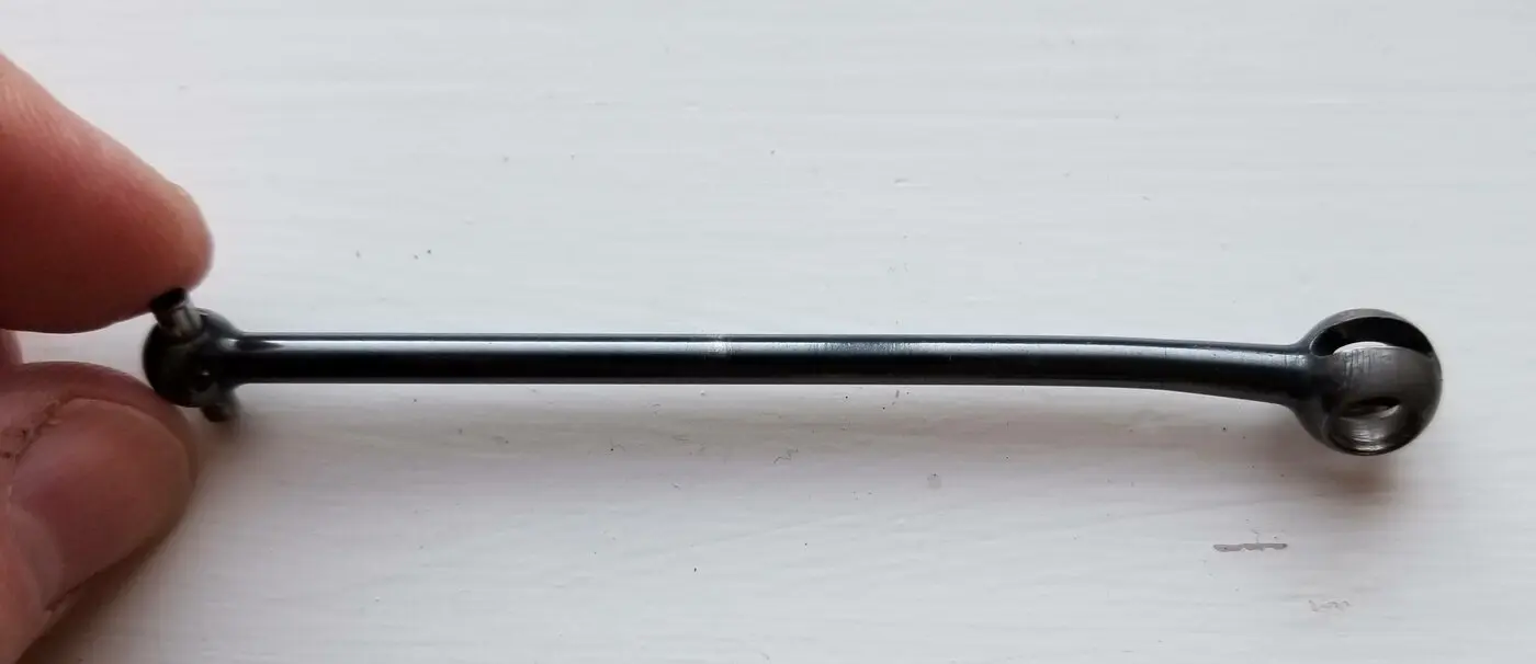

Suffered my first real Sketer breakage today following a bad landing from a moderate jump. I thought (hoped) that it was just a popped out hub, but nope, a bent axle shaft shaft...bummer! I've been impressed with durability so far having run about 20 packs without any problem (except that dumb front bumper).

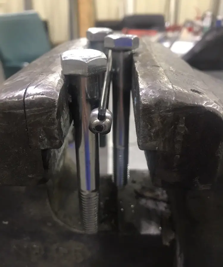

If you have 3 bolts and a vice that is an easy fix.
I've bent things back into shape in my vise before but usually doing so involved a hammer. This 3-bolt strategy looks a bit more precise. A new shaft is in the mail but I'll definitely try this out to keep a spare on hand. Thanks for the tip!
