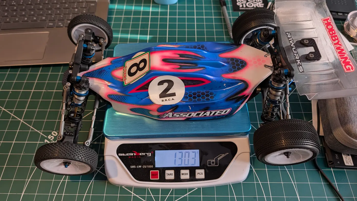

It's an interesting equation of power, weight and weight limit in sanctioned races. I like to get my cars as light as possible - then use 'useful' battery weight to make the legal minimum.
The nice thing - especially in 2WD - is being able to move the battery into a position that affords the best handling. On carpet, this is quite far forwards for maximum steering.
At the moment, I 'need' a battery that weighs a minimum of 171g. With the next round of modifications, I'll likely need a battery that weighs a minimum of 199g - which (funnily enough) fits the weight profile of my Redline 5300 packs.
I'm already hearing noises from certain people that my 2WD buggy is 'cheating'. 😝
The thing is, my buggy is about to get even lighter again - lighter gearbox, lighter arms, a load more titanium.

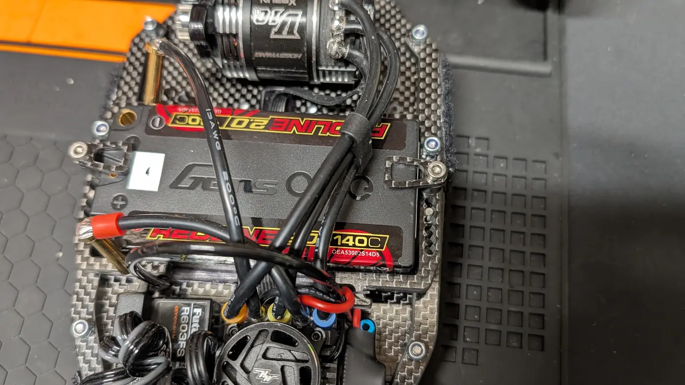

Before that happens - voltage under load - will need to be established. Or to put it another way - a drone pack being able to discharge 140A seems impressive enough, but the 140C Redline 2S Shorty packs I race with are theoretically able to provide 742 amps continuously!! 🤯

140C 2S HV Lipo are legal and deliver more beanz.
A 5300, 140C 2S Lipo can deliver 742A continuously (in theory) and have a higher voltage. (My 2S cells were peaking at 8.9V Vs JP40 2S1P configuration 8.4V).
JP30 - in 2S1P configuration can deliver upto 52A continuously.
