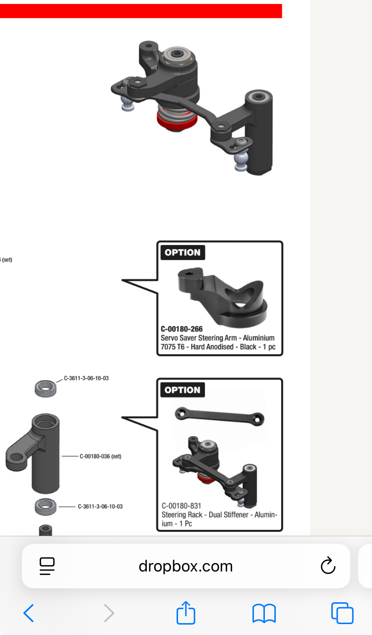

There is a additional stiffener you can add
