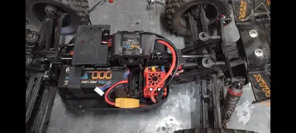

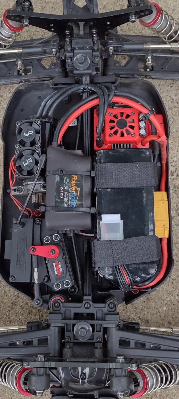

If you have the equipment and know how to solder it opens the doors a lot for batteries, finding batteries with xt90 plugs is a bit more limited, I buy whatever and just solder an xt90 on. Personally I'm a fan of running a single battery vs a pair whenever I can. The battery pictured below is an awanfi 5000mah and it fits the radix if you trim the side of battery tray, has to lay flat otherwise it's too tall for the body. Runtimes will vary obviously but most rc's on around 5000mah will yield you in the ballpark of 15 minutes runtime. And as far as "waterproof" goes, I don't trust any manufacturer when it comes to that short of hitting a puddle, I never have and never will take a garden hose to an rc with the electronics on board but that's just me.
Also that awanfi is 138mm long. Not sure exactly what zeee you're looking at but the few I've had were longer batteries and I doubt they'll fit the radix tray.
Powerhobby 5000mah/100c hardcase in my xtr, bigger overall tray than the radix but I'm in the small setting of the tray so that part measures the same

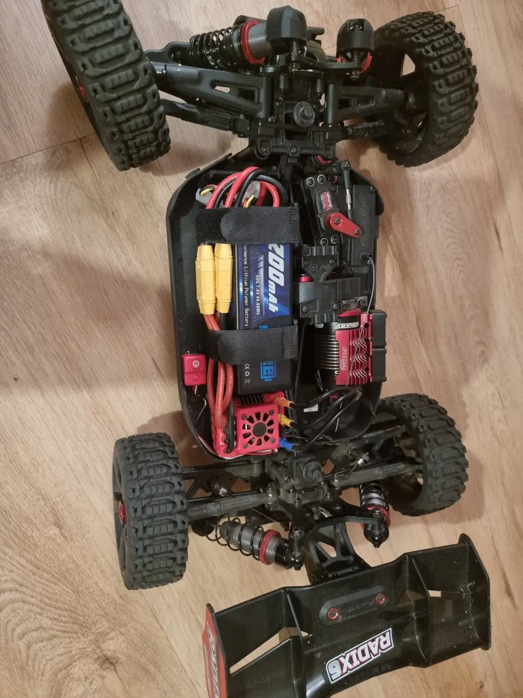

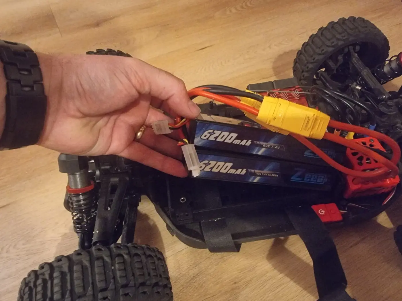

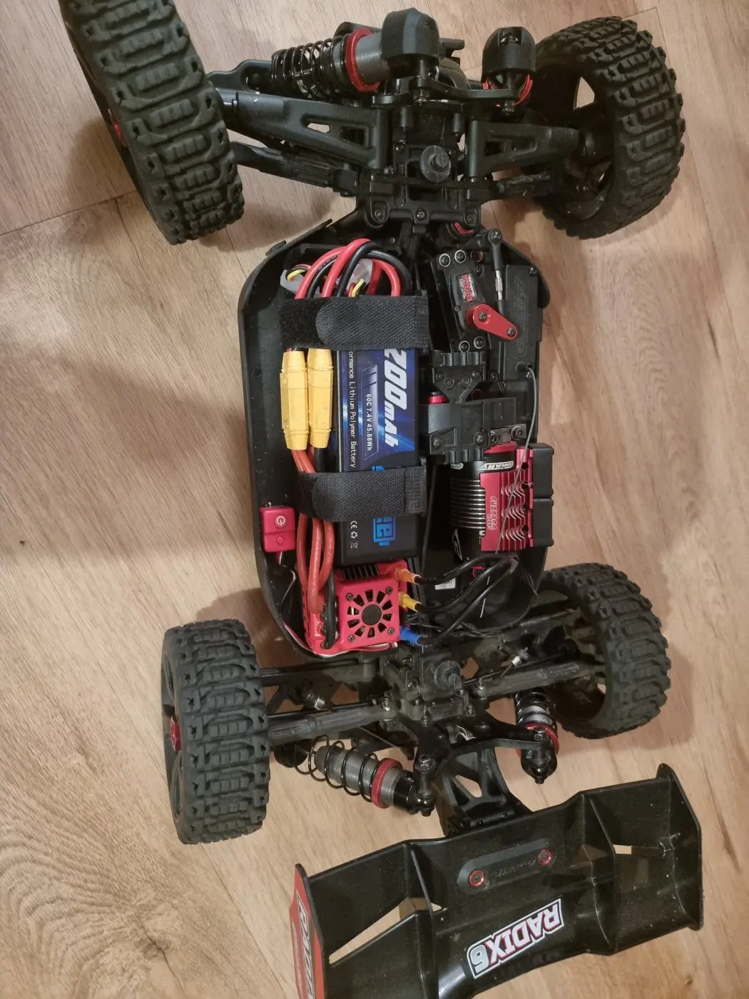

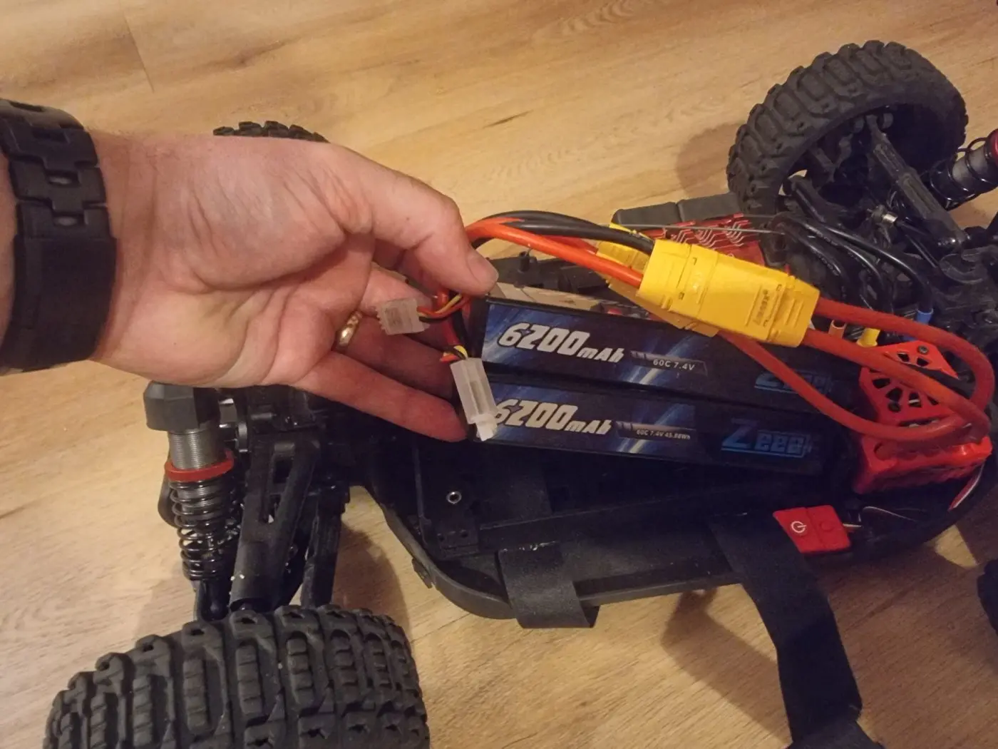

Here is my radix with the v2 battery tray and two 6200mah zee batteries. Fit really comfortably just as an FYI. These batteries came with deans connectors but I changed all my kit over to XT90 connectors.
Here is the v1 battery tray with 2 5200mah zee batteries in it, they do fit easily albeit with not alot of spare space. The 6200mah also fit comfortably as the difference in battery size is not that big. My experience with the hardcase zee batteries so far has been really good. I would also recommend the Sky rc d100 charger as it has storage mode, and can charge two batteries at once. Also has a Bluetooth app to look at battery stats whilst they are connected to the charger.
Here is a quick comparison of the v1 and v2 battery trays.

Thank you for your efforts with this post very helpful! Looks like a brilliant setup.
Have you used a 6s battery yet?
Yes mate, the car came with 2 3s 5000mah batteries, but to be honest I find it too much of a handful on 6s. I use the 3s batteries in my Team Associated Rival MT10 and bought the zee 2s batteries in the pictures off amazon and run the Radix on 4s
