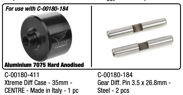

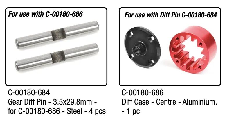

I just wanted to bring this to everyones attention before we all go modding crazy..!! The cross pins inside the casing are different between the red alloy case and the 7075 version..!! ( The pins # C-00180-684 also fit the composite diff housings # C-00180-090-2 )
I'll let the pics from the manual do the explaining ..
To my knowledge all the gears and shim washers are the same across the range..
Corally's website seems very good at matching the correct parts automatically I searched for the pins and it brought up the correct case..!!
Click here, https://www.corally.com/Car-Parts-T...ard-Anodised-Black-Center-Made-in-Italy-1-pc/ .. then choose accessories and you'll see what I mean.
