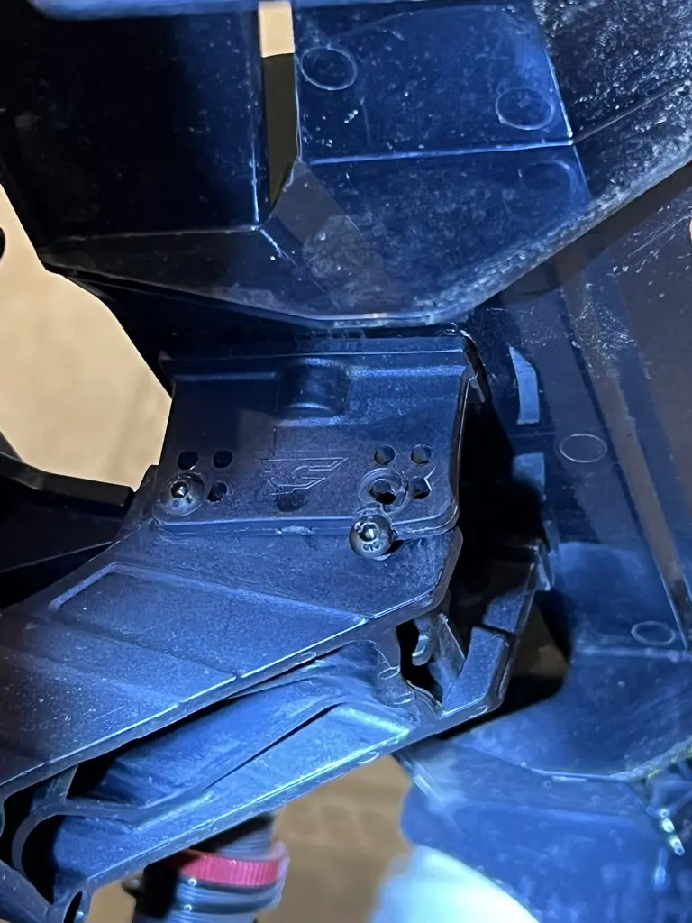

Well the first prototype is a split design to allow it to have more flexibility. The top brace to connect to the tower is gone and the wing mount parts art all gone. Wing is going to get a screw and capture nut to prevent the wing from just popping off and the mount itself is going to flex and move to absorb impact, save the wing/tower and bulkhead from impacts and best of all. It’s designed to save you money and headache I would expect a final in the next week or two then the testers beat them up for a couple months just to make sure it lives up to its name.For more data... Here's what I am breaking on my Kronos wing mounts. The wing support assy is strong but the plates that bolt up and hold the wing keep ripping out.
View attachment 898View attachment 899
are you going to print this in TPU? I am very interested ion how this comes togetherWell the first prototype is a split design to allow it to have more flexibility.
It’s a tri blend I have custom mixed for me. Pctpeny is what it actually is.are you going to print this in TPU? I am very interested ion how this comes together
Thank you sir. That’s what we do is figure out how to keep people rolling longer without breakdownsdude, that is awesome.
