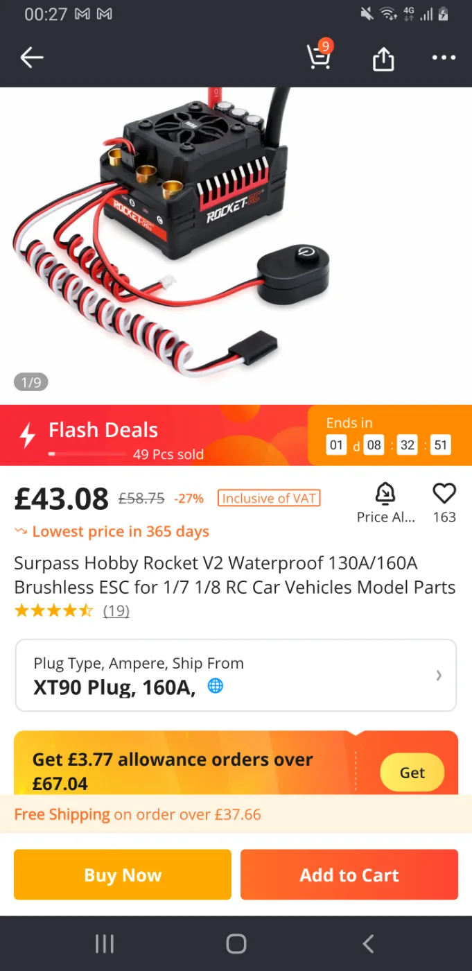

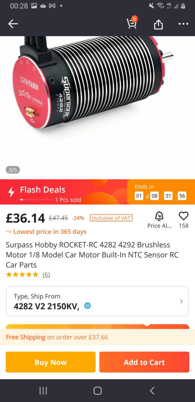

Hi, I've unfortunately burned out my Shogun's Torox 185 ESC, so I'm looking for a new combo. I'd like to get a Surpass Rocket ESC and motor, specifically a 1600kV motor and a 160A ESC. Since the kV is low, I'd use a 21- or 23-tooth pinion gear for good speed, acceleration, and torque. What do you think? Does anyone have this combo?View attachment 9857

Whilst changing the mount will facilitate the use of larger pinions, with a 2000kv 4274 motor, you won't be able to use anything close to 21/46 gearing without the ESC cutting out, or the motor overheating rapidly.
Even with a physically bigger motor - like a 4292 Rocket motor - gearing up increases the top speed up to the limit of the motor's power.
Given equal winds:
Larger diameter motors generally develop more torque, due to the magnetic forces increased moment arc.
Longer motors generally are able to rev higher and produce more overall power.
So for pulling higher gearing, you need physically bigger motors, with bigger ESC's that can deliver the extra current required.
It is also assumed that batteries being used have the correct C rating to provide what the system is drawing from them.
The 160 amp Torox ESC is good to power the Shogun into the mid 60's with a Kuron 825 motor. With larger after market motors, you may eek out into the low 70's with the right motor - the limitations being the 160 amp Torox ESC.
For the avoidance of doubt - 70 mph is insanity level fast on a Truggy! Whilst we casually talk about 60+ mph on an MT basher truck, it's no joke attempting these kind of speeds, especially on unbelted tyres.
