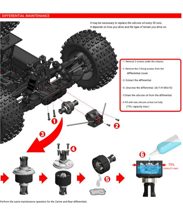

I've openend up my front diff case lots of times already, but I was just looking in the manual and saw this. I've tried it this way, but can never get the diff case out. It is always blocked by the hinge pin holder. To remove that I need to remove 4 more screws, the skid plate and the hinge pin holder ones.
Is it possible this way or is the manual stupid? What am I possibly doing wrong?
It would certainly make it less off a hassle to check the diff.
