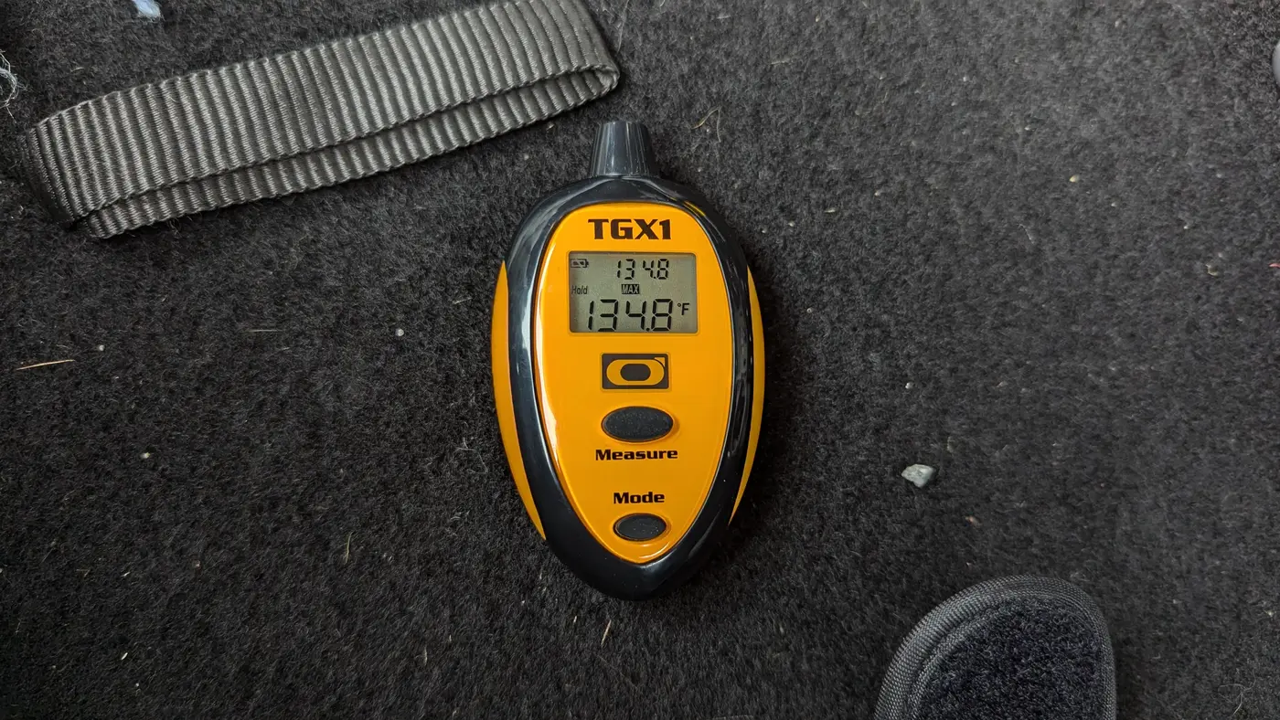

Ran it last night real quick with the replacement HW motor. Again it was down 1 tooth on the pinion to 12T and dropped the punch from 5 (stock) to 3. Just dong ramp jumps and flips putzing around the motor only got up to 120F. Tonight I did 2 partial packs (about 30+ minutes) of jump session and the motor again was pretty cool, maybe 140F.
160°F is where you start thinking 'Hot'.

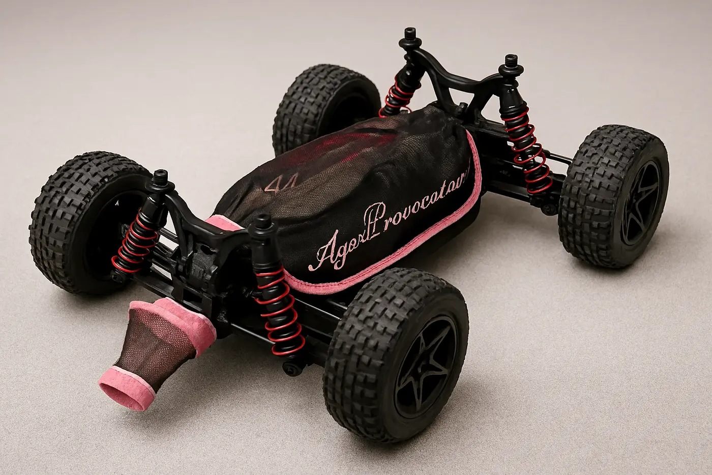

The reason I am not crazy about chassis net is because I ran one on my Traxxas Maxx Slash and I could not keep the temps down. I stopped running the chassis net and I can still get 100+ runs out of the stock motor no problem. My fans have mesh screen over them and I brush them off between runs or halfway through a run if I'm in a bunch of debris.

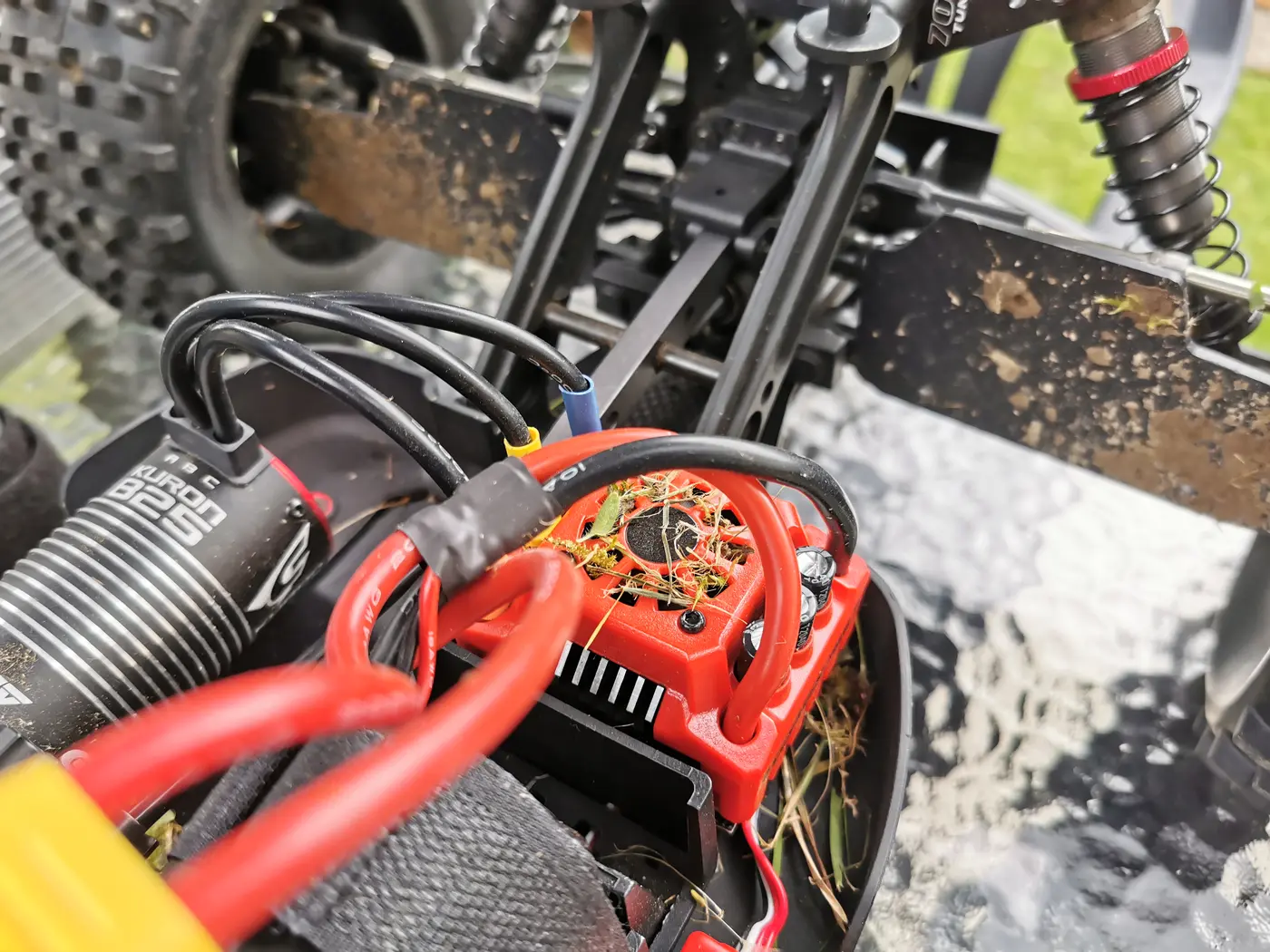

I checked my XTR during the first few runs and this was happening:
The ESC was at risk of overheating.
The motor was breezing past 190° and I wondered if the motor was getting hot
So fans and shroud it was.
The other issue it prevents is chippings gouging away at your rotating parts.

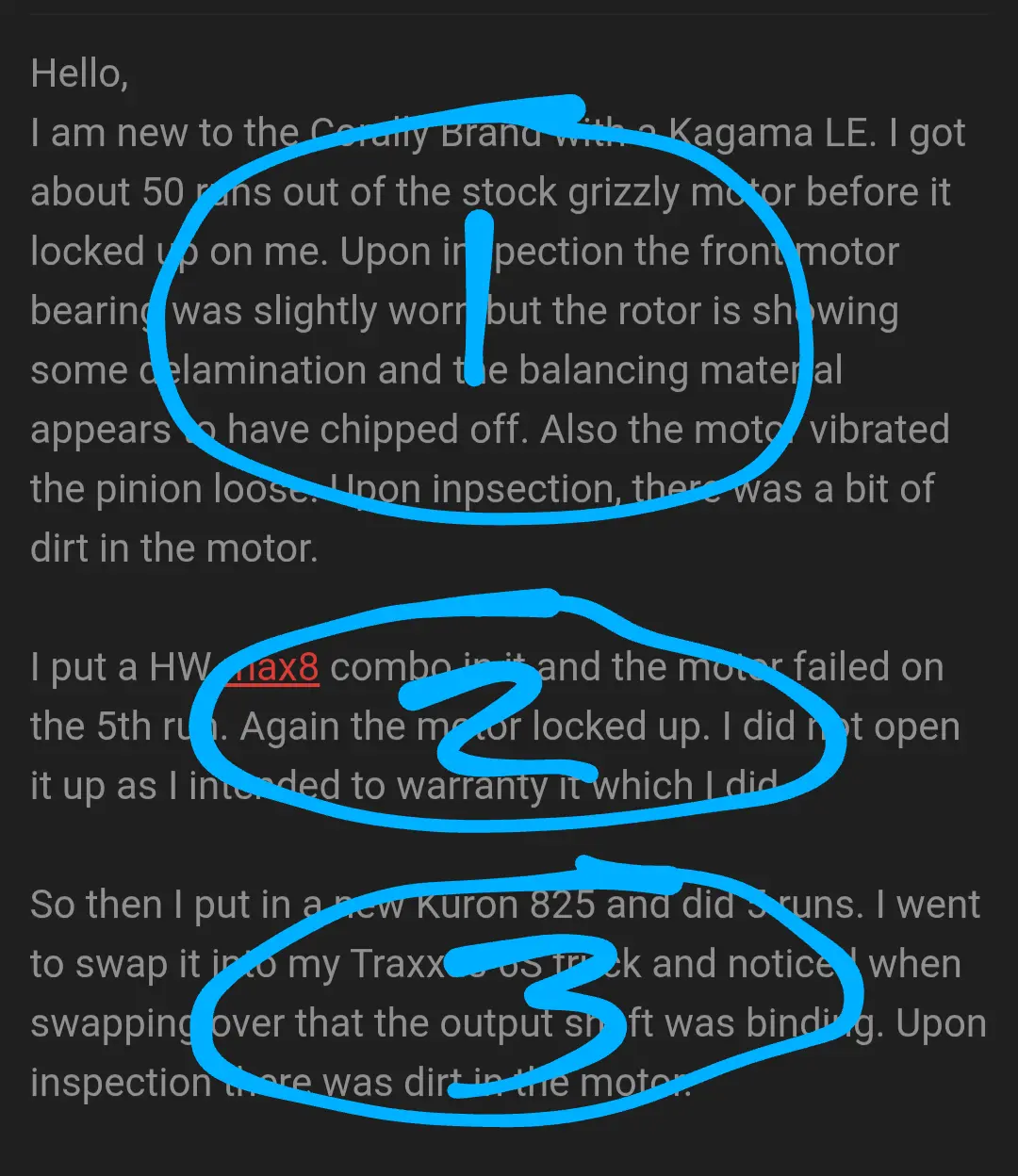

Ultimately, keeping temps down depends on several variables. Fans being operational is perhaps the main thing. However, even this won't mitigate poor throttle management, over-gearing, drivetrain bind, bearing failures, too high a punch setting, insufficient time between runs to cool down - etc etc.
It is still entirely possible that there was a bearing failure in the motor, but to have 3 different motors fail like that....
- in the balance of probability, it's an operational failing.

Shrouds are like marmite to people. Another forum user over on Arrma managed to set fire to his on the rig. Really!
To be clear, I've never used them on anything until the XTR from about 2022 onwards. Now I use them on my Sworkz S35 T2E, mainly to protect the chassis from damage, rather than keep my sensored Castle 1515 from over heating, which it simply never does on the MMX.

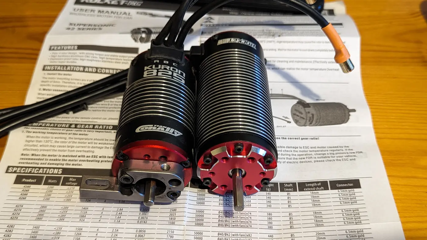

As for the Kuron 825, it's a notoriously 'hot' motor. It's rapid for it's size and punching well above it's weight. But it gets hot.
For general hooning around though, a motor with more volume and torque - greater overall power - like this cheap as chips 1780 KV 4292.
This motor is much less prone to getting hot and opens up more gearing options for speed runs. It's also more useable and feels punchier for general driving.
